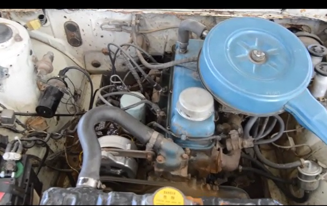

voesredat Posted July 7, 2025 Report Posted July 7, 2025 Hey guys, i have been fixing an old 1978 mexican 610 with a 3 speed auto and its slow it only goes like 80 kmph (50mph) and i wanted to know if there are some tips to get them faster or parts that wear out a lot that could affect my vehicles preformance I have also been trying to get an audio system but i dont want to remove my cool looking am radio so i am going to Install a bluetooth amp and hide under the dash but i dont know how to remove the dash if anyone had some clues and what size is the speaker in the dash Quote

voesredat Posted July 11, 2025 Author Report Posted July 11, 2025 here it is and the ad is exactly the same model 100% 1 Quote
datzenmike Posted July 12, 2025 Report Posted July 12, 2025 4 hours ago, voesredat said: here it is and the ad is exactly the same model 100% Looks like a 4 door 710 J series. For a mid '7s car I would expect J15 or J16 size. Quote
ggzilla Posted July 12, 2025 Report Posted July 12, 2025 agreed, that's a Datsun 710 The encyclopedia says: "All Mexican 710 Violets featured the 1.6-litre carbureted engine (160J)" and the photo is of a J-series engine J13 from Datsun 510 should go 135 kph J16 OHV should go 145 kph L16 OHC will go 150 kph So ... tune the engine. Which means: 1. adjust valves 2. set timing 3. set points dwell Quote
