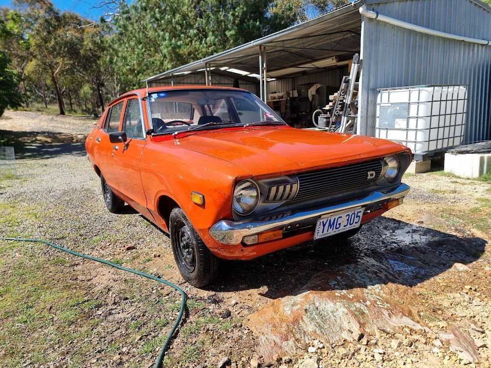

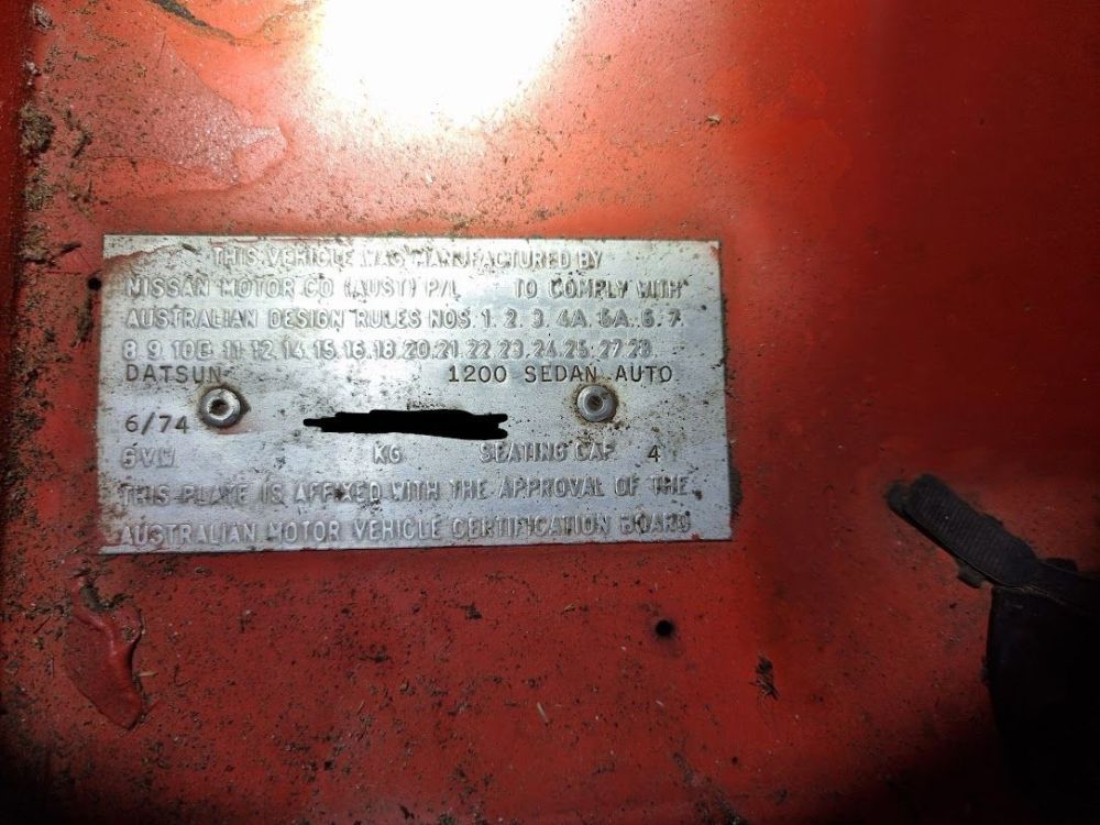

ggzilla Posted August 30, 2025 Report Posted August 30, 2025 (edited) 8 hours ago, redterror74 said: Fab looking B210. Love the shark's gill grille, we never got that in North America can you post of pic of the compliance plate and build plate? Looks like an Australia-assembled 120Y (by Nissan Pty. ). Oh, and Colour No. plate 8 hours ago, redterror74 said: Edited August 30, 2025 by ggzilla Quote
datzenmike Posted August 30, 2025 Report Posted August 30, 2025 I had a '76 and never warmed to the grill looks. Quote

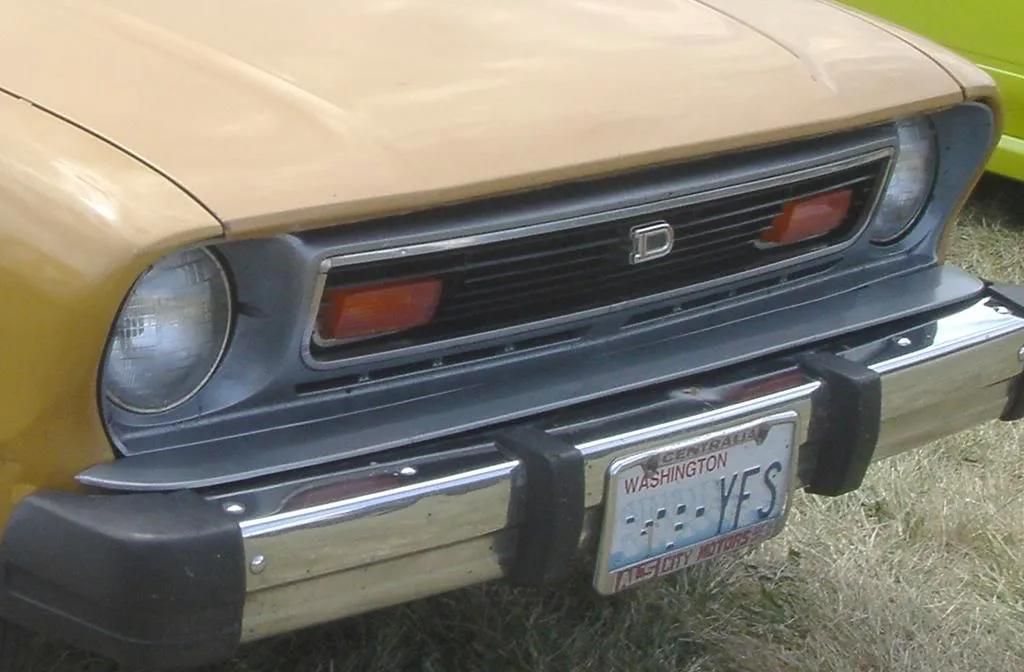

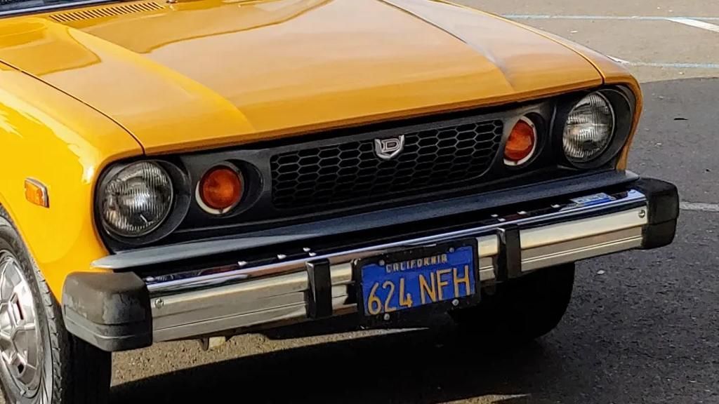

ggzilla Posted August 30, 2025 Report Posted August 30, 2025 1 minute ago, datzenmike said: I had a '76 and never warmed to the grill looks. North America early sedans and fastbacks both used the JDM Coupe grille: The early grilles had character, unlike the boring 1977-1978 grille Quote

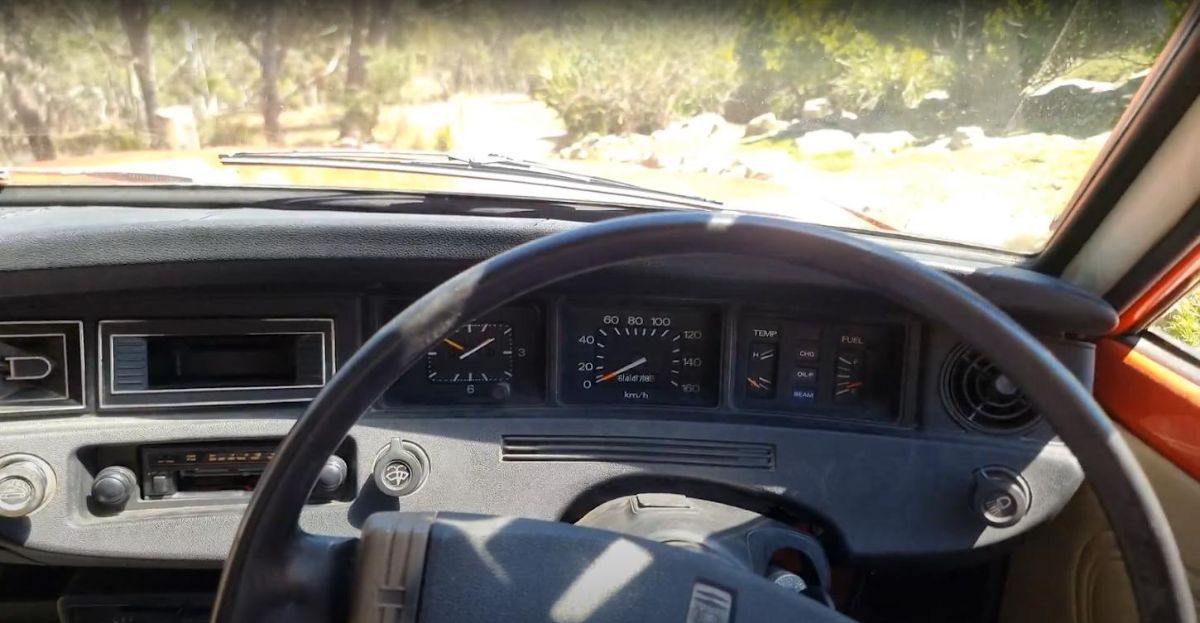

ggzilla Posted August 30, 2025 Report Posted August 30, 2025 1970's high style dashboard has a lot of character too. AM/FM cassette stereo too 8 hours ago, redterror74 said: 6,4478km Quote

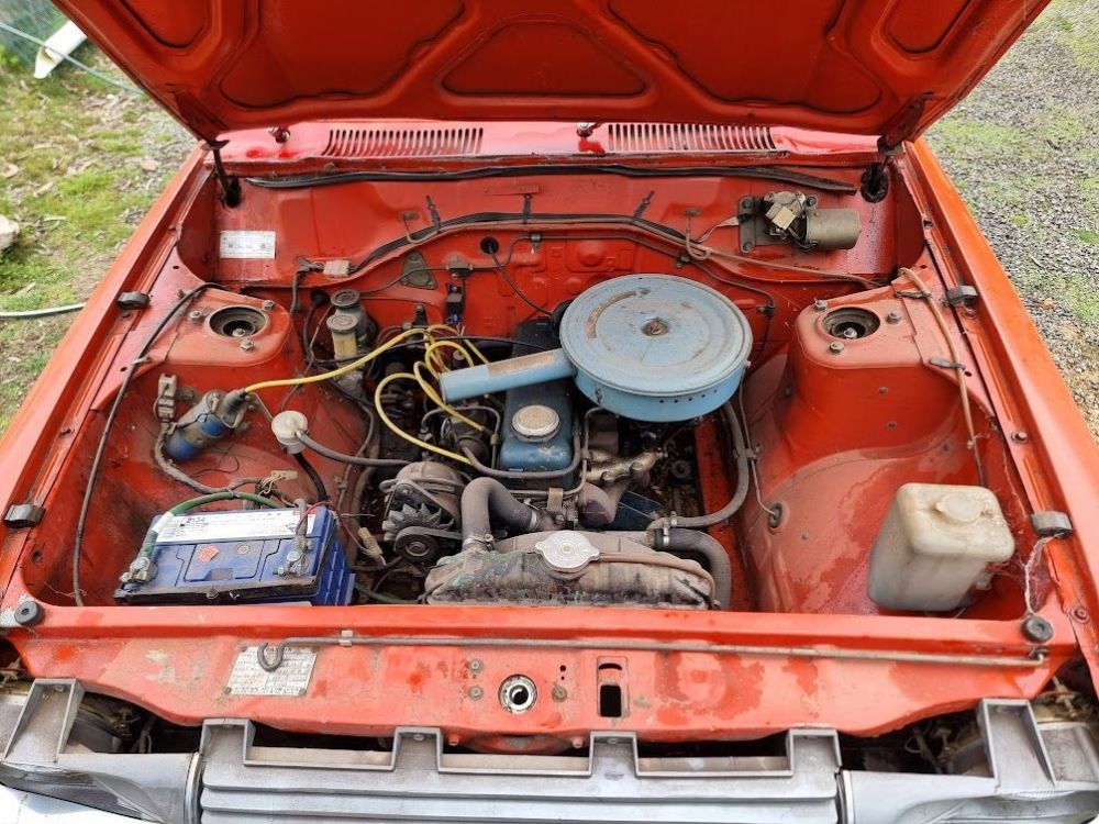

redterror74 Posted August 31, 2025 Author Report Posted August 31, 2025 After a couple more months research, I'm now looking at rotaries. There's a place up in QLD that do rotary imports and rebuilds. Going through them might be a lot safer than buying an sr20 off marketplace that could be a dud. Not sure which would be easier. Just a thought. 13b carby vs sr20det... (Edit) Then there's also the option of just restoring it. Since It's got stuff all kms on it. The engine is... ok. It runs but will stall if you give it a bit too much juice, and vibrates the car like crazy. It's also the quietest engine I've ever heard. Almost too quiet. Either way in the mean time, while I save up some money, I'm going to try get the engine running a bit smoother. My first victim being the carby Quote

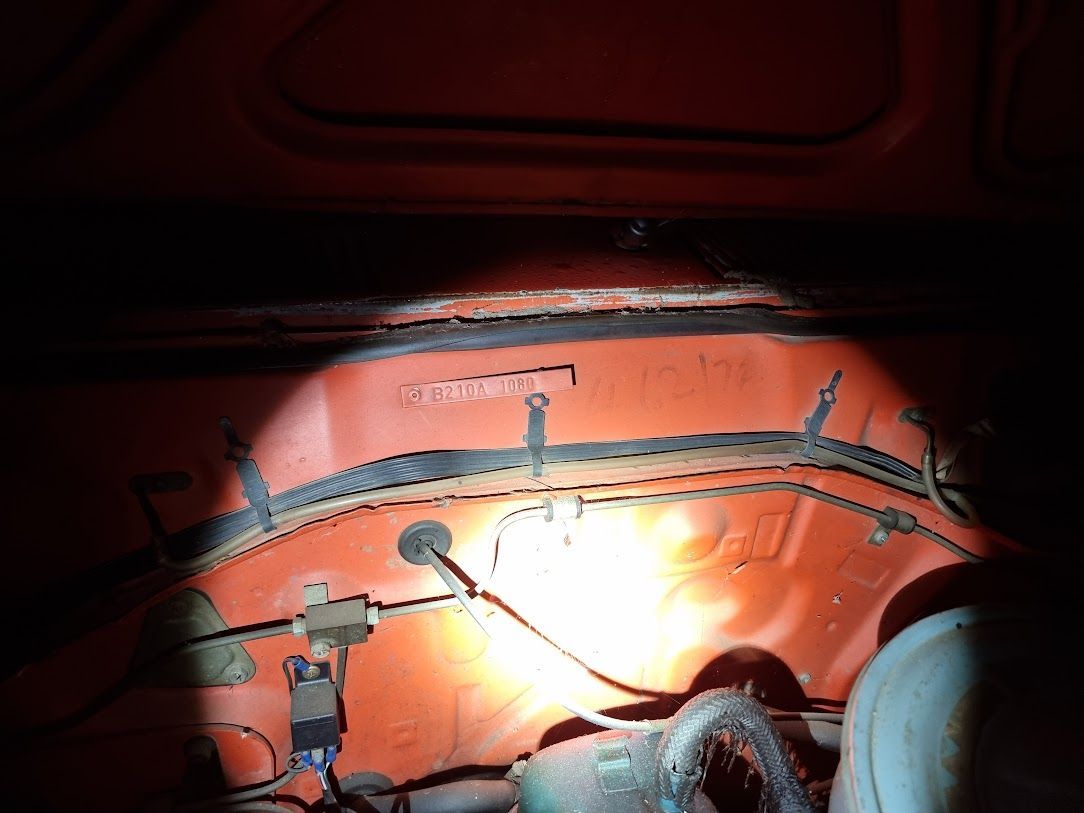

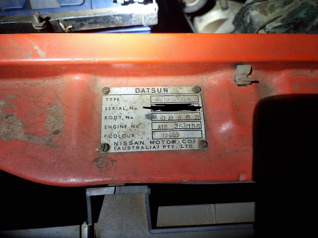

ggzilla Posted August 31, 2025 Report Posted August 31, 2025 (edited) wow, that looks like a factory stamp "B120A" and is that a period chalk marking? Never seen either on a Datsun before 35 minutes ago, redterror74 said: Paint Colour 15805 is "Citrus Red" from the Clayton factory B210-SAXUW meaning B210 Standard Automatic. And U usually means Export if that applies to CKD or local assembly. Dunno what X or W means 37 minutes ago, redterror74 said: Australian made Met the latest ADRs including 23 (1974 tyres), 27 (1974 emissions) and 28 (1974 noise control). The Japan cars were so quiet , you could not hear them run at idle. I wonder if the Australia-source exhaust were that quiet? 37 minutes ago, redterror74 said: Edited August 31, 2025 by ggzilla Quote
