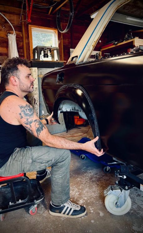

Photo dump:  Cleaned out the driver's side.
Finally found my first bit of cancer.  It's not bad.  Just a couple of extra holes back there.  Not sure how much I'll do to fix it.

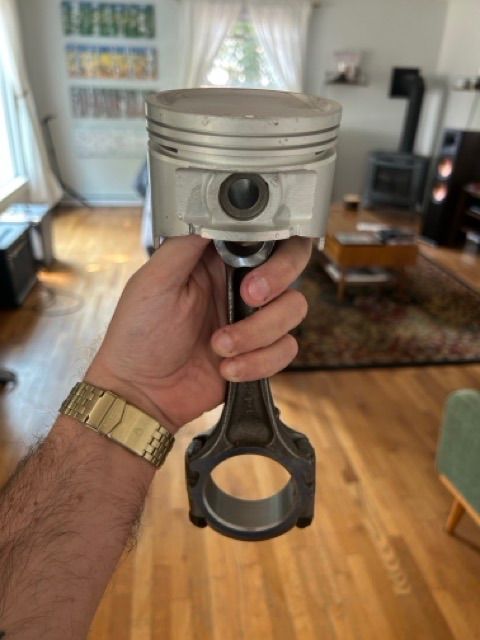

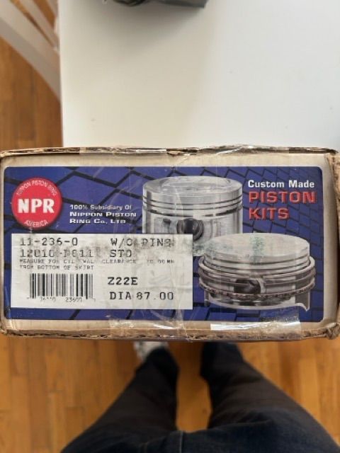

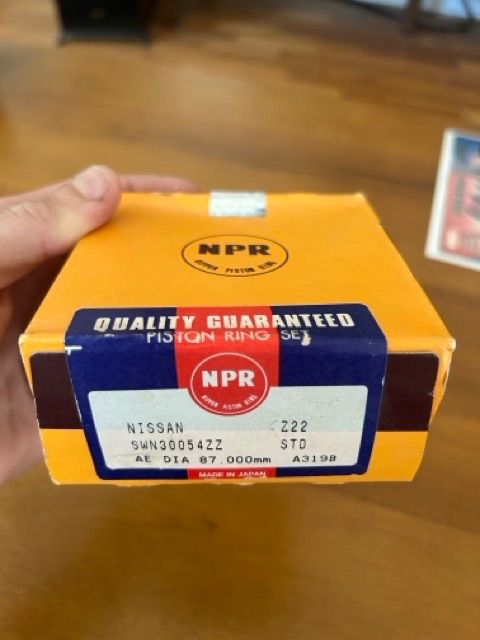

And a shipment arrived...
