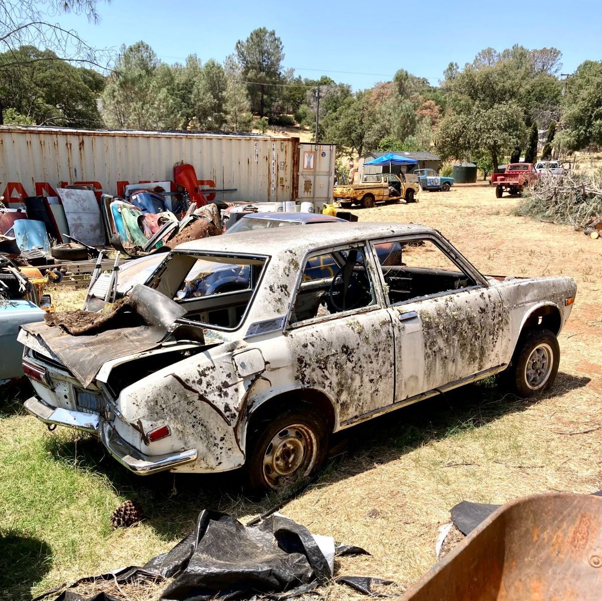

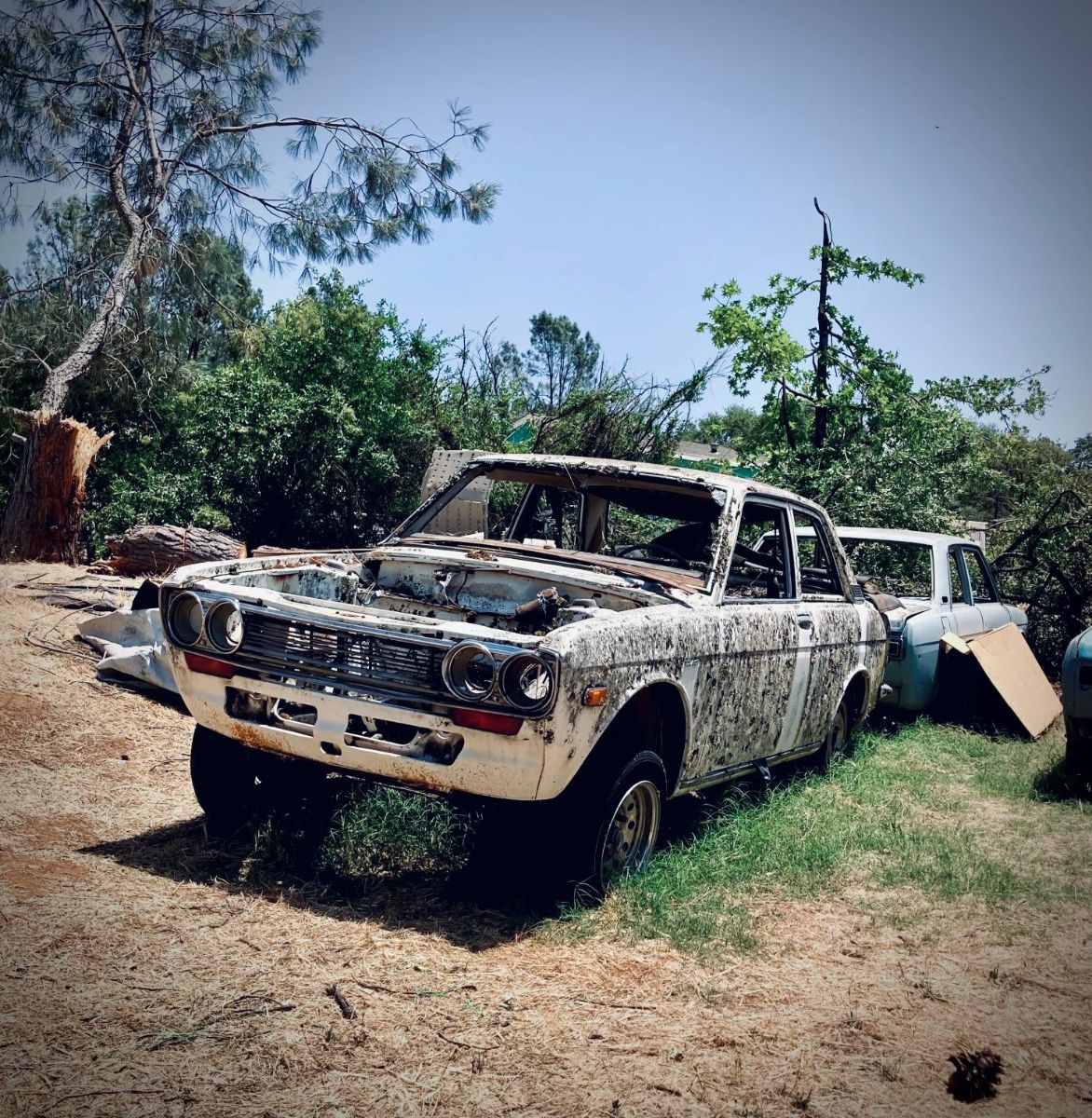

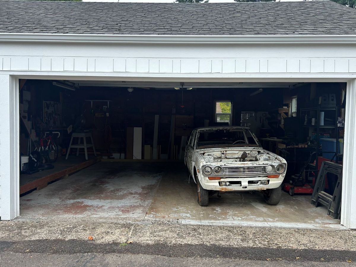

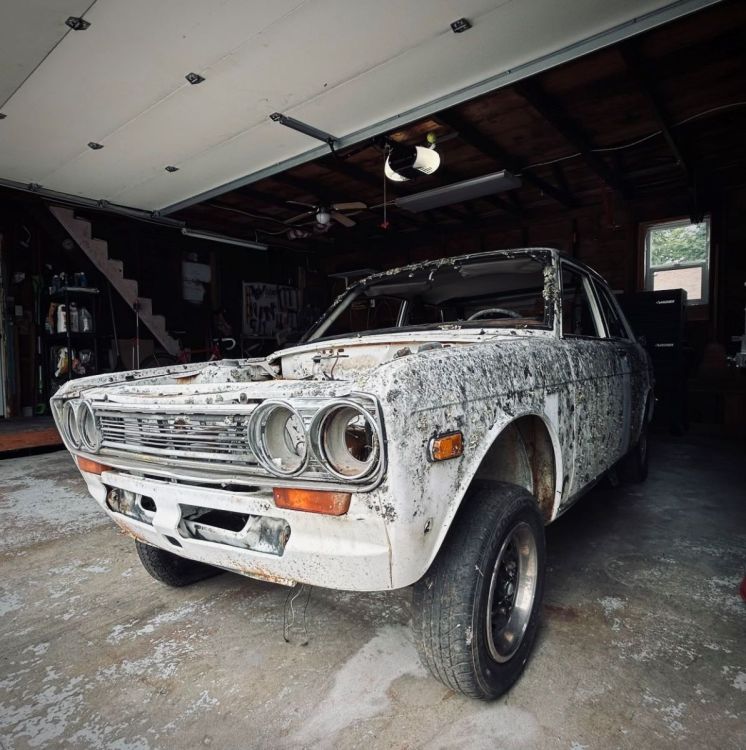

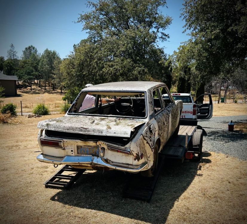

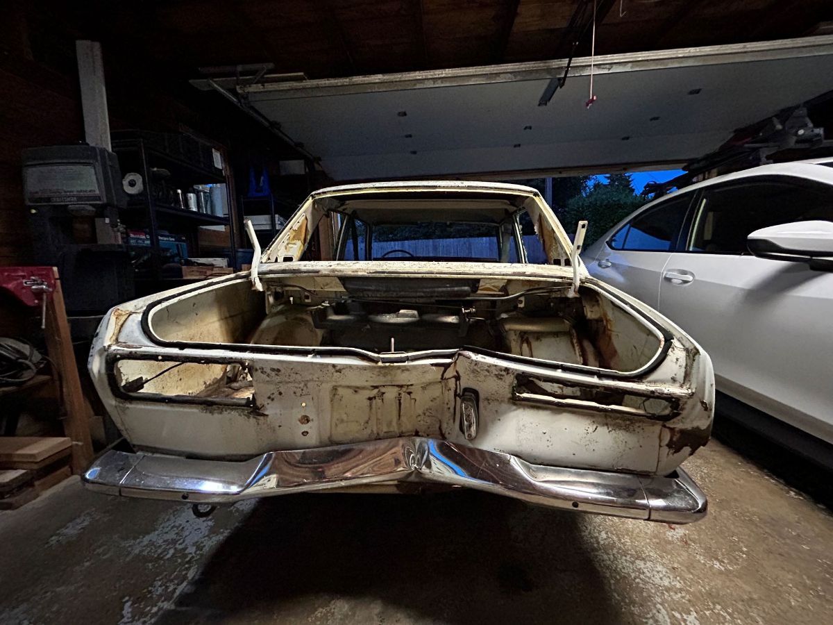

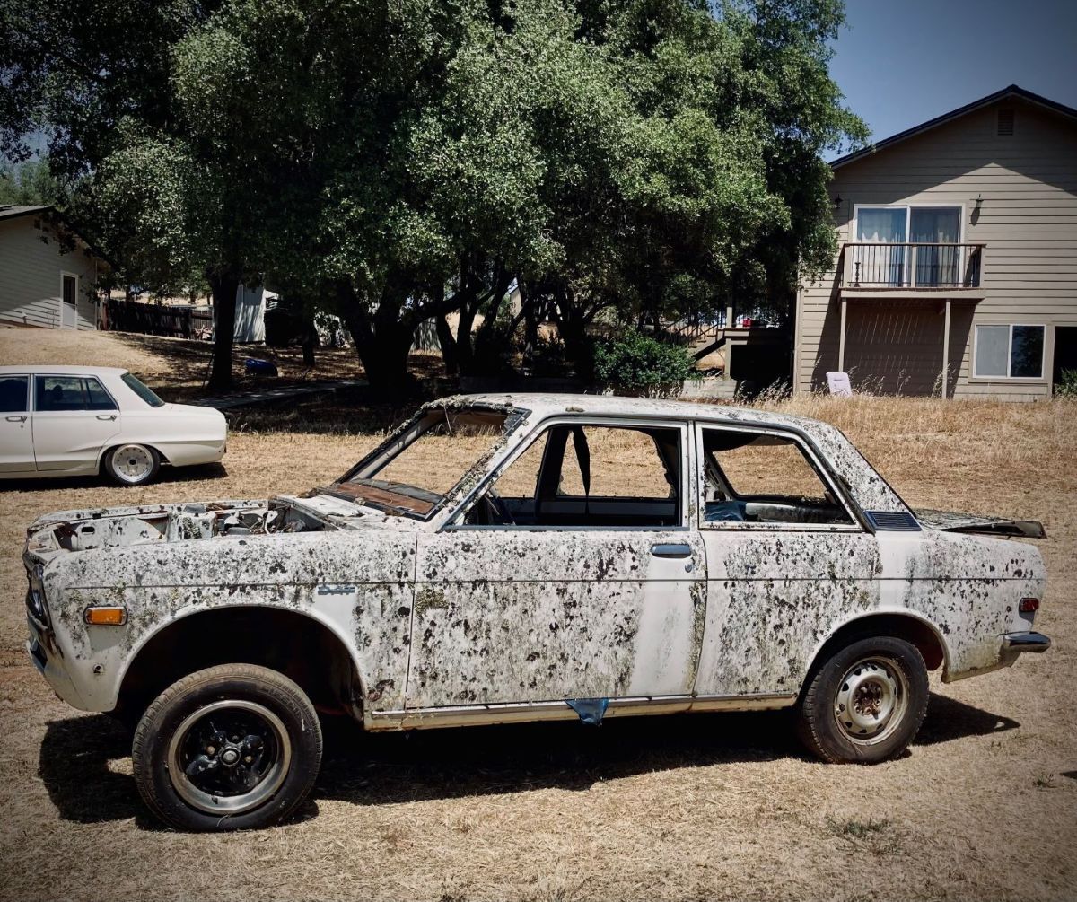

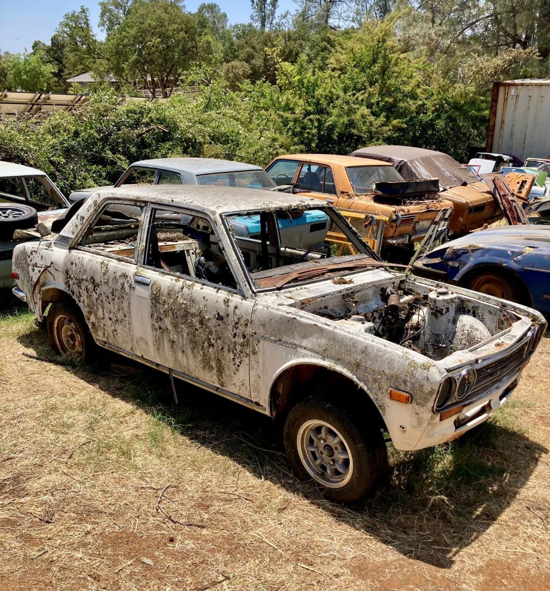

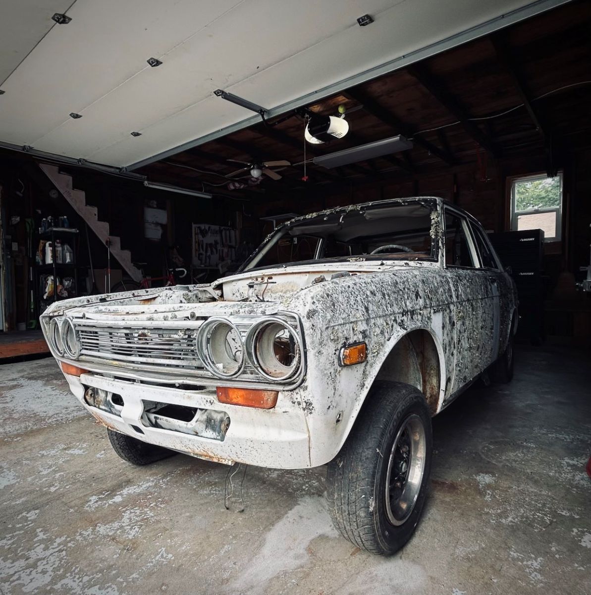

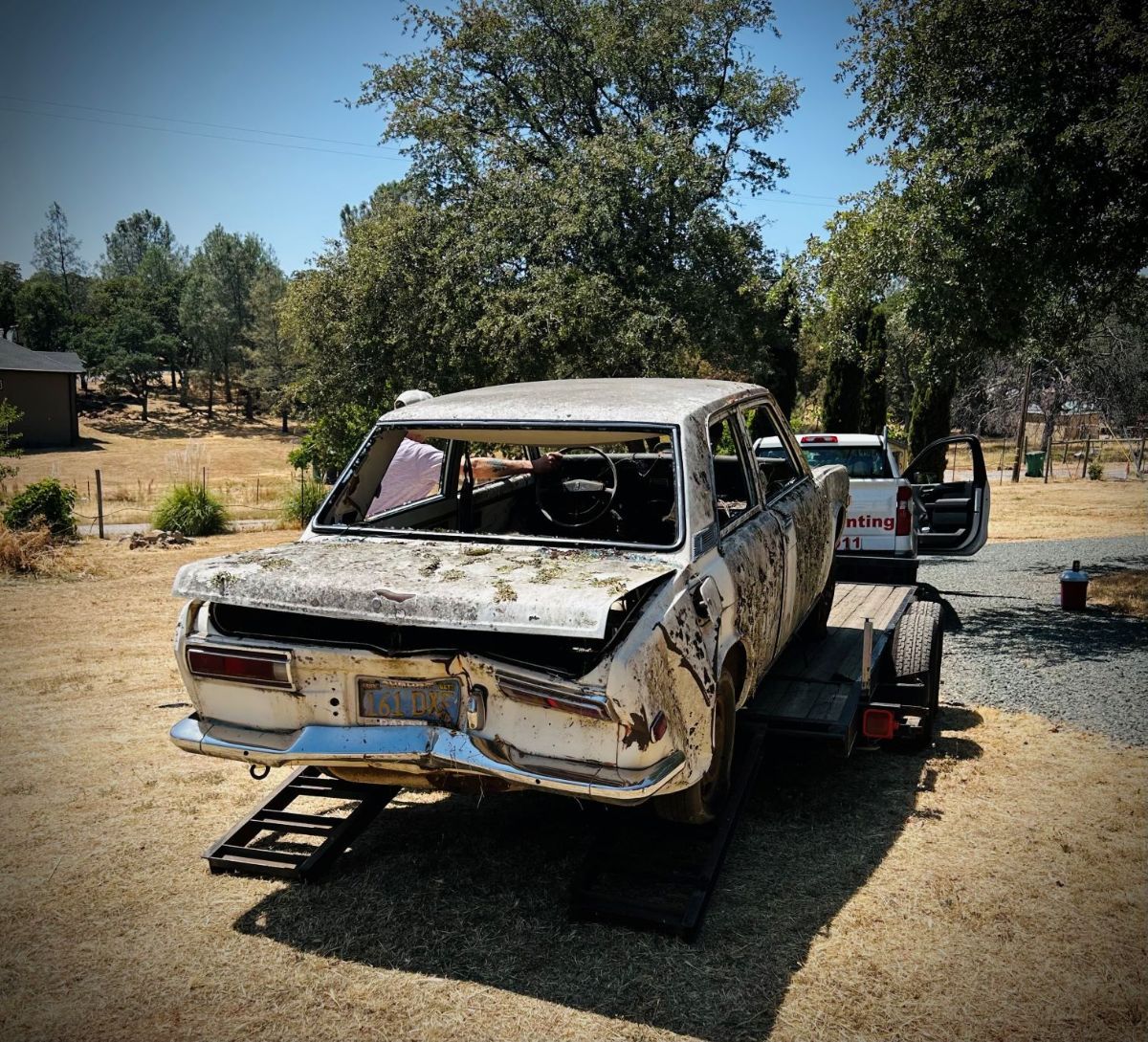

Silky_Johnson Posted June 25, 2025 Report Posted June 25, 2025 (edited) Ratsun. I'm back. I sold my goon back in 2016 or 2017, and then went through major life upheaval. I have a garage again, and one of the first things I considered was that I needed a 510 again. Wagons rock, but I really wanted a 2-door sedan. So, here we go. I connected up with James the510keeper, and I picked this project up last weekend. Except for significant damage in the back, the body is very straight, and does not have cancer eating through anything. The plan is to do this slowly and right. I bet I won't be driving this for a couple of years. Edited June 28, 2025 by Silky_Johnson 4 Quote

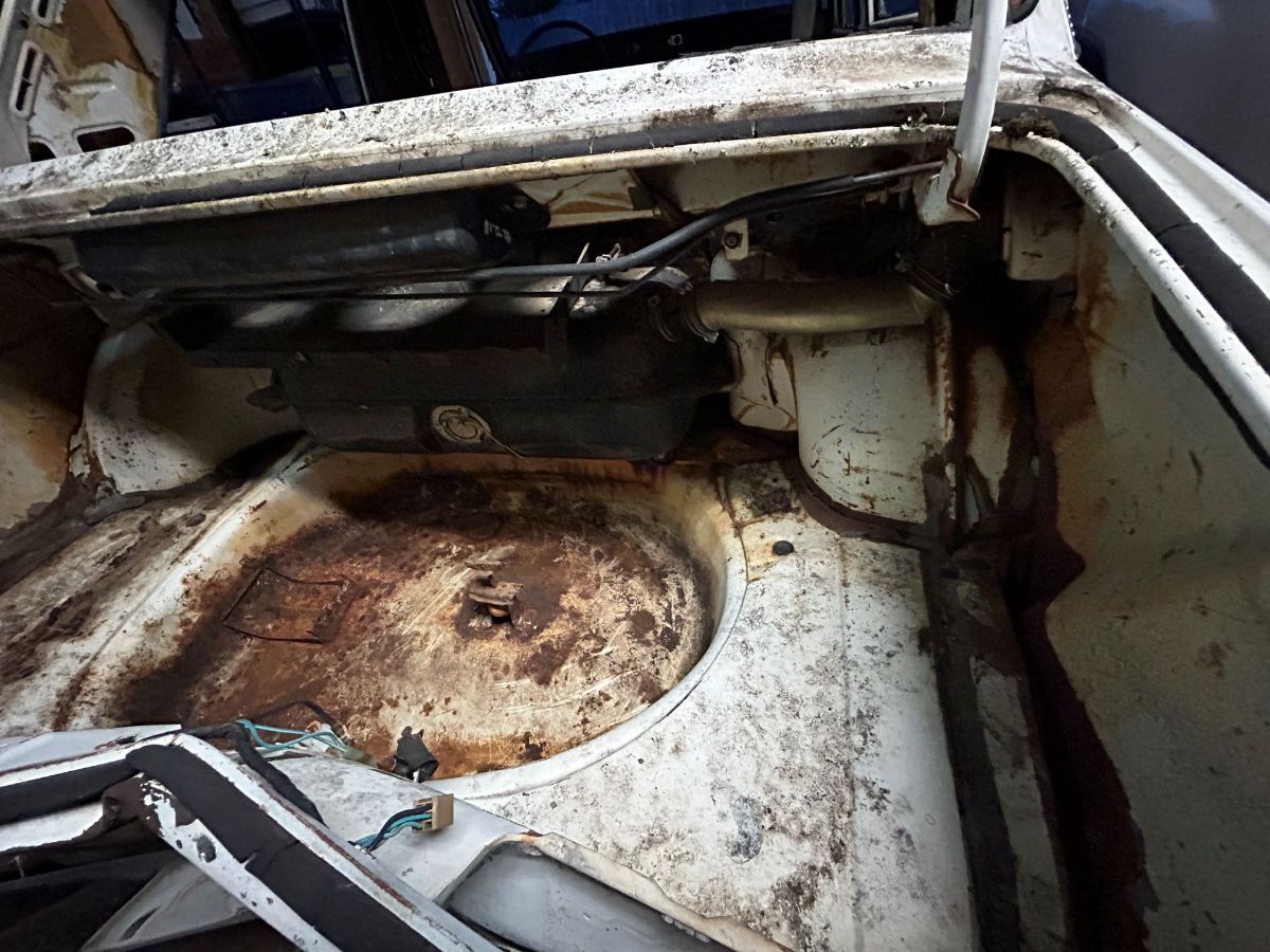

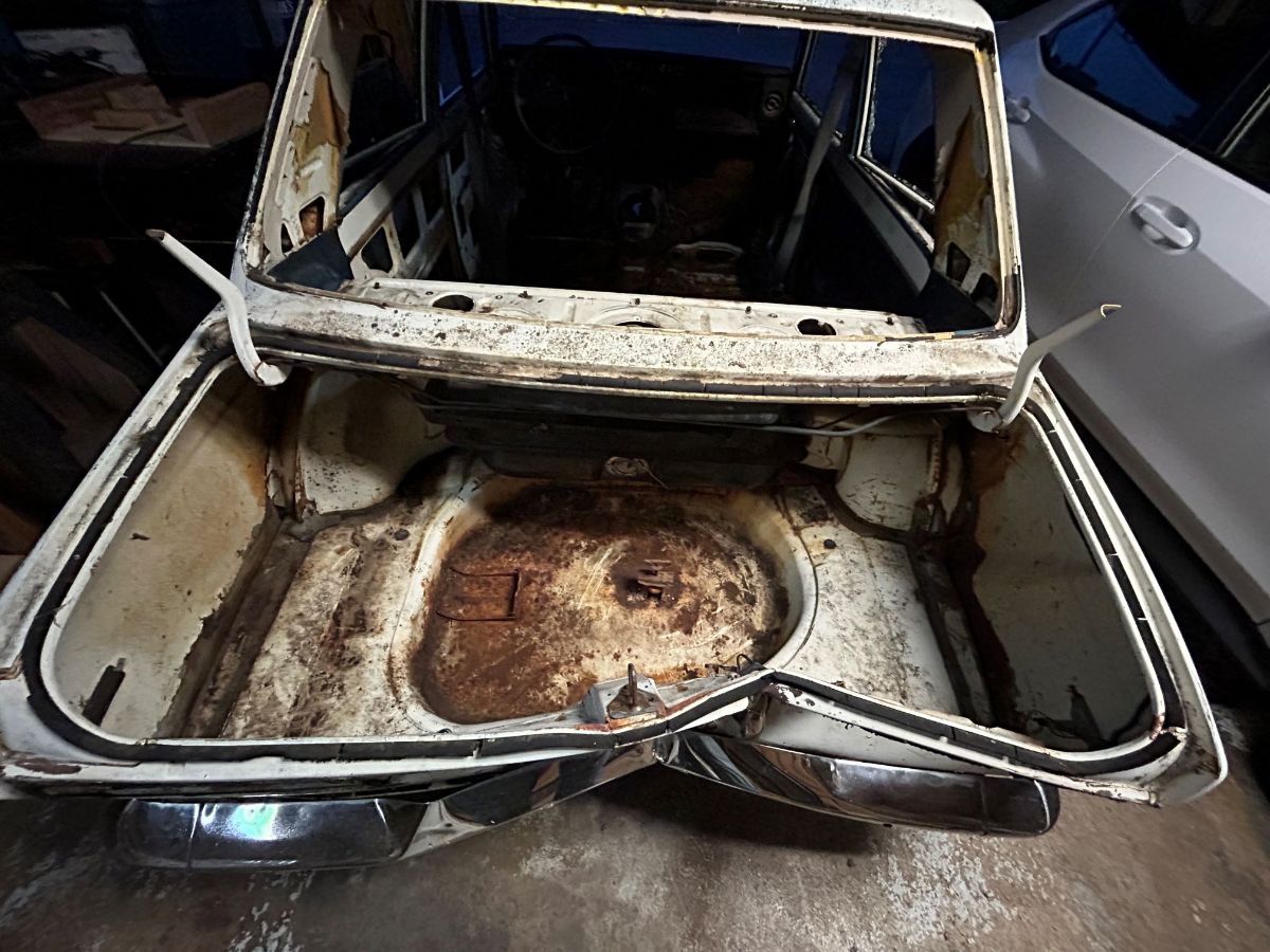

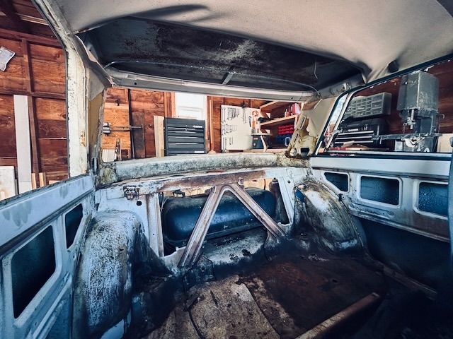

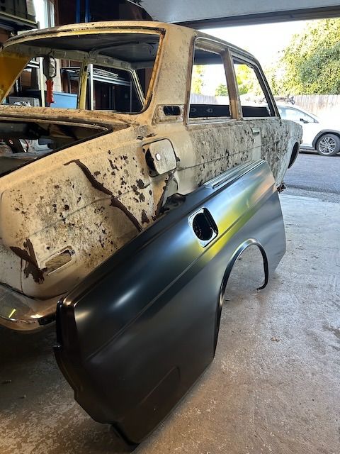

Silky_Johnson Posted June 27, 2025 Author Report Posted June 27, 2025 Yeah, I'm just getting started and I'm formulating the plan in my head. The way it's looking, the body is actually mostly straight and rust free. Most of it won't take that much work. I think I need to completely replace the passenger rear quarter panel, the tail light panel, and rear valance. Trunk floor needs a solution - I may be able to straighten the existing trunk floor enough? I could fab up something simple or swap in a trunk floor from another car. Once the trunk floor is out, I need to punch out the wheel well a bit to get back to square one. None of the damage tweaked or twisted anything beyond the rear panels and inner fender, so I'm 90% sure I won't need to pull out any metal to get the rear shock towers to line up. I think they're good. Other plans are maybe doing BRE fiberglass flares so I can fit 13x7 wheels. I was originally wanting to build a KA24E for the powerplant, but now I am heavily leaning toward an LZ23 Frankenstein engine. I loved working on L-series stuff on my goon. We'll see. First things first - I gotta strip and clean this thing. 1 Quote
Rustbin Posted June 28, 2025 Report Posted June 28, 2025 The dreaming step is important, imagining what you might like and how you might do it, like removing the ridges in the wheelhouse before finishing off the rear quarters. If you drill out the spot welds and remove the tail light panel and valence, you may be able to straighten them out. This will also make working on the trunk floor much easier. The rear quarter panel will be hard to pull out enough to look good but would be good practice for your metal working skills, you've nothing to loose by it. I might be biased because I like doing that kind of metal work but you can learn a lot from YouTube videos, just try them out on a practice piece first because there are a lot of good hints there are also some bad ones too. I'm going to keep watching to see how this car turns out. Quote

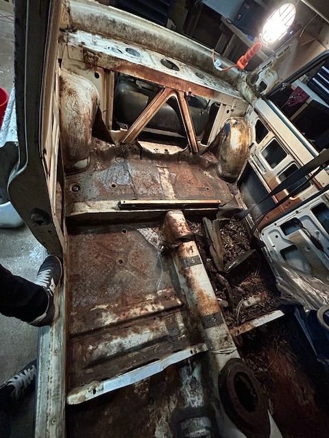

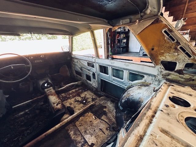

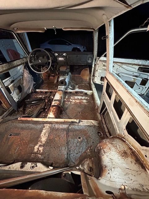

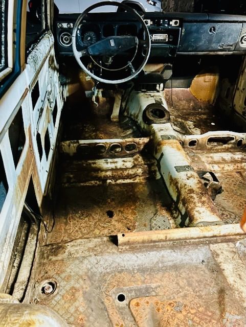

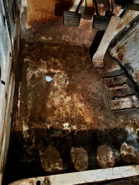

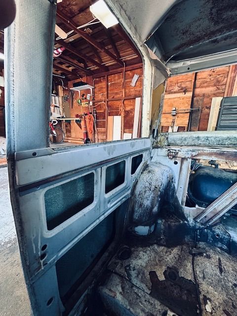

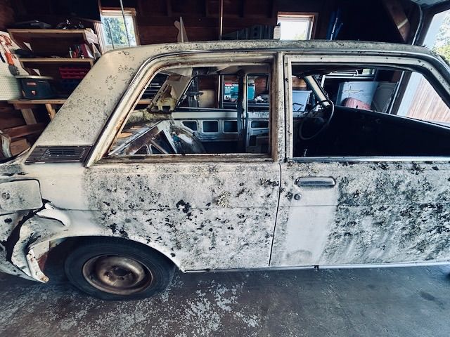

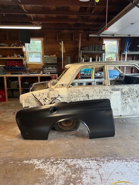

Silky_Johnson Posted June 29, 2025 Author Report Posted June 29, 2025 Just cleaning and stripping things down today. Slow going. I am pleasantly surprised at how solid the metal is, and now I'm thinking this won't take anywhere near as long as I thought. 2 Quote
Silky_Johnson Posted July 1, 2025 Author Report Posted July 1, 2025 More slow cleaning. I got a bunch of that weird tar insulation stuff out. Gasket scraper did the trick nicely. Quote

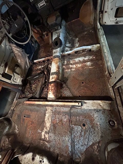

Rustbin Posted July 2, 2025 Report Posted July 2, 2025 Will you be able to just wire brush the rust then use rust converter to be ready for paint? Quote
Silky_Johnson Posted July 2, 2025 Author Report Posted July 2, 2025 14 hours ago, Lachlan said: I love how the solid coloured sides separate them from the turret and give the car more visual length. The two slashes of white behind the front fender are a chef’s kiss. Great observation! I guess I hadn't consciously noticed this or put it into words, but the BRE design totally visually lengthens the car. It makes a 510 look right. I guess my theory on this would be "If Pete had made a second guest car." For a street car, I might do it a little more understated - no sponsor names, maybe not put the BRE name in the stripes and just leave it at "Datsun"? I'm also on the fence with giant numbers on the door, except they really complete the look. They are kind of aesthetically the right thing, so it's hard to take the conservative route. If I did closer to a replica/tribute, BRE has a program to get a certificate from them. I think that's mostly for legal/liability reasons, but if you grab a certificate, they even supply decals and different things to make it more legit. 1 Quote
Silky_Johnson Posted July 2, 2025 Author Report Posted July 2, 2025 11 hours ago, Rustbin said: Will you be able to just wire brush the rust then use rust converter to be ready for paint? Good question. Undecided. And I figure I've got time to decide until after I teach myself how to weld and repair the rear-end damage. The way I see it is the solve to the problem is on a large spectrum of "pretty bad" to "gold standard." Gold standard could be repainting brand new rust-free metal in the same way or better than modern car factories. Pretty bad could be vacuum the loose rust and dirt off, Rustoleum without primer, then throw carpet on top of it and pretend like the rust doesn't exist. My solution is probably somewhere in the middle/upper end of that spectrum. In my case, the metal is solid, and it doesn't need to look too pretty. If I can stop the rust and keep paint from bubbling up in 5-10 years or more, I would be a happy guy. Stabilized, clean, solid, functional is the goal. If a rust converter would do the trick, then it's a viable option for me. There's just so much bad information on the various rust treatments that I'm not sure which one might actually give me the result I want. Another thing I forgot about with 510s is the little hiding places for rust. Any ideas for treating areas with little or no access? One gap under the metal seat rail thing. Another one is a hole that goes down into a frame piece that's closed off (I think). If I go nuts with welding, maybe I could take pieces off and reattach? You guys just ignore those spots and hope for the best? 2 Quote
Rustbin Posted July 3, 2025 Report Posted July 3, 2025 I use a product by SEM called rust mort, it is the same viscosity as water which I apply with a natural bristle (pigs hair) brush. You can flow it into the channels to stop the rust without needing it to open it up. I have a wire brush on my angle grinder that works real well at cleaning the rust off the surface so the rust mort can do the rest. If the floor pans were rusted out I would recommend KF vintage jdm panels, they are good quality. 2 Quote
RetroRocket Posted July 3, 2025 Report Posted July 3, 2025 Rust Mort works well and is handy because it gets into nooks and crannies like you said (because it is a liquid). For a spray-can application to larger areas Rustoleum Rust Convertor works. SEM is expensive and Rustoleum is cheap. I use those little foam applicators with wooden handles for rust mort. 2 Quote
Rustbin Posted July 4, 2025 Report Posted July 4, 2025 I have never used the Rustoleum product and I am still on the pint of rust mort that I bought a the begining of my project two years ago, mind you I have been replacing much of the rust with new metal. 1 Quote

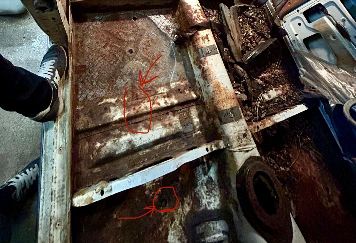

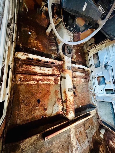

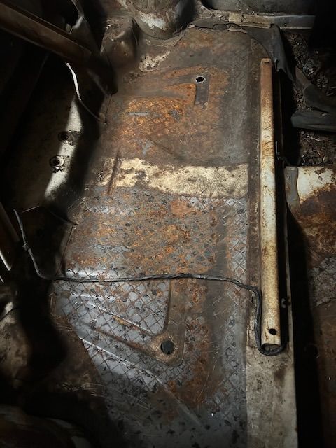

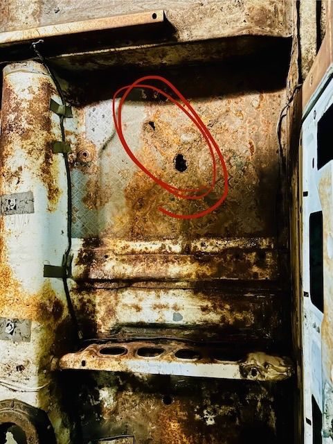

Silky_Johnson Posted July 12, 2025 Author Report Posted July 12, 2025 I guess the official decision is Rust Mort. I'm a ways off of that. Still stripping things down and assessing issues before rebuild. Once I'm down to a shell, I can borrow hydraulic stuff to try to pull out as much of the rear-end damage as possible before I start drilling out welds. Photo dump: Cleaned out the driver's side. Finally found my first bit of cancer. It's not bad. Just a couple of extra holes back there. Not sure how much I'll do to fix it. And a shipment arrived... 3 Quote
