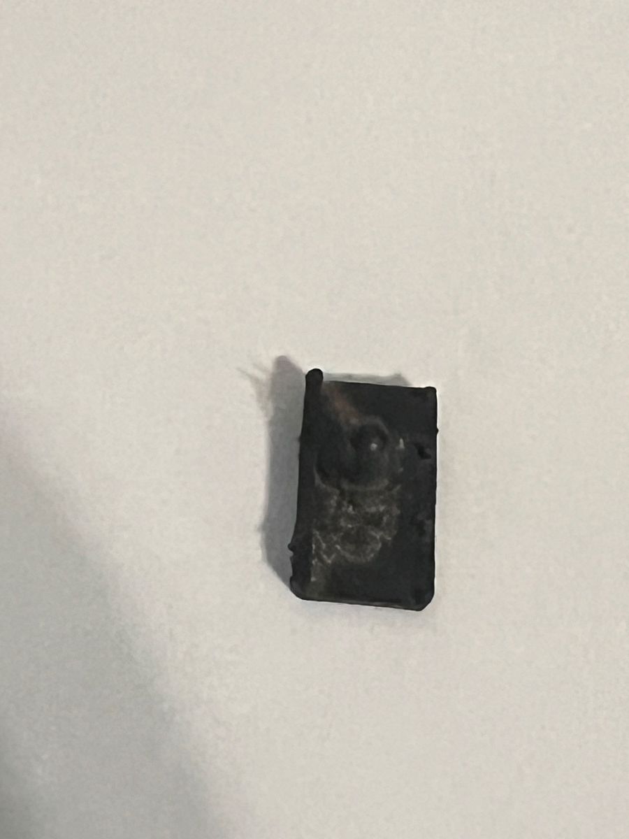

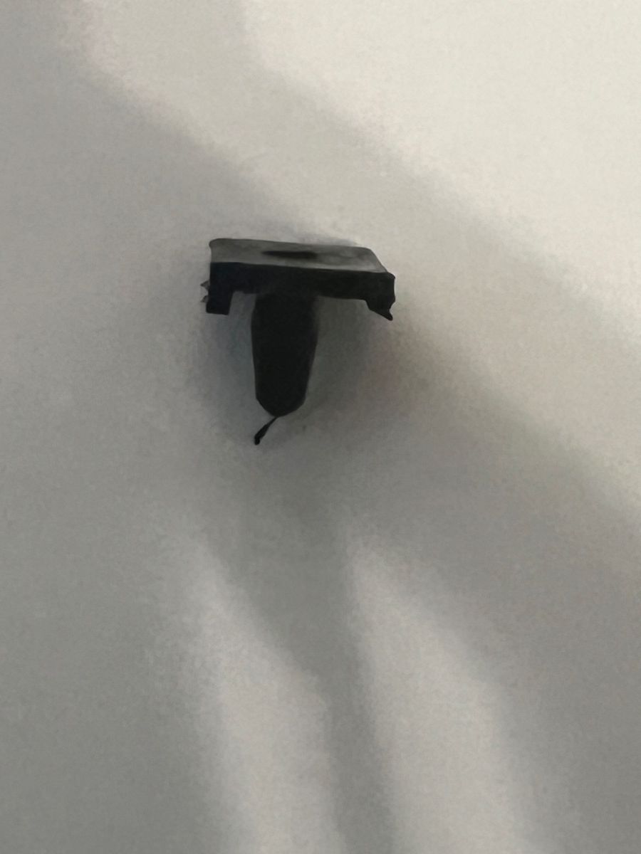

Looking for a replacement for these clips. They go on the bottom of the door and hold the edge of the weather stripping. I have not had any luck finding them online. Thanks for any info.

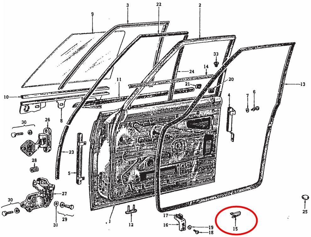

The clip isn't shown in the USA Datsun catalog

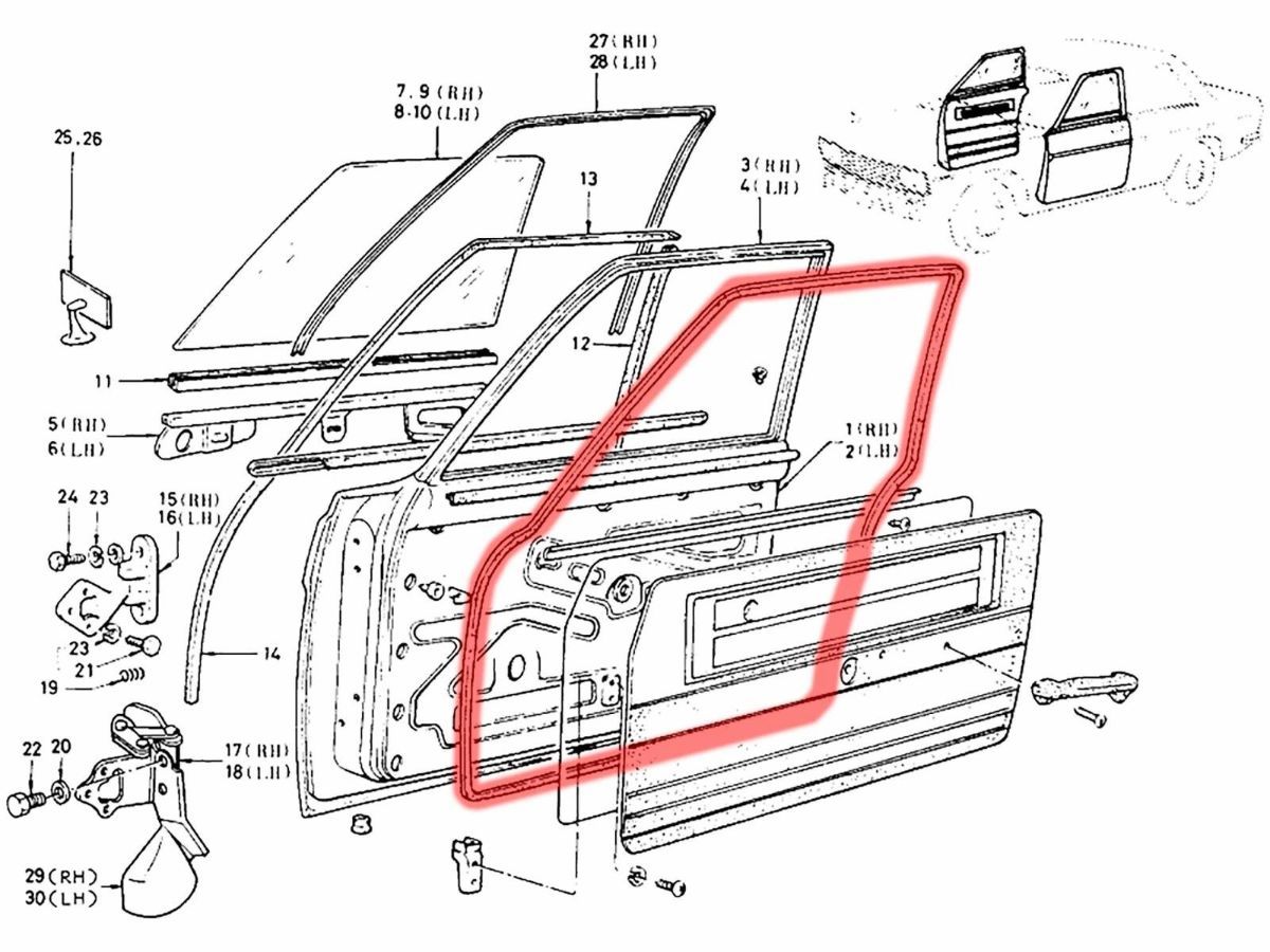

JDM catalog
80828-A0600 CLIP-door weatherstrip (from chassis# P510-146965)
Door Weatherstrip

I ended up using some trim screws with a large flat head. They were the right size for the existing holes and just big enough to bite the edge of the weatherstrip.
