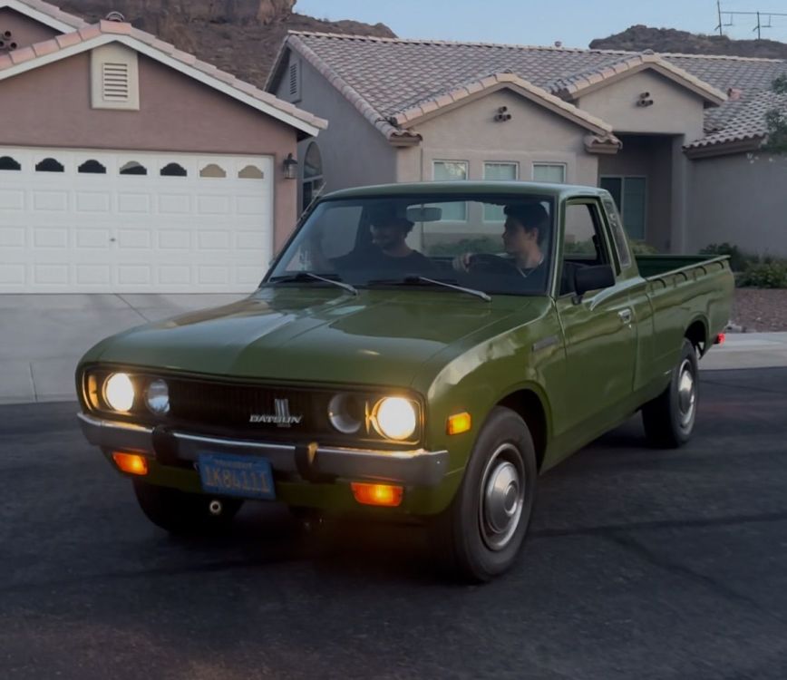

Capt. Koko Posted June 16, 2025 Author Report Posted June 16, 2025 (edited) Luckily, I kept every part I have removed. also, my son and I replaced upper lower ball joints, shocks tension, arm, bushing, and tie rods on Father’s Day. What a gift. The steering is still a little loose, but tolerable. I tightened it up, but I don’t want to go too tight. It feels very connected, but not being power steering. It’s a little more work when turning. Finally, the direct conducted heat to my current carbureted situation Is likely the source of my heat soak. When I remove the line, there is still fuel in it. I have just taken the mechanical fuel pump out of play and blocked it. It was very hot and fuel line was dry after last event with it attached. I’m using only the appropriate reduced psi electric fuel pump. I will still run a return line however I would like to run a return line to the restricted port from the carburetor directly. Is this advisable? and which part would I use. I understand the vent is a top of the 32/36 and the adjacent intake is likely a no go. I really do hope that Phenolic riser will do the job. Edited June 16, 2025 by Capt. Koko Quote
