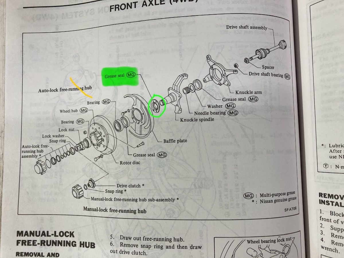

greenflame1 Posted November 25, 2025 Report Share Posted November 25, 2025 I'm in the middle of a suspension rebuild on a 1985 720 4x4 and have a question about a grease seal. There's a grease seal between the baffle plate and knuckle spindle that has a metal plate around it. I can't find a replacement on Rock Auto, O'Rielly's or Autozone. Does anyone know what this grease seal is called and if replacements are still being made? I'd share photos, but I'm new here and haven't figured it out yet. Thanks. Quote Link to comment
datzenmike Posted November 25, 2025 Report Share Posted November 25, 2025 Try posting a picture now. Looks like it's called the 'inner drive shaft oil seal' and Nissan part number #40228-50W01 for both sides. It's also used on the D21 Hardbody 4x4 and the WD21 Pathfinder as part #40228-31G00. Try these part numbers and most auto parts stores can cross reference to after market parts producers. Like a lot of seal and bearing parts they are generic and used in many applications other than Nissan. Quote Link to comment

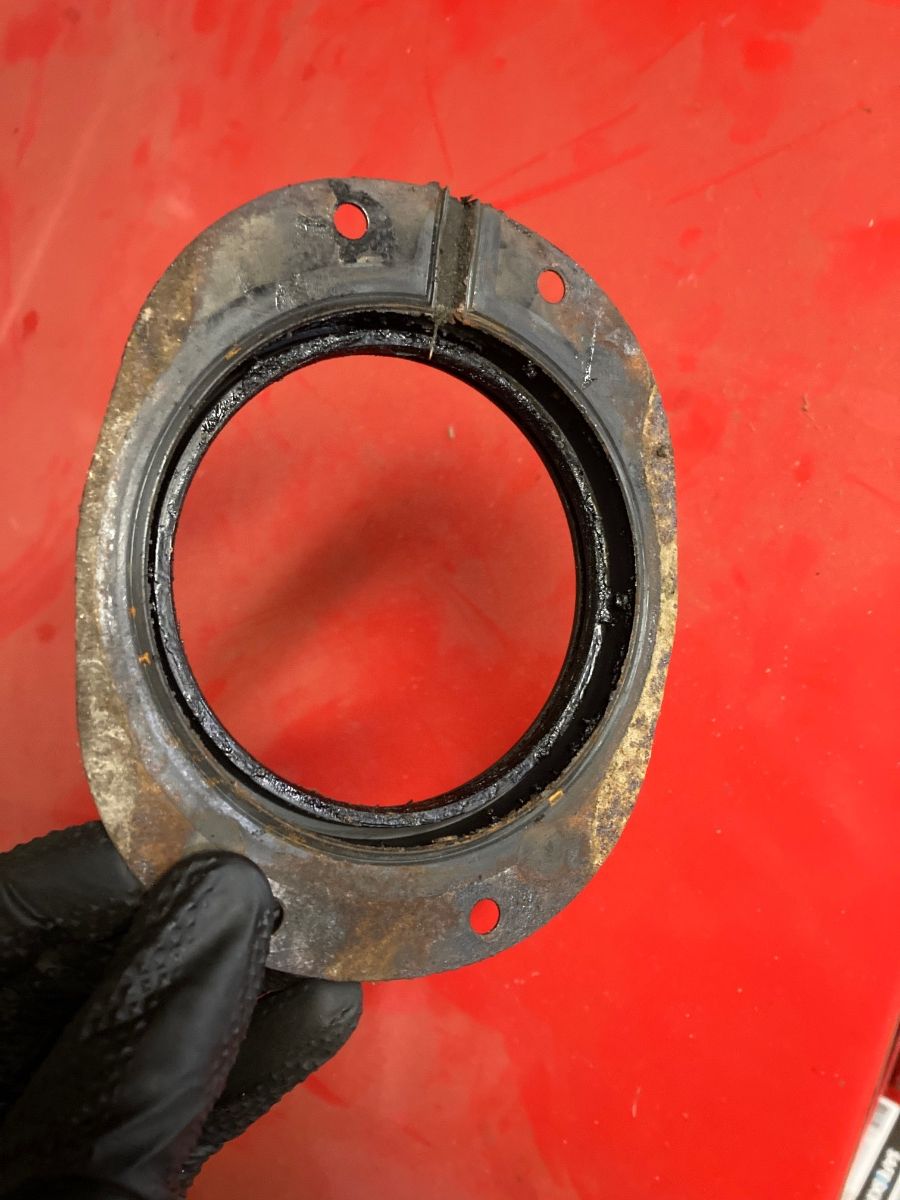

greenflame1 Posted November 27, 2025 Report Share Posted November 27, 2025 Thanks for the part number, that first one is it. I did a quick Google search and confirmed. Thank you. Here’s a photo of one of the seals off my truck. I haven’t found a number on it yet. And here’s how it’s shown in the shop manual. Quote Link to comment
datzenmike Posted November 27, 2025 Report Share Posted November 27, 2025 Number probably on the other side of the rubber. Usually there is a coiled spring on this side? Any chance that the rubber seal part pops out of the metal holder? Quote Link to comment
bottomwatcher Posted November 28, 2025 Report Share Posted November 28, 2025 That should press out. If you have trouble finding a replacement most cities have a place that specializes in bearings and seals. Quote Link to comment

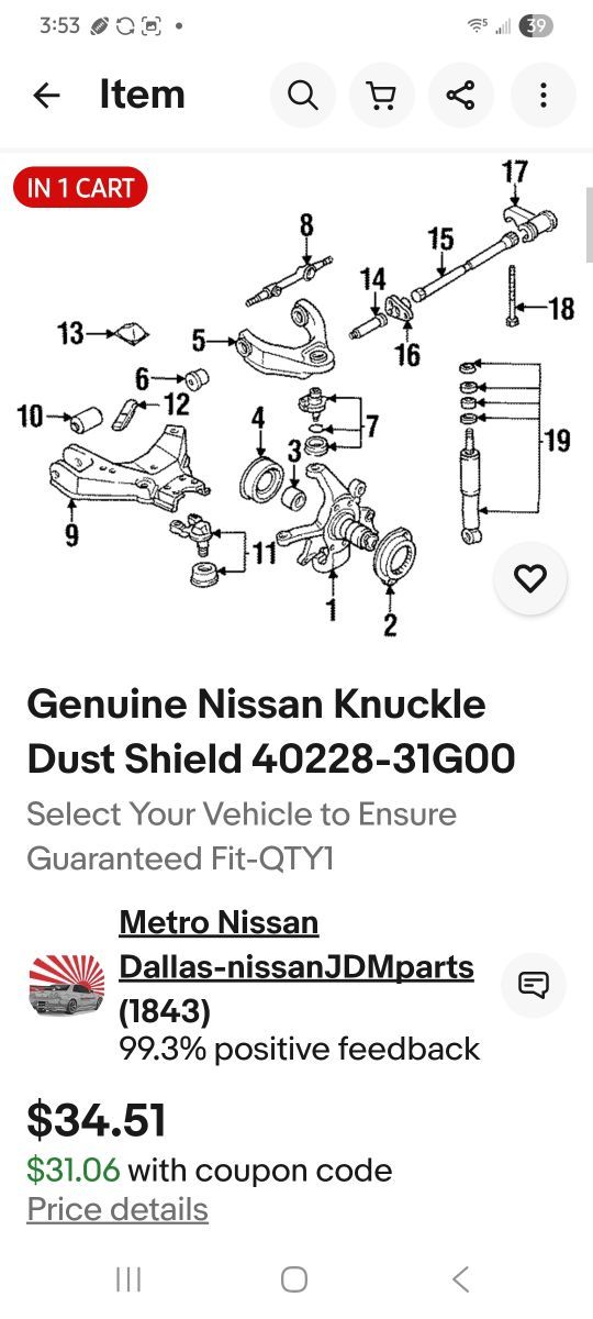

Thomas Perkins Posted November 29, 2025 Report Share Posted November 29, 2025 (edited) Here is the part for sell on ebay.Part number was 40228-50W01.It says 1 in cart.Is that yours? Edited November 29, 2025 by Thomas Perkins Quote Link to comment
