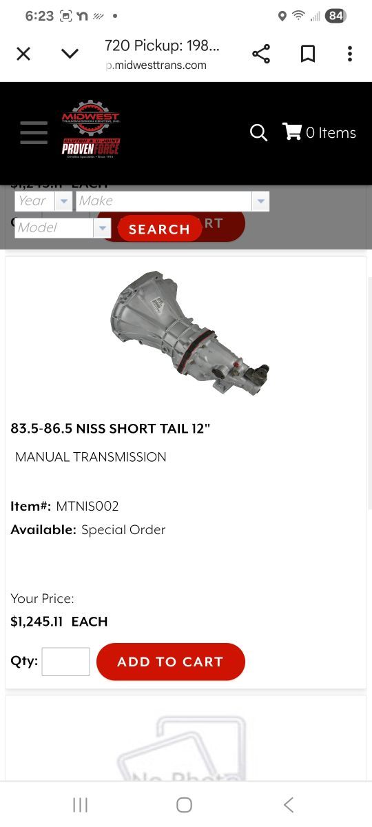

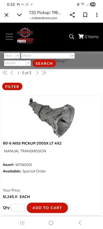

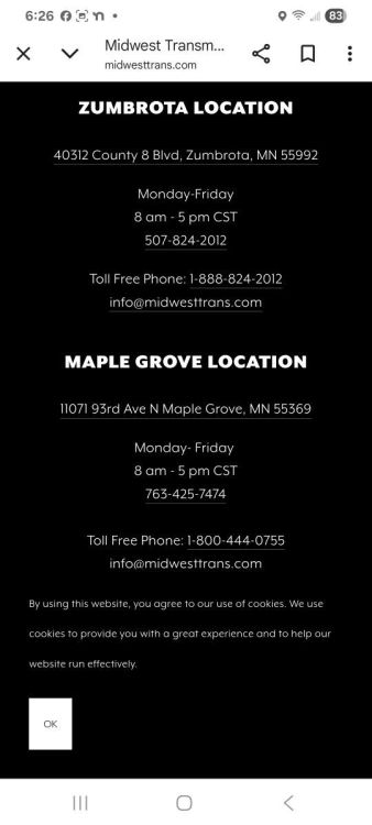

Thomas Perkins Posted May 12, 2025 Report Share Posted May 12, 2025 (edited) Hi Nissan mike.Mid West Transmission has Nissan 720 transmissions for 1245.11.They will want yours for the core.Back in 2017,mine went bad.I took it to a transmission shop here in Columbus,Ga.He said they don't rebuild them.Told me he could get one from Mid West with a year warranty.He also put a new U-joint on and a new yoke.The bad yoke was causing it to vibrate and make a noise.Yoke was 135.00.That was 8 years ago and still doing great.I have been using Redline MT-90 gear oil in it since then.Oriellys can get it in a day.Takes 2 quarts.My wife needed a transmission for her 2004 lincoln ls 3.0.I had a Jasper one installed by a Jasper installer here.He put a Jasper engine in my 85 Nissan 720 2.4 4x4 back in 2009,now have about 108,000 miles on it and still runs great.Jasper comes with a 3 year,or 100,000 mile warranty.If anything goes wrong Jasper will send another one.Only a Jasper installer can install them.My wife's transmission is doing great.The engine back then was 1700.He put a clutch in it back in 2009.Still doing good.I think he got it from Napa.He also put the custom made heating and air in my 720, 5 years ago.Done put a lot of money in my 720 in 31 years.You get what you pay for.You can go to mid west transmission and see them.They are showing 2 types.Here they are.I screen shot them.Call them. Edited May 12, 2025 by Thomas Perkins Quote Link to comment

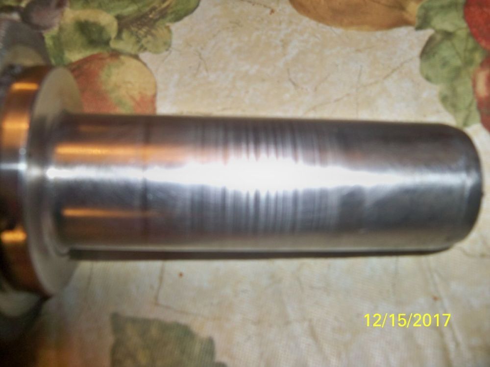

Thomas Perkins Posted May 12, 2025 Report Share Posted May 12, 2025 (edited) Here is the old Nissan yoke that was bad.See the scoring marks on it.It was causing bad vibration on the highway.See the date.When I got the transmission and new yoke and U-joint. Edited May 12, 2025 by Thomas Perkins Quote Link to comment
