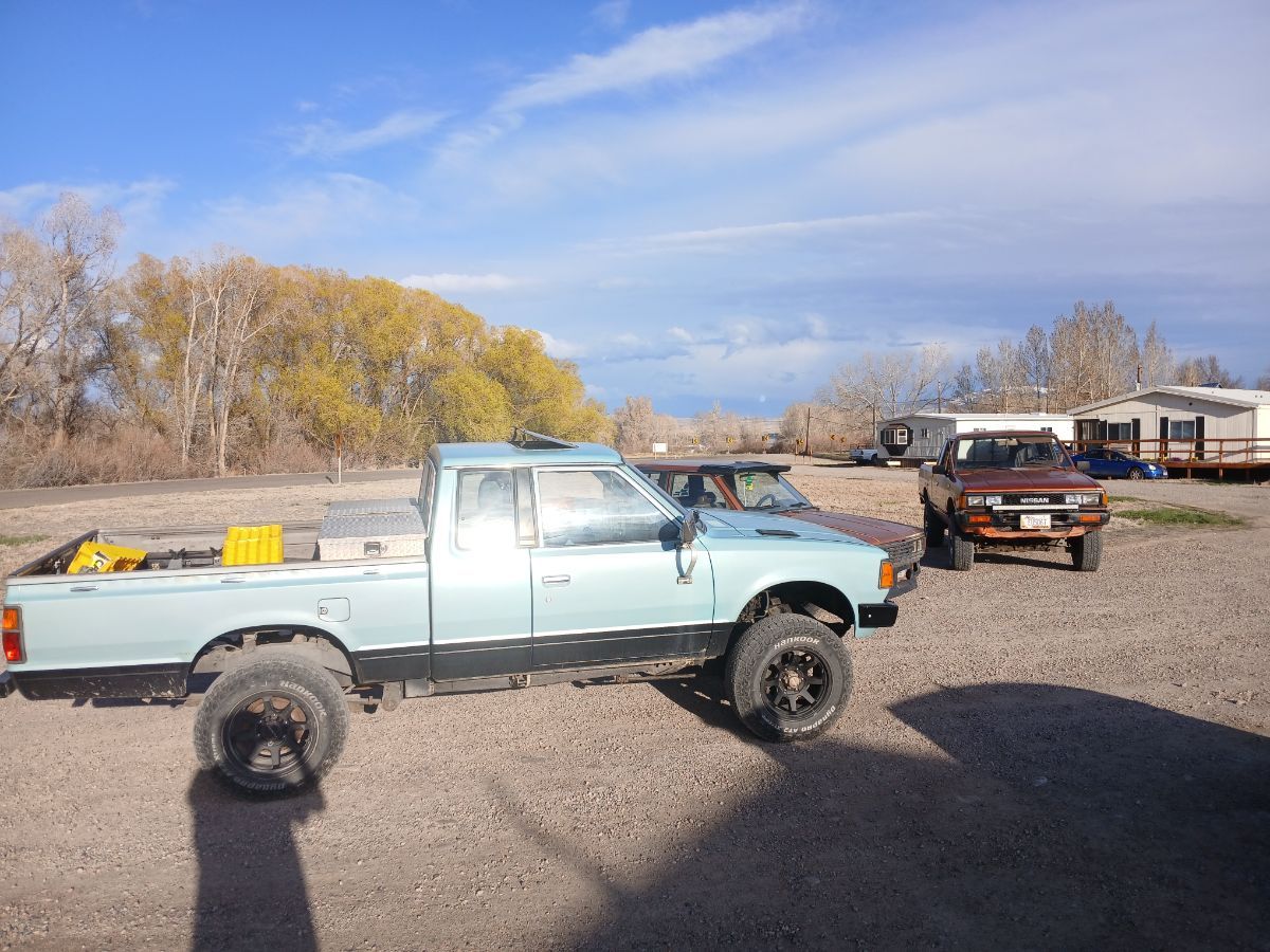

Have a diesel 720 that has some really weird stuff going on with the frame, truck is a loss but need a couple answers.

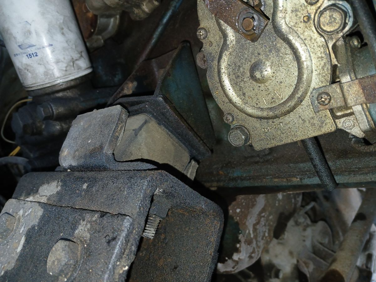

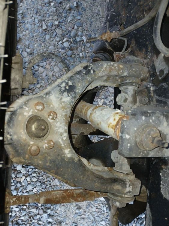

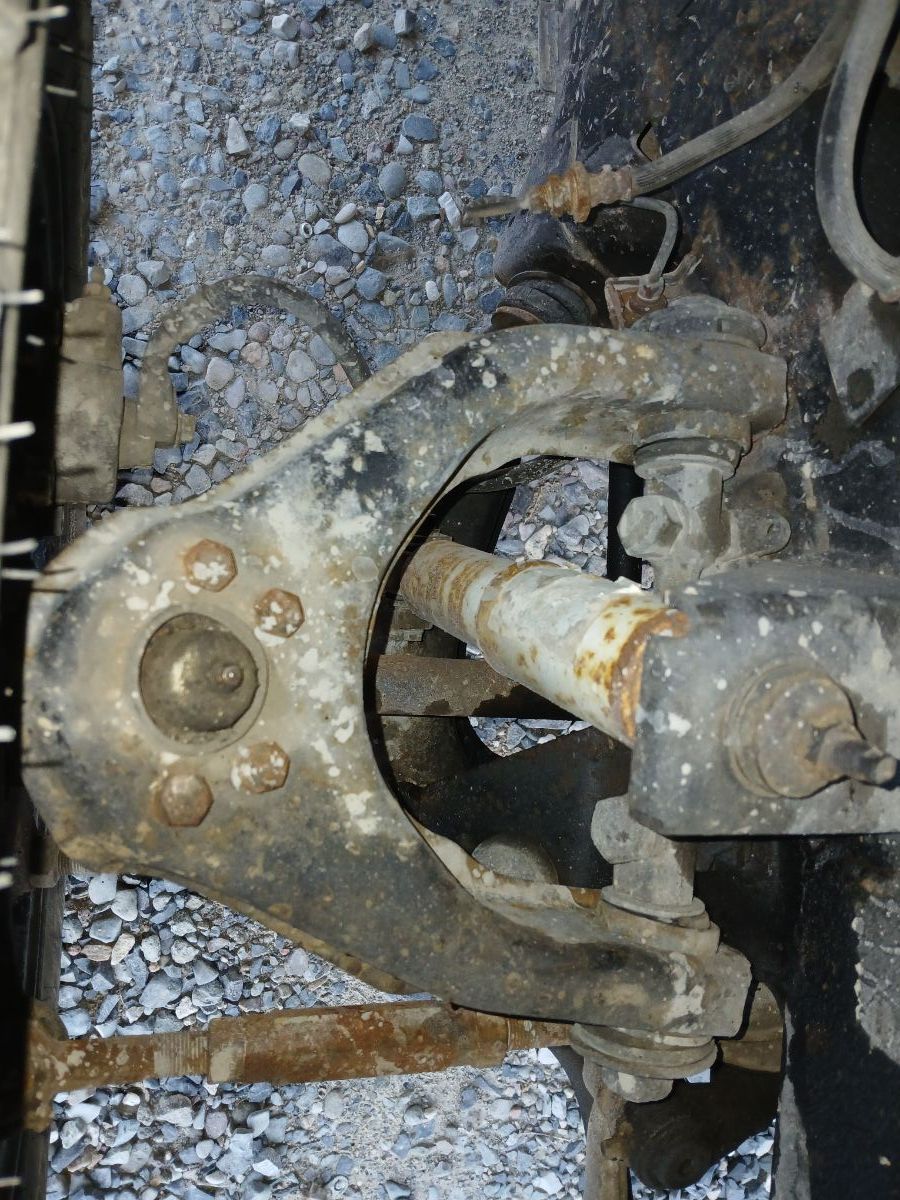

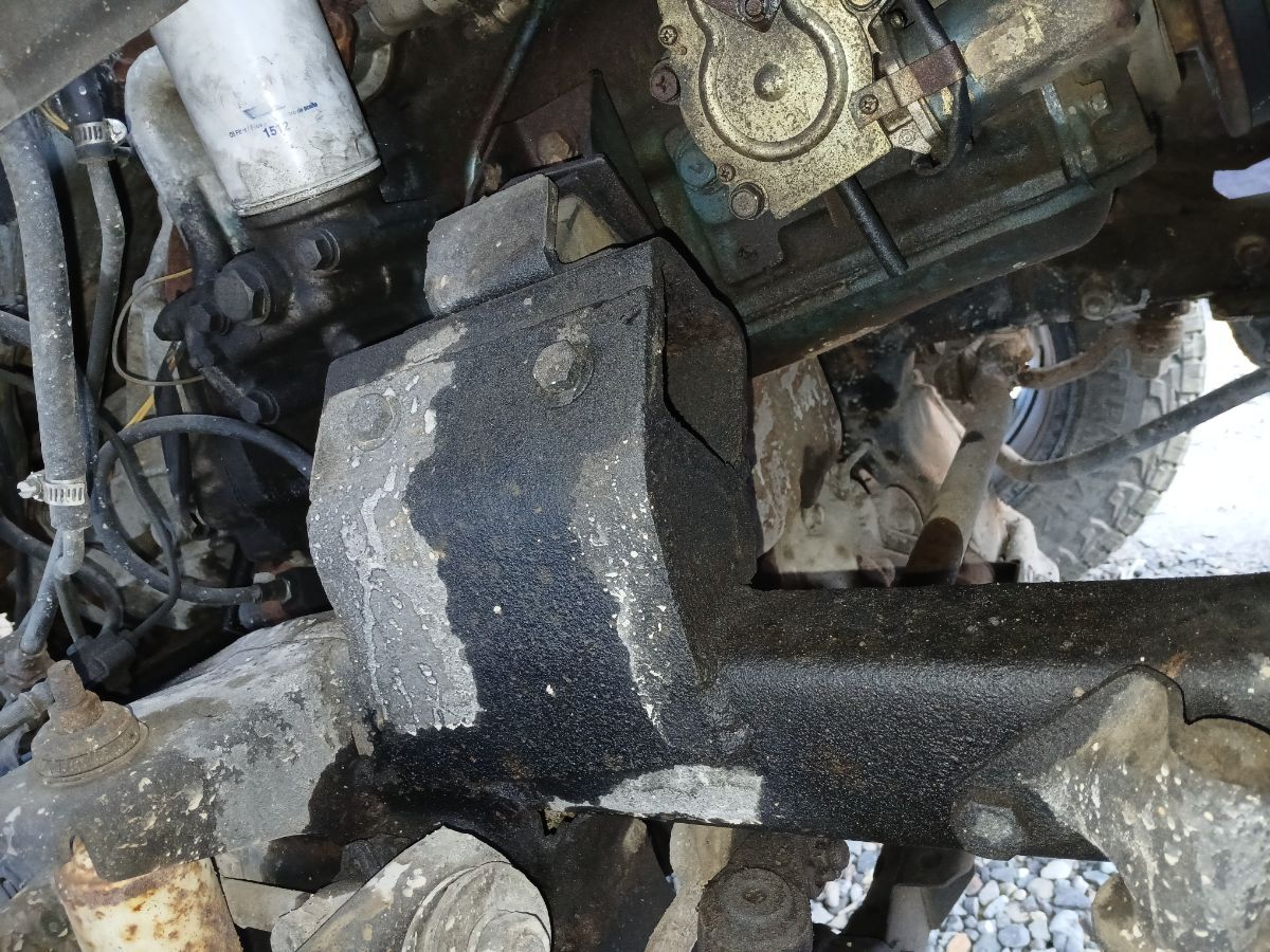

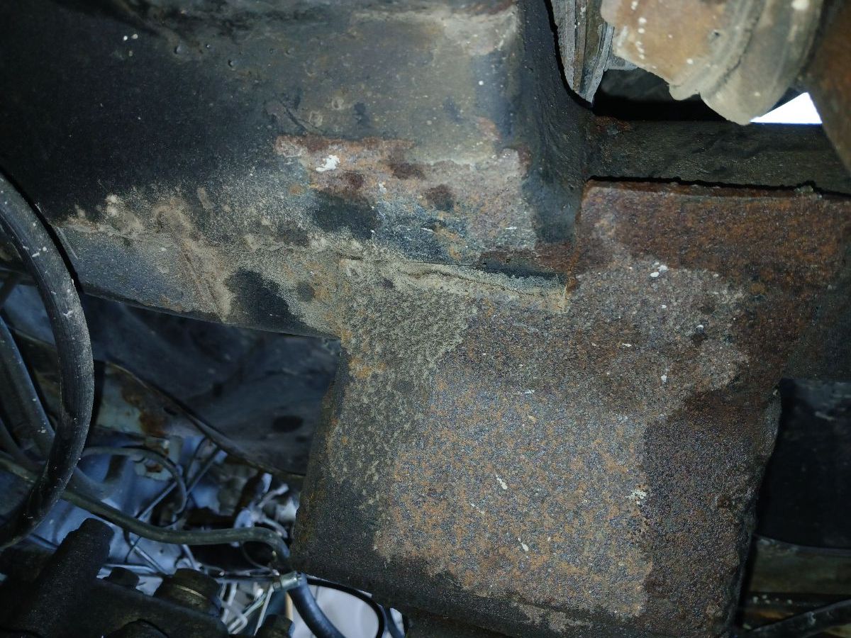

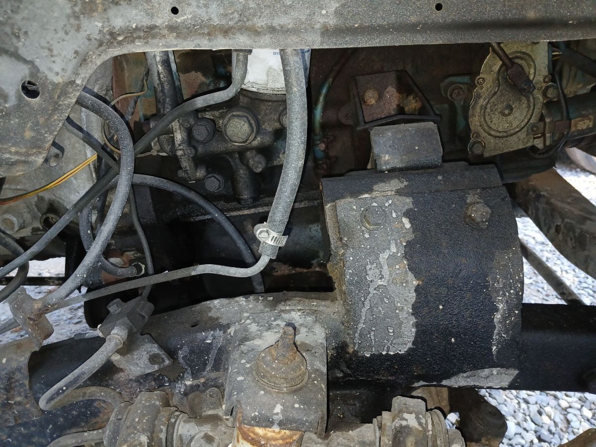

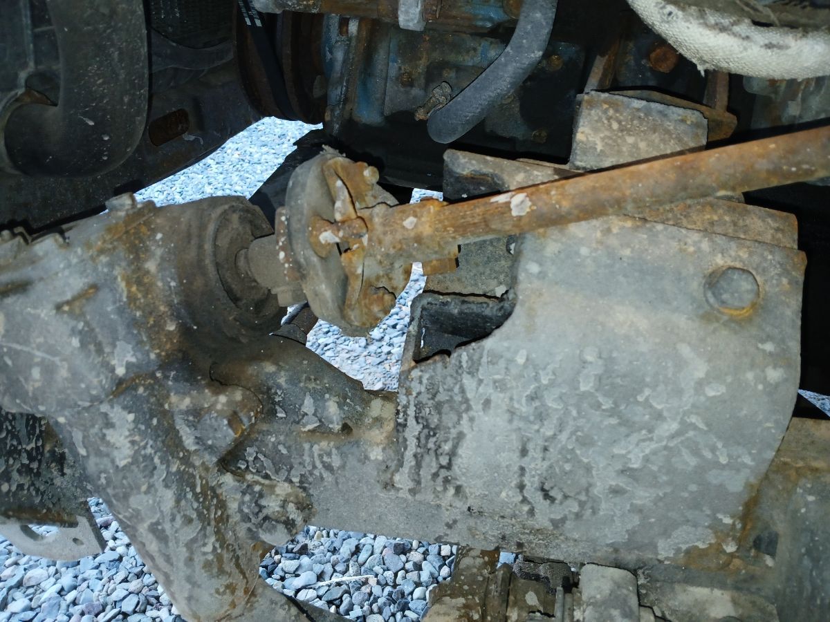

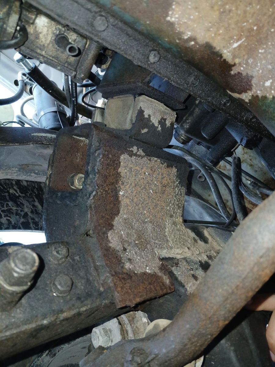

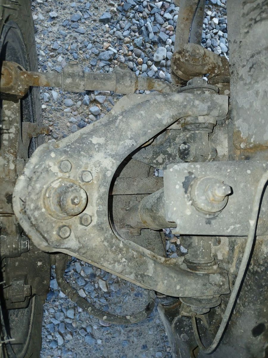

My buddy just got this 81 sd22 4x4 720, we were gonna turbo it but upon some inspection we found some really goofy stuff going on and have decided against it. The motor is getting swapped into a different 720. it looks like some of the suspension tabs on the front of the frame have been cut off and welded back on, the control arms are different, the right arm having like an inch of shims, the front of the truck has a 3 inch body lift and the very back has none, and it's a perfect slant all the way back.
I've never seen a diesel 720 before so I'm not exactly sure what it should look like but there damn sure shouldn't be square tubing shittely welded to the frame for engine mounts and cut out to clear the steering shift right? Also the steering column is about 4 inches short and the whole steering column and wheel sits really far into the dash because of it, its an 81 which shouldnt have a tilt column right? This truck has a tilt column in it. Also the transmission crosmember is just a piece of channel iron shoved in the frame holding the trans up. The weirdest part is the whole cab and bed has been off the frame, rust holes patched by what seems a crackhead with fiberglass the frame and bottom of the cab rhinolined and the exterior painted pretty decently. Looks like a beautiful truck from the outside but junk once you look underneath.

I don’t remember a diesel being offered in a 4x4. I’m guessing someone swapped it in. That thing has to be pretty gutless. A 4x4 was not the fastest thing stock, with the z22 in ‘81. You’re right, it does look decent on the outside. As far as the tilt column, I don’t remember if it was offered in all 720’s, or if not, when they started. Some of those pictures do seem to have some real red neck engineering. Are you sure that trucks not from the south? Haha
North America did not get a diesel 720 4x4.
Tilt steering was offered about half way through the '83 model year and it would have been paired with power steering. The PS unit would fit on the end of the steering box so would have used a shorter steering column. You need a manual steering column.
Turbo isn't going to be much use on an 61 hp SD22. You want 35 extra stump pulling horse power and torque? throw it away and put a Z24 engine and 5 speed in it.
I'd be interested in a picture of the oil pan as it was never intended to clear the front differential.
Ah, i was wondering why the engine was jacked up
and the 3" body lift on the front only, is probably to clear the raised engine
That makes sense on the steering column then.
Why can't we just make more boost? Will the sd22 not handle much before blowing up or will the injection pump not handle it, we're still thinking about swapping it into a 2wd truck and turboing it even if for minimal gains. I have a small turbo I used on my z24 for a while, made 15 psi for like a year until it leaned out and melted a piston, now I have a forged ka-e I'm about test at 29 psi in my 720.
I didn't realize we didn't get 4x4 diesels in north America, that definitely explains why the raised engine mounts were made to clear the diff, and the body lift only on the front to clear the hood like someone else mentioned.

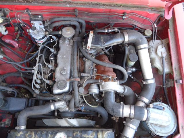

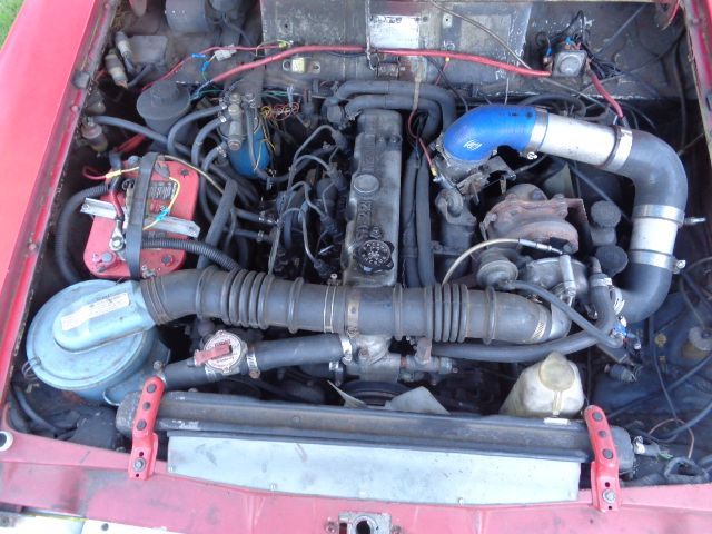

The red one.
The engine compartment.
The 720 engine compartment that has an intercooler.
