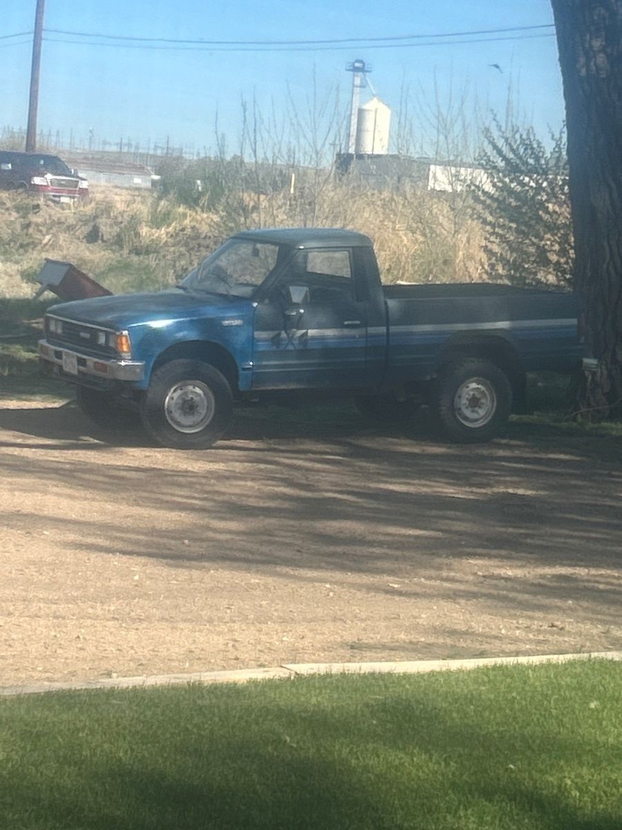

Newto729 Posted May 4, 2025 Report Share Posted May 4, 2025 Hi all- I recently purchased a cheap 1985 720 4x4 . The pickup is ugly but I’m excited. I’ve flushed the transmission, changed the oil/filter, and flushed the fuel system. I ordered a a new coolant reservoir. The instrument cluster has backlights but none of the gauges work. The same can be said about the heating/air controls. I am not mechanically inclined but I’d like to dig into this pickup myself. Any guidance on where to start would be greatly appreciated. 1 Quote Link to comment

Thomas Perkins Posted May 5, 2025 Report Share Posted May 5, 2025 (edited) Don't look like a 85 4x4 to me.Must have different front body parts. Edited May 5, 2025 by Thomas Perkins Quote Link to comment
datzenmike Posted May 5, 2025 Report Share Posted May 5, 2025 Door and box have stripes that the front end doesn't. Also 4x4s didn't come with chrome bumpers they were black 1 Quote Link to comment
powderfinger Posted May 5, 2025 Report Share Posted May 5, 2025 Looks like someone also installed a 2x4 grill. Guessing this truck had significant front end damage and someone swapped on the entire front from a 2x4 truck. 2 Quote Link to comment
ElliotV Posted May 5, 2025 Report Share Posted May 5, 2025 6 hours ago, powderfinger said: Looks like someone also installed a 2x4 grill. Guessing this truck had significant front end damage and someone swapped on the entire front from a 2x4 truck. it seems to be common as none of my trucks have 2 perfect fenders and out of 4 I have only gotten 2 good grills. I've noticed if the sides of the bumper are still bolted to the fender they tend to push against the fender and will fold the fender in as well if you bend the bumper trying to manuever around a tree or something in the woods. This truck is a little rarer being a swb 4x4 truck. I have only ever seen one swb 4x4 truck the rest have been king cabs or I have seen a couple long bed 4x4 trucks. Quote Link to comment

Newto729 Posted May 7, 2025 Author Report Share Posted May 7, 2025 *thank you all. I appreciate the help. I’m not at all familiar with it. The front end was swapped out. I don’t see any deflection, twisting or damage in the frame or front end. Someone had replaced the CV’s recently. I’ll check on the fuses. I pulled the instrument cluster and found the odometer cable is disconnected. Again, I appreciate you all. Quote Link to comment

Newto729 Posted May 7, 2025 Author Report Share Posted May 7, 2025 On 5/4/2025 at 6:31 PM, Thomas Perkins said: Don't look like a 85 4x4 to me.Must have different front body parts. Any idea what year the front end could be off of? Quote Link to comment
ggzilla Posted May 7, 2025 Report Share Posted May 7, 2025 I think it's just the grille and bumper are 2WD parts. 4WD has a no-chrome grille and a black bumper. Perhaps it was in a minor fender-bender and those two parts got damaged Quote Link to comment
