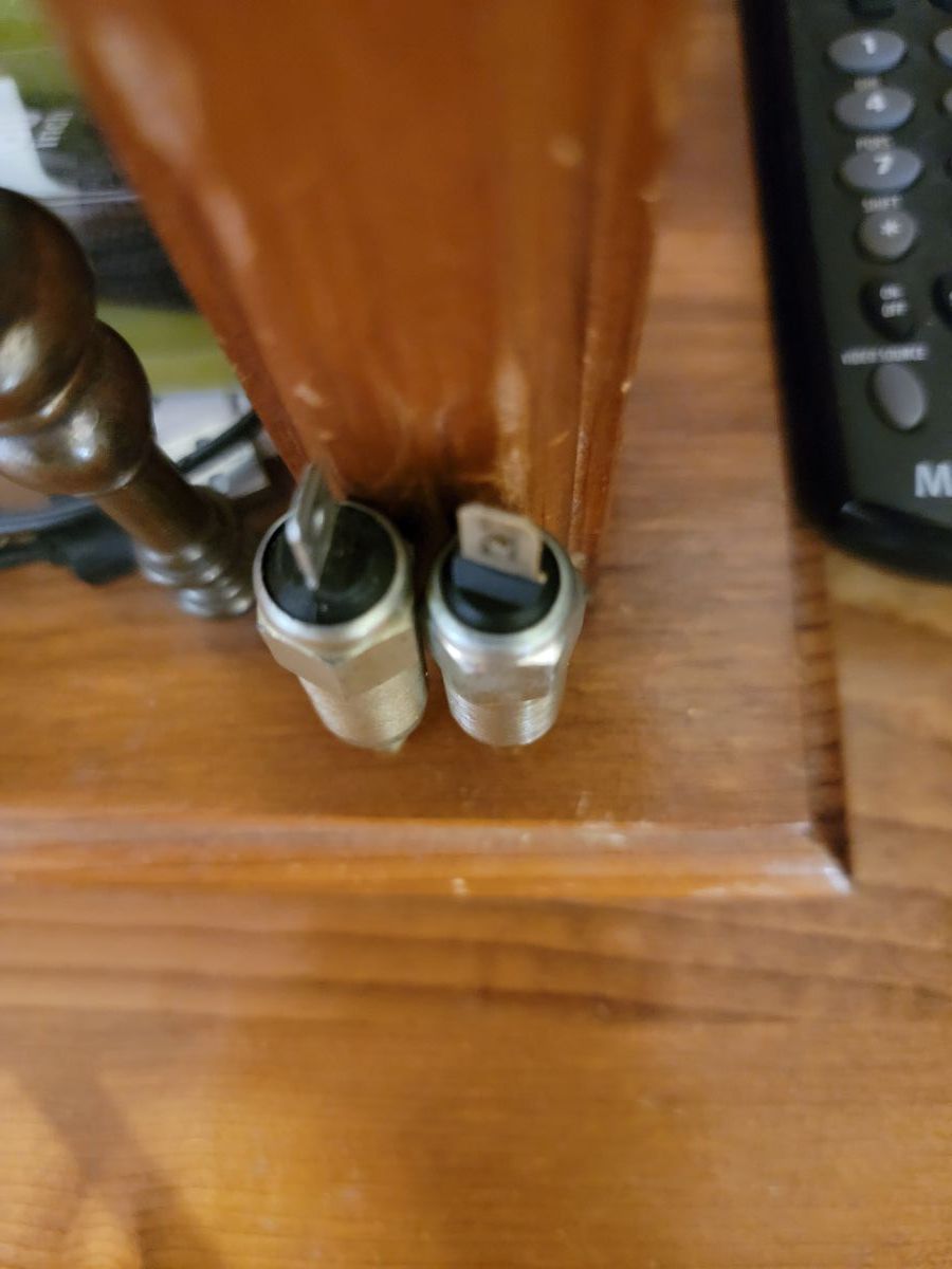

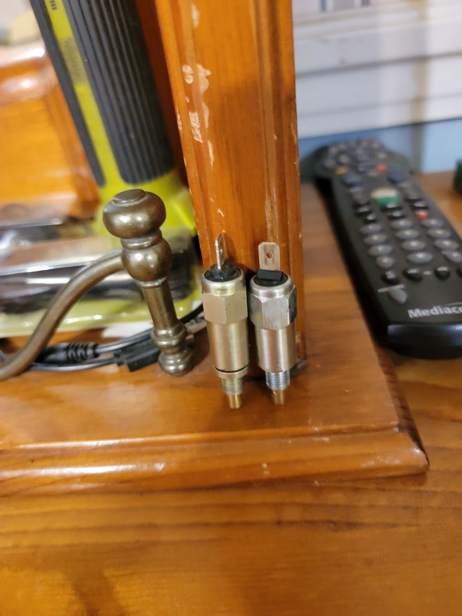

Thomas Perkins Posted July 17, 2025 Report Share Posted July 17, 2025 No,I first bought the Redline Weber one, it had to be grinded and it didn't work,I still have it.They now have a new part number for the Weber one.They are the same diameter.I will show a picture of them side by side.Also other people had to grind it with them.Long ago I have a carb direct Weber,but it was not the real one,had a sticker on the side with serial number on it,it came with the black choke.The real redline Webers come with the white chokes.I will show pictures when I get home from work.I am going to put my new float on today.The other Weber came with a Idle cut off solenoid .Back when 720 World was on line with Corey. Quote Link to comment

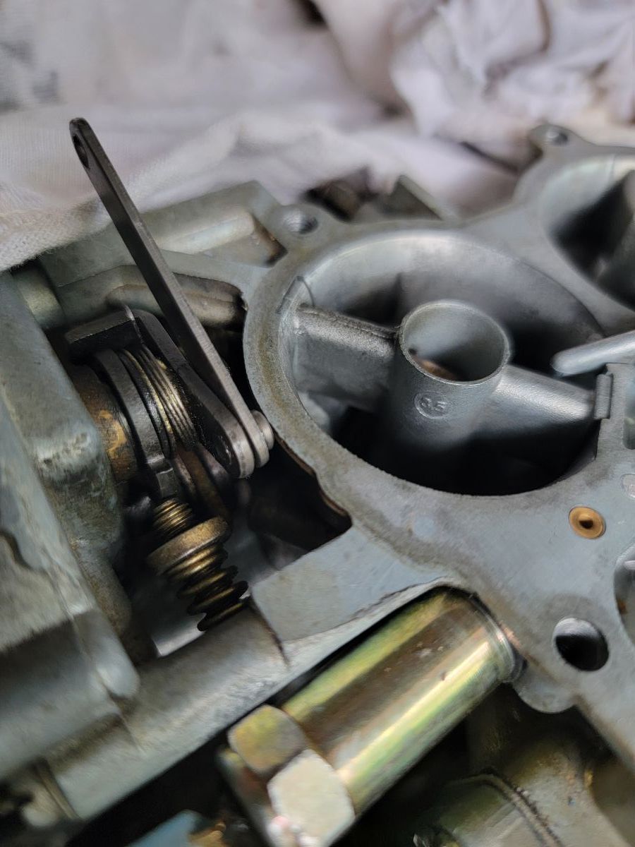

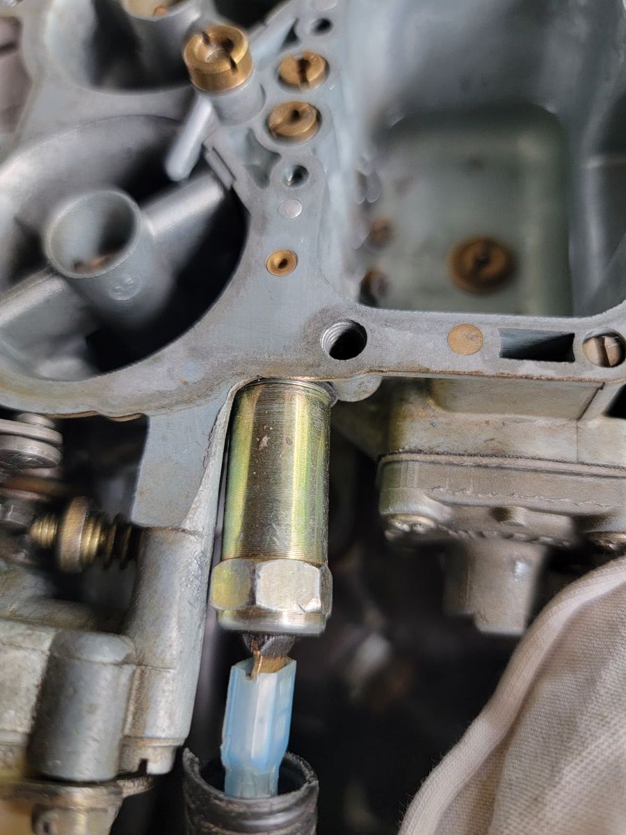

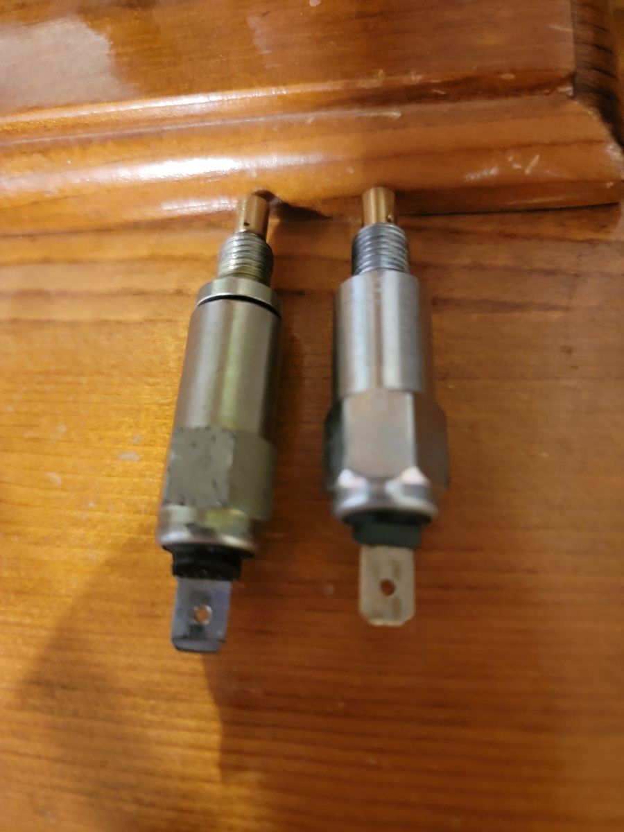

Thomas Perkins Posted July 17, 2025 Report Share Posted July 17, 2025 (edited) No Pine Cone.That will not work.Here is a picture of my choke off.You need to grind that part a little.You can use a hand file if you don't have a dremel tool.Here are both of my idle cut off solenoids.The Redline Weber is a little longer but the same diameter.The Redline is 9 years old.I could never get it to work.Wanna buy it lol.The solenoid that is gold and on the left side is the Redline one.I also have a brand new empi and a .60 big jet for a spare.If you were to take that piece off that choke goes into,then you would not get it back on.Time to Grind my friend.I am now taking the top part off to put the new float in. Edited July 17, 2025 by Thomas Perkins Quote Link to comment

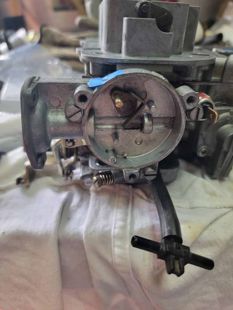

Thomas Perkins Posted July 17, 2025 Report Share Posted July 17, 2025 (edited) Pine clone.I just took the top off.See how tight the solenoid is.I can tighten it snug with my fingers. Edited July 17, 2025 by Thomas Perkins 1 Quote Link to comment

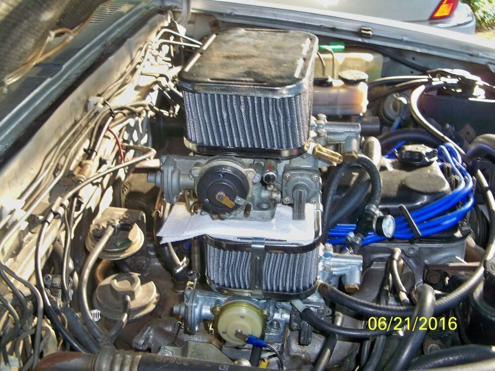

Thomas Perkins Posted July 19, 2025 Report Share Posted July 19, 2025 .The stock Nissan 720 carbs use a idle cut off solenoid.The first Weber like Carb I bought came with one.I even called them back then when I was having a problem.It was a Italian speaking guy.It was North American Carbs,Way before thr internet came out.Here is a picture of my old and new carb.The black choke is the non real Weber.It worked good.The Weber's with the white chokes are Genuine Redline Weber with part number engraved on the base.My non Weber had a sticker on it.I tried not using a solenoid on the new Weber and it would not stay idled.Another thing that may happen in time,the solenoid may come loose and make your Weber not idle. right.Use a o ring on the Empi type.I tried it without the o ring and it backed out.When tightening the solenoid,do it while engine is running to make sure you have it set right for it to idle perfect.What I do?The rpm need should be perfectly steady.No Weber gasket leaks too.I still use a Nissan 720 fuel pump. Quote Link to comment

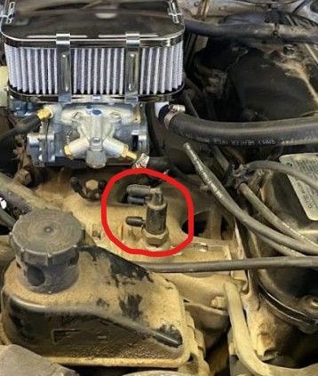

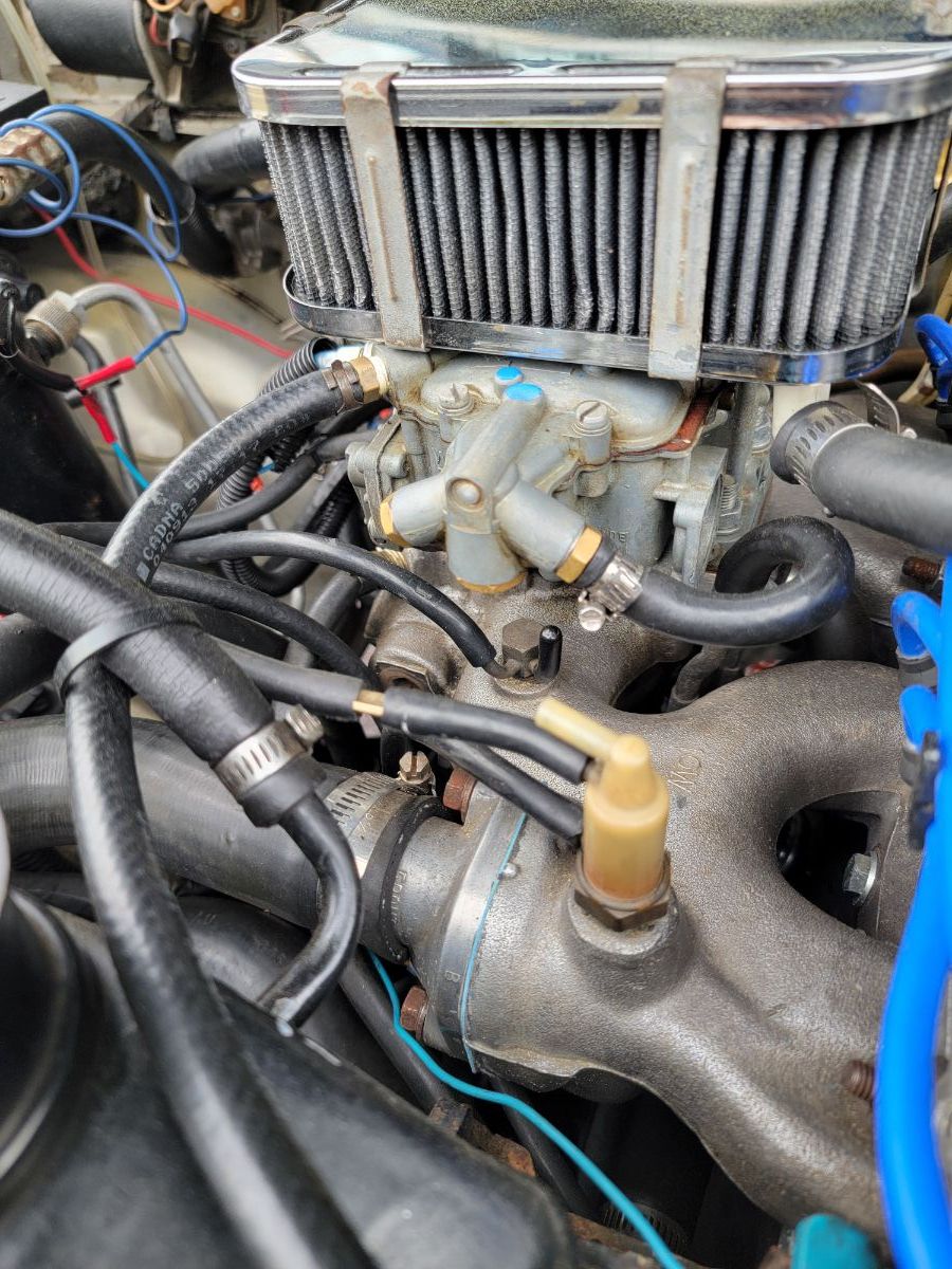

PineClone Posted March 10 Author Report Share Posted March 10 I have these ports capped, but they keep coming off. I'd like to remove it and permanently plug the hole like i have with some of the others, but haven't had any luck getting it loose. I've put some moderate pressure on it with a wrench and the nut wants to strip. I have been hesitant to get aggressive with it for fear of breaking something. Any pointers? Thanks in advance. Quote Link to comment
datzenmike Posted March 11 Report Share Posted March 11 That's a Thermal Vacuum Valve TVV. Just leave it. It's threaded into the cooling system. If you just have to break something, try when the engine is hot. 1 1 Quote Link to comment
TinKanTosser Posted March 11 Report Share Posted March 11 3 hours ago, PineClone said: I have these ports capped, but they keep coming off. I'd like to remove it and permanently plug the hole like i have with some of the others, but haven't had any luck getting it loose. I've put some moderate pressure on it with a wrench and the nut wants to strip. I have been hesitant to get aggressive with it for fear of breaking something. Any pointers? Thanks in advance. +1 on just leaving it, it can't give you a vacuum leak without any vacuum source hooked to it right? If you really want caps on it to protect it or for looks you could use some of those crimp-type hose clamps, they don't take up much space or look awkward. Quote Link to comment
PineClone Posted March 11 Author Report Share Posted March 11 (edited) Okay I'll leave it in place...that's the easiest solution and is low risk. However, I can always tell when one of those caps pops off because it idles rough.....so the caps are doing something. Edited March 11 by PineClone make better Quote Link to comment
Thomas Perkins Posted March 11 Report Share Posted March 11 I still have 2 connected to my vacuum lines.Top one is not capped off.That one goes to the air filter on stock carb.I did use it on my Weber long ago.Did not notice any difference?Been that way for over 10 years.Leave it un capped. Quote Link to comment
datzenmike Posted March 11 Report Share Posted March 11 5 hours ago, PineClone said: Okay I'll leave it in place...that's the easiest solution and is low risk. However, I can always tell when one of those caps pops off because it idles rough.....so the caps are doing something. No. If nothing is connected to the TVV it is impossible to affect the idle. The bottom of the TVV is heated by the cooling system. The top hose on the TVV goes to the air filter so only filtered air can be sucked into the TVV. The other two fittings go to the EGR and the vacuum advance/purge signal for the charcoal canister. When engine is cold the bottom two lines connect to the top and air enters and the vacuum signal is destroyed. As the engine warms up the two lines seal and a vacuum signal is sent tot the EGR and the vacuum advance. Thus on a cold engine there is no vacuum advance, no purge of the charcoal canister and no EGR. Both EGR and vacuum advance are ported vacuum source from the carburetor base. They are not connected to the intake vacuum. Instead the ports are above the throttle plate so when idling they have no vacuum signal. As the throttle is opened, the throttle plate rises above the two ports and some vacuum is felt and send down the hoses to the TVV. Obviously at heavy and full throttle the intake vacuum is close to zero and there is no need for vacuum advance of EGR. 1 Quote Link to comment
NC85ST Posted March 12 Report Share Posted March 12 If one of the caps pop off of the fitting just to the left and behind the fitting circled, yes it will run rough. The one circled has no affect, you can pull all the caps off. Quote Link to comment
Thomas Perkins Posted March 12 Report Share Posted March 12 I just took this picture of mine. Been like this for 10 years.That is how old my Weber is.Still use my vacuum lines. 1 Quote Link to comment
datzenmike Posted March 12 Report Share Posted March 12 Yup, best to keep all 'emissions controls' functional. 1 Quote Link to comment
