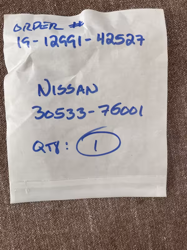

 The hole on the slave cylinder has a mate on the clutch arm. It is missing the clutch arm return spring.
