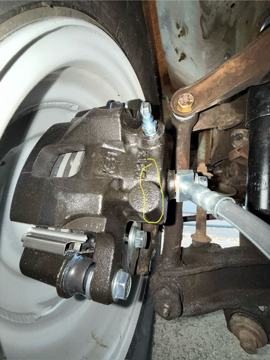

Slow Loris Posted May 4, 2025 Author Report Share Posted May 4, 2025 Put er in, seems to work great. Next brake leak question… After driving, a teeny tiny amount of brake fluid showing up on lower rump of calipers (both sides in front). I can only imagine it’s coming from the bleeder screw based on where it’s at. Note there is no fluid in this photo, but this is where it shows up. A little smear up in the top of the yellow area and a drop forming on the lower surface of the rounded edge down there. It’s weird I can’t ever see it really emanating all the way from the bleeder (or the banjo/hose area) just in the yellow area. I dunno if something else could be flinging fluid on it?? I’ll get a pic next time I see it. Anyway, if it’s the bleeders, and they are tight…replace the dang things I guess? Quote Link to comment
datzenmike Posted May 5, 2025 Report Share Posted May 5, 2025 Two ways to go here. It will likely just go away on it's own or it will get worse and you'll know for sure what is causing it. 1 Quote Link to comment
Slow Loris Posted May 5, 2025 Author Report Share Posted May 5, 2025 Both useful options. Well I’ll keep crawlin under there and lookin. Quote Link to comment
datzenmike Posted May 5, 2025 Report Share Posted May 5, 2025 Only till the source is obvious. I would presume the bleder but you never know. Quote Link to comment
Slow Loris Posted May 8, 2025 Author Report Share Posted May 8, 2025 Yeah it looks like there’s a tiny drop oozing out the threads of the bleeder. Was trying to find the right balance of tight but not thread-stripping tight. Will go a little tighter. Quote Link to comment
ggzilla Posted May 8, 2025 Report Share Posted May 8, 2025 You might want to remove the bleeder and inspect it, maybe there is a nick in the threads or something. Or in the end of the bleeder where it seals with the fluid passage It doesn't take much torque to install the bleeder. But after they been on for years, they might be real tight to come off again Quote Link to comment
Slow Loris Posted May 8, 2025 Author Report Share Posted May 8, 2025 I shoulda done it before I installed the calipers— these are a reman set, fresh off the shelf. But…I didn’t check. Yeah, ok, I’ll take it out and inspect. Quote Link to comment
