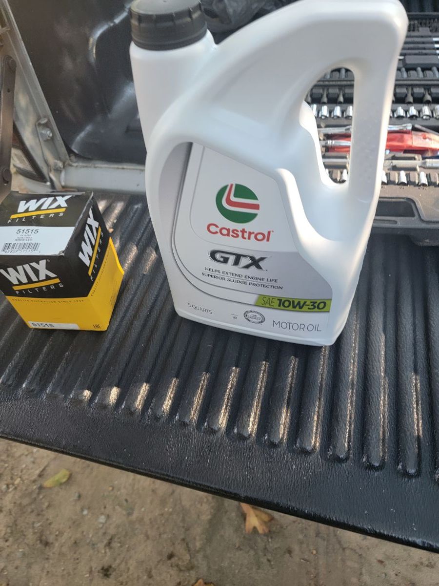

Thomas Perkins Posted April 9, 2025 Report Share Posted April 9, 2025 Castrol 10 W30 with Wix 51515 filter every 3000 miles.Works for me. 2 Quote Link to comment

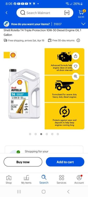

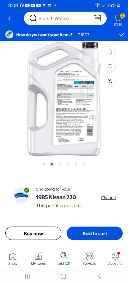

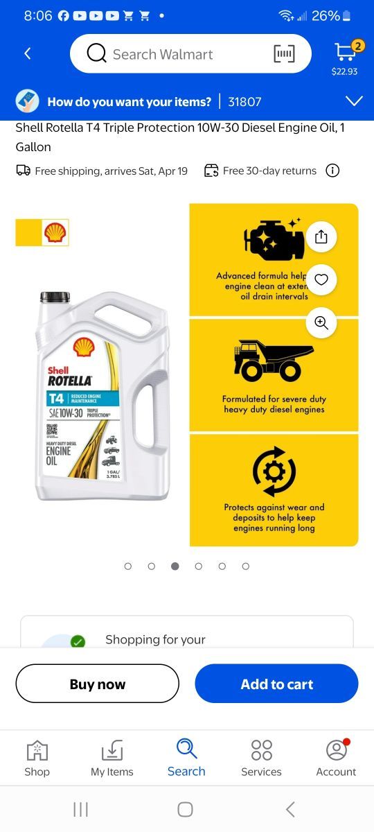

PineClone Posted April 11, 2025 Report Share Posted April 11, 2025 (edited) So, what is the answer here? What i'm hearing above is Shell Rotella 15-40 synthetic?? This is the same oil I'm using in my 2016 Chevy Colorado 4 cylinder diesel (although it is 5w-40). My "new" 720 is getting an oil change tonight if I have the time. From a previous thread here, I jotted down in my notes Shell Rotella T4 10W30 as the recommended choice (1985 Z24). Edited April 11, 2025 by PineClone Quote Link to comment
toshts Posted April 11, 2025 Report Share Posted April 11, 2025 2 minutes ago, PineClone said: So, what is the answer here? What i'm hearing above is Shell Rotella 15-40 synthetic?? This is the same oil I'm using in my 2016 Chevy Colorado 4 cylinder diesel (although it is 5w-40). My "new" 720 is getting an oil change tonight if I have the time. From a previous thread here, I jotted down in my notes Shell Rotella T4 10W30 as the recommended choice (1985 Z24). Consensus seems to be conventional for the 720 and that synthetic is overkill and unnecessary. Rotella t4 is fantastic and 10w30 is what was recommended originally Quote Link to comment

Thomas Perkins Posted April 12, 2025 Report Share Posted April 12, 2025 (edited) This says for Diesel engines.My FSM and manual does not say to use diesel oil.Also had a Jasper Engine installed back in 2009 and it has had nothing but Castrol 10W30 in it .Head has 396,000 miles on it,engine has 110,000 miles on it.Had 720 for 31 years.Will a Nissan Dealer put Shell in your 720 in a oil change.Call them and see what they say. Edited April 12, 2025 by Thomas Perkins Quote Link to comment
