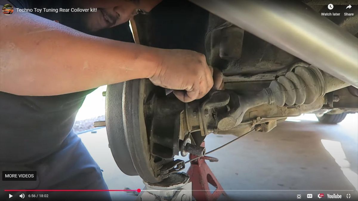

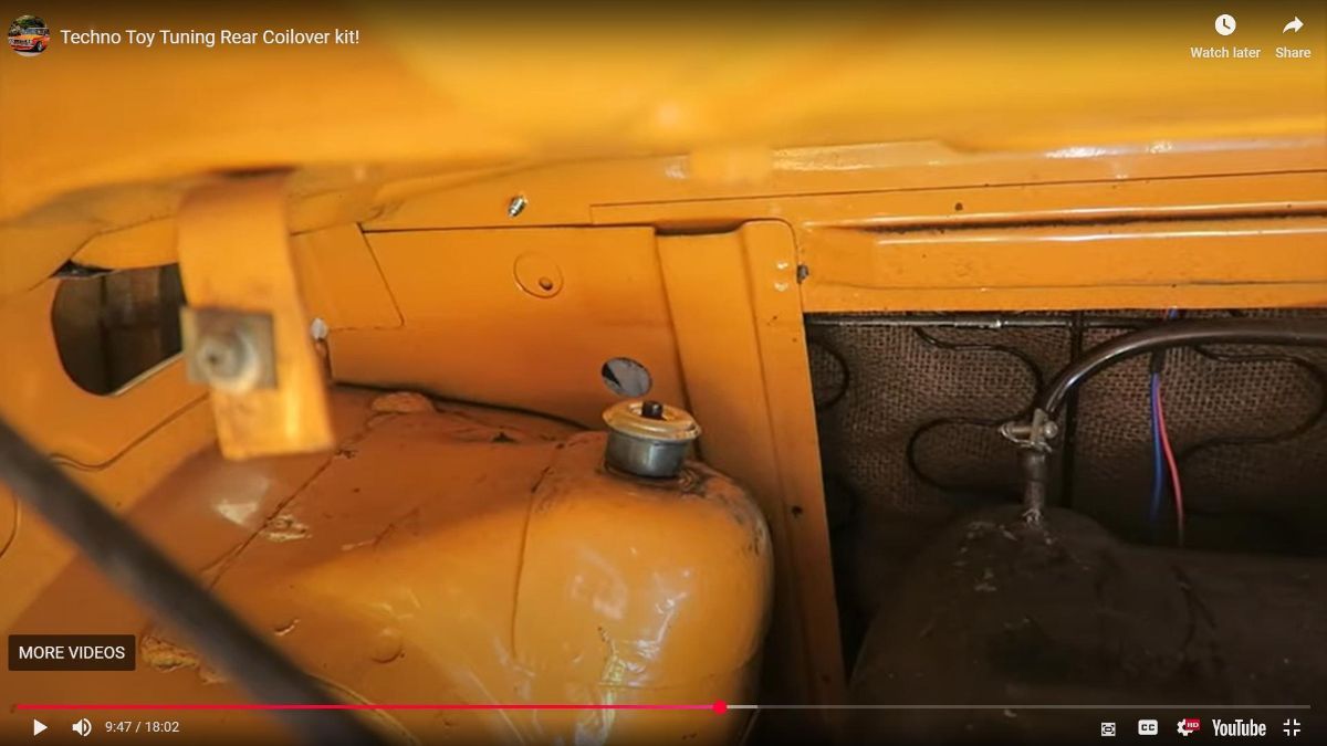

SeparateSteve Posted June 22, 2025 Author Report Posted June 22, 2025 On 6/20/2025 at 8:27 PM, datzenmike said: It's 3.8 not 2.8? Well that's memory for you. 800/3.8= 210 lb./in. I would go with this and see how it handles first. You can raise the spring rate by shortening it further. Well you can always shim a short spring. That's the near-term plan. See how it rides, then cut or buy some 3" ID shims under the top hat. I did have a question about the conversion coil overs. Has anyone ever report shearing off the little mount on the rear arms? I wondered how strong those tabs are, since now the force from the wheel goes directly thru that mount, which was never meant to carry the spring force.. Quote

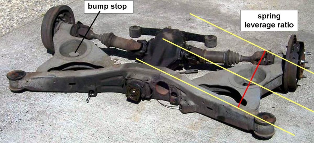

ggzilla Posted June 22, 2025 Report Posted June 22, 2025 44 minutes ago, SeparateSteve said: I wondered how strong those tabs are, since now the force from the wheel goes directly thru that mount, which was never meant to spring the spring force.. The aftermarket coilovers bolt to the shock mounts * The bottom shock mount is a tubular bracket in the lower control arm * upper shock mount is the body sheet metal * Neither were designed to take the full weight of the vehicle, that's the job of the bump stop. However, both are reinforced parts 1 Quote
datzenmike Posted June 22, 2025 Report Posted June 22, 2025 This is true but have never heard of a failure. Weld in some strength if for nothing but some peace of mind. Got any numbers? I see the mechanical advantage squeezing the spring but not the 3.8 Quote
ggzilla Posted June 22, 2025 Report Posted June 22, 2025 Is 3.8 the ratio you heard? I heard 2:1, but i've never seen any numbers, and the photo looks bigger than 2:1. Somebody should measure the two distances Quote
datzenmike Posted June 22, 2025 Report Posted June 22, 2025 I posted 2.8 from memory but it turned out to be 3.8, I guess. If the distance from the hinge point is 6" then it's 1 to 1. If increased to 12" it would double to 2X. Could the longer red line be 1.4 times the shorter line? That would make it 2.8 X. Quote
