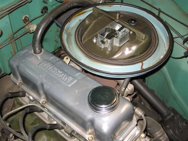

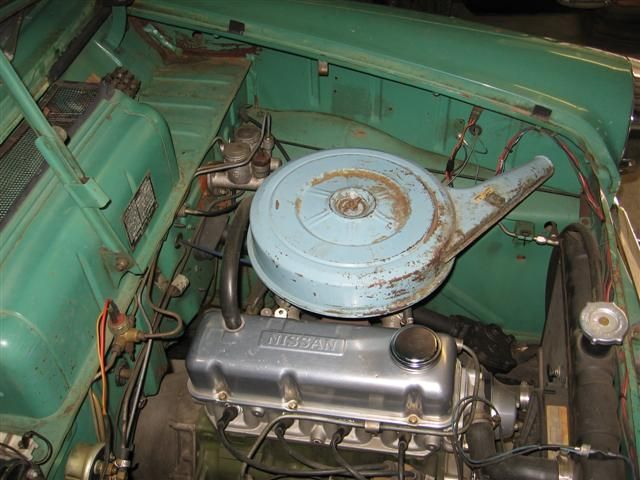

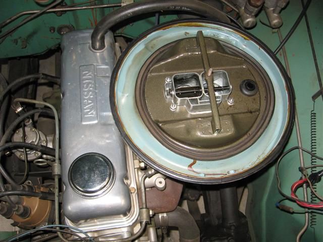

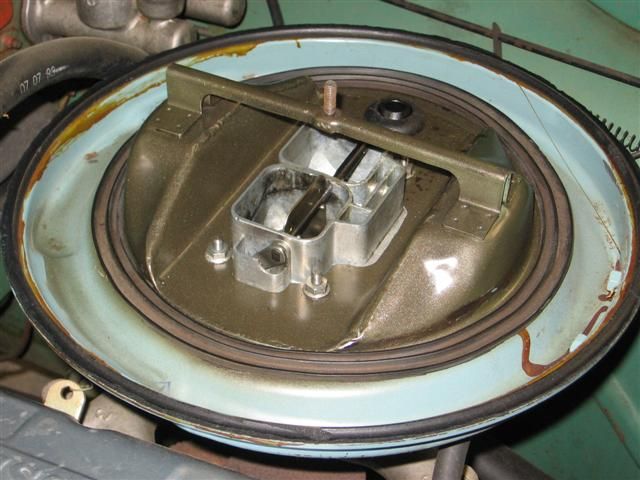

Stoffregen Motorsports Posted May 10 Report Share Posted May 10 11 hours ago, Stinky said: Somewhere on here is a guy's post where he made an adapter and then welded it into the stock air filter. I took a gasket to a place that does water-jet cutting. They cut out the gasket, but w/a circle around it. The circle is, about, 5-6 inches. I plan to cut the center out of my housing and then weld it in. This will give me a real air filter and a cold air intake. This is one that I made for my 320. 1 Quote Link to comment
