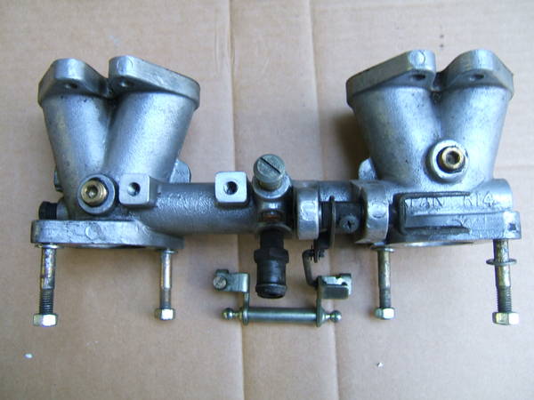

You either have the much earlier SU intakes of the 240z or a custom one. If the 240z intakes, only the throttle chambers are warmed by coolant and there is no flow out of the head itself or through the intake runners. You have it connected properly but the coolant flows from the thermostat housing back to the front manifold just behind the SU, then to and through the rear intake manifold again just behind the SU and out the rear side around the back of the head and is connected to the lower radiator hose inlet to the suction side of the water pump.
It should be noted that this hot water from the thermostat is being directed back into the water pump inlet at the lower radiator hose without the benefit of passing through the radiator and being cooled. Effectively you are by passing hot coolant past the radiator increasing it's work load on the coolant that does. I would not doubt that the engine will run slightly warmer with this system connected. Possibly the 240z system has a restriction in the return line to limit the flow? Maybe a shut off valve for very warm weather when the warming of the throttle chambers are not needed? Have it operational during cold weather. Or adjust the flow so the temperature does not rise?

Coolant in the manifold is below runners, so doesn't negatively affect airflow like hot air intake does, but instead aids in proper atomization for more power. The cold climate thing comes into play with the air temp and is why the twin carb air cleaner had a hot air tube to prevent carb icing during winter
215 in the intake manifold sounds high. Maybe the outlet is blocked

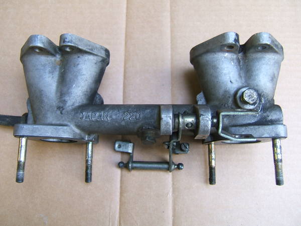

Datsun 220 manifold has an outlet at the front end and inlet at the cylinder head face
Datsun K14 manifold has water connections on both(?) ends of manifold. Not sure how that one is plumbed
