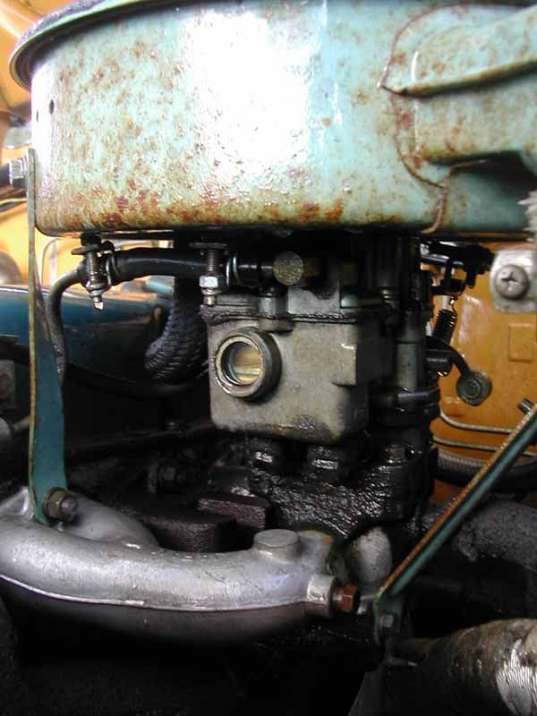

datzenmike Posted March 13, 2025 Report Posted March 13, 2025 Said it does it on inclines where the demand for fuel is higher than normal. You would have to almost empty the tank for the pump to not be able to suck fuel out of it against the vacuum. This is part plugged line, dirty filter or filter on the carburetor inlet banjo fitting, or the float is set too low. The breather and the fuel line are both mounted higher on the tank. The return line lower down. If there is a clamped hose look around for the hard line it was connected to. Look at the front of the carburetor, it should have a small sight glass showing the fuel level. Normally it will be in the middle. If low then the float is set to low and needs adjusting. If normal then it's a delivery to the carburetor problem. 1 Quote

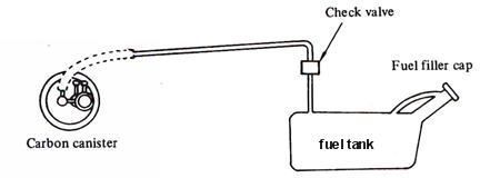

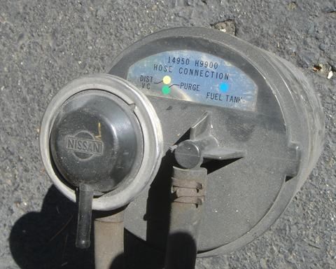

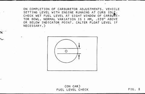

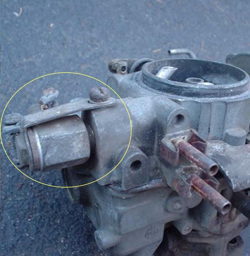

ggzilla Posted March 13, 2025 Report Posted March 13, 2025 Yes, it could also be the float level. If set low, the engine can still run, but when the engine is working harder, requiring more flow it could starve. Itis SO EASY TO CHECK that I always start with this visual inspection: If the fuel level is within 1mm of the dot, it is already at the correct adjustment This one is too low AAAND it may still have an original sintered brass filter in the carburetor inlet. That works just like a fuel filter and over the decades can plug up. Just remove it, and change the regular fuel filter once a year the vent line is crucial, not sure if it would cause a problem solely on inclines, but it can starve the engine after running long enough to evacuate the tank of air. USA fuel tanks since at least 1971 were not vented at the cap, but only through the vent line up to carbon canister which is in the engine compartment 1980 B310 (210) canister Quote

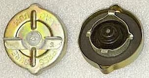

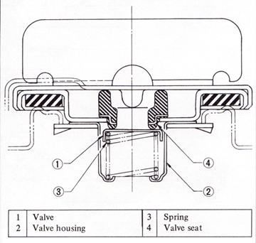

ggzilla Posted March 14, 2025 Report Posted March 14, 2025 Thanks, that reminds me. The fuel cap is supposed to have a vacuum relief. So hydrocarbons can't get out, but if the tank is subject to vacuum, it lets air in. If someone has replaced the cap with a solid one, the tank can implode, or the engine stall. Ive seen this more than once Bottom line: check the cap to make sure It should be more or less flat on the outside, with a nubbin on the inside Testing You should not be able to blow air out throw the cap You should be able to suck air in through the nubbin Wipe valve housing clean and place it in your mouth. Inhale air. A slight resistance indicates that the valve is in good mechanical condition. Note that, by further inhaling air, the resistance should disappear as the valve clicks. If valve is clogged, or if no resistance is felt, replace cap as an assembled unit. 1 Quote
Gussy Posted March 14, 2025 Author Report Posted March 14, 2025 @datzenmike has to be delivery to carb in my case because the fuel level in the sight glass is right in the dot until it shuts down on inclines. I wanna rule out the lobe on the cam that operates the fuel pump is worn since the car only has 48k original miles on it. I did blow out the lines and I'm getting some gunk coming to the filter so I'm gonna change filter out and see how the car operates. As far as the clamped line, I cannot find a hard line where it would connect to. I'll keep you guys posted on results. Appreciate all the feeback. Quote
