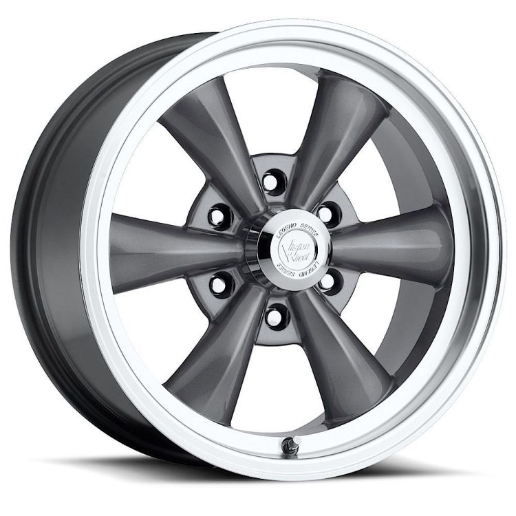

Stock rims are what? 4.5" Get a 6" set. If going for looks get a pair of 4.5" for the front and a pair of 8" for the rear. The smaller fronts will make the rears appear huge.
that's what i was thinking. stock is 4 or 5" wide
but those Vision wheels are a legend. Surely with spacers and baja flares it would be worth it. Magnificent
vision_141_legend_6_gunmetal_machine_lip_6_lug_17x8_std_1000.thumb.jpg.4e69aacf7b68cb785dc3c05925ef0b2a.jpg
8” is fine as long as you have negative offset to get the wheel away from the tension rods when turning all the way. If they’re 8” wide and 0 offset, you might have rubbing issues when turning. Of course, you can always add spacers.
17" is too donk for me. If you know the 521 stock tires, larger rims with 2" 'rubber bands' seem odd. They don't fit the wheel opening properly. Reminiscent of a Cragar five spoke mag.
