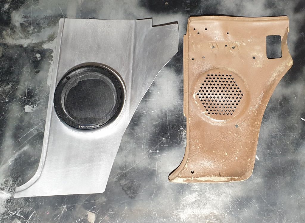

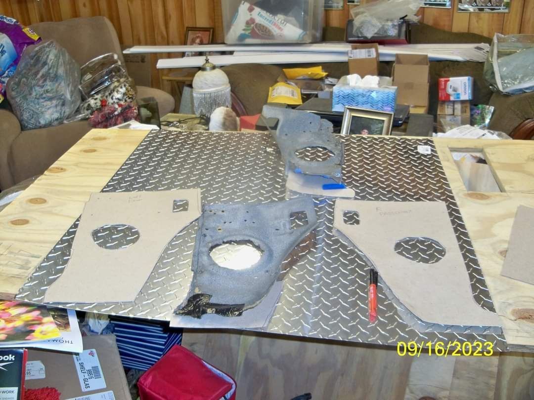

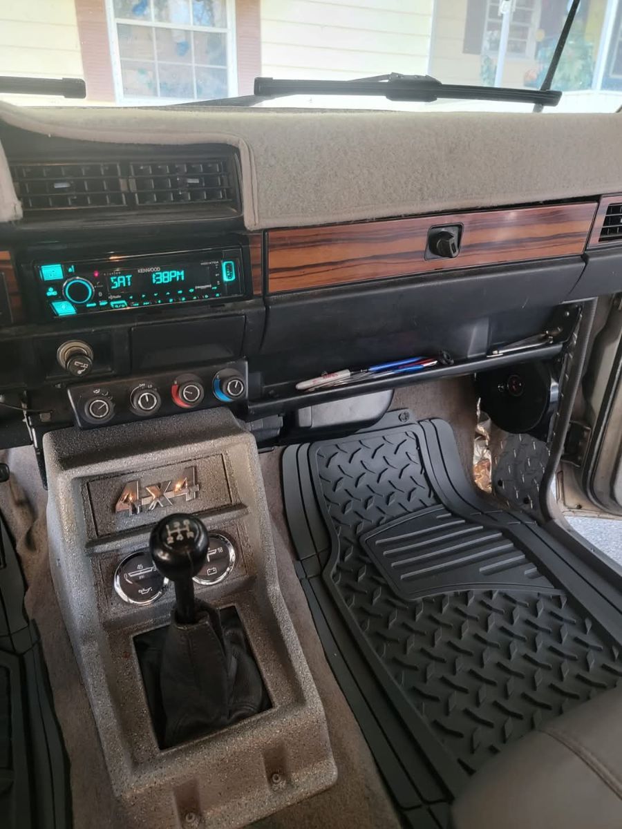

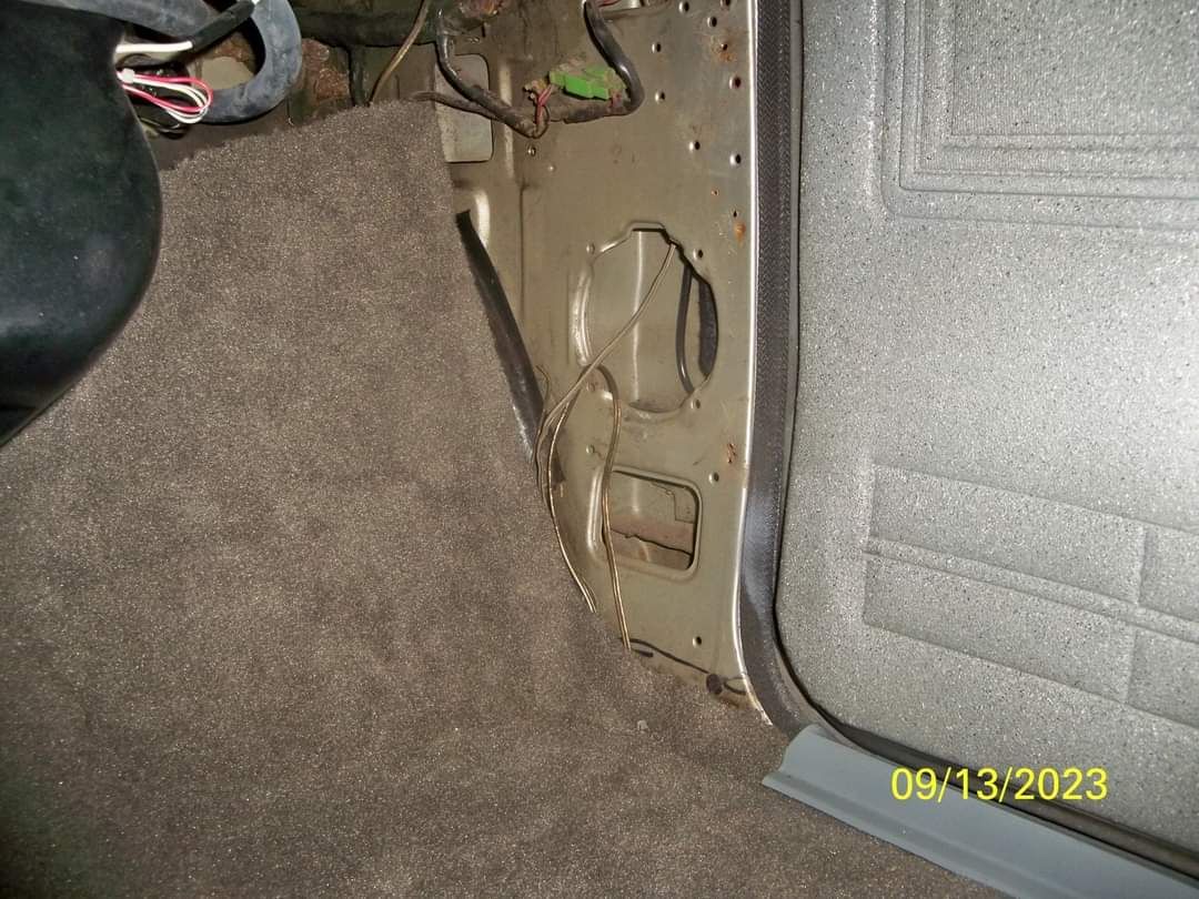

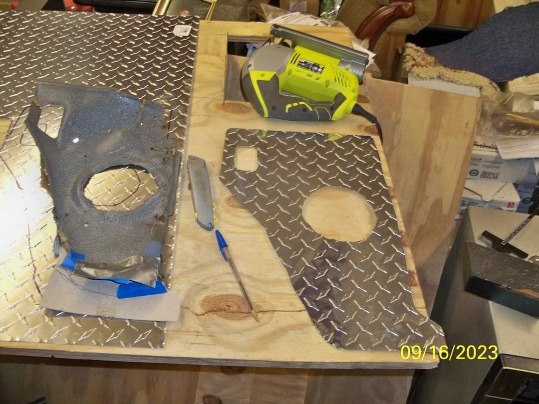

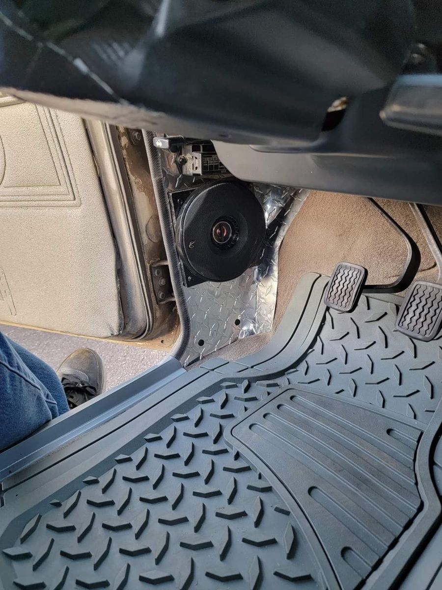

Thomas Perkins Posted February 26, 2025 Report Share Posted February 26, 2025 (edited) If you want to make your own kick panels.Here's how I made mine.On my 85,the original ones were made of cheap chip board.Similar to thick cereal box.I found some Diamond plate sheets at Lowe's for a little over 50 dollars for a 36×36 inch sheet.Tractor supply has them also but cost more.I used my jig saw to cut them.Better than snips.I took the old ones off and traced onto Diamond plate.I did make them longer to cover more of the carpet.At the same time,I put new carpet in it.The Diamond plate needed to be longer to cover the carpet.I have 6.5 inch speakers in them.I have a 1/2 thick piece of wood behind the speaker cause the hole in the side is not big enough for the back of the speaker to go in.The hole is made for smaller speakers.The guy that sold the truck to me made the wood.He also had 6.5 inch speakers in it.You can't let the metal on back of speakers to touch metal frame or stereo won't work.My Kenwood will tell you that you have a bad connection.So I put a piece of plastic in back on speaker. Edited February 27, 2025 by Thomas Perkins 1 Quote Link to comment
ggzilla Posted February 27, 2025 Report Share Posted February 27, 2025 9 hours ago, Thomas Perkins said: If you want to make your own kick panels.Here's how I made mine.... Hey that looks good. And will probably still look good 10 years from now! 1 Quote Link to comment

Thomas Perkins Posted February 28, 2025 Author Report Share Posted February 28, 2025 Here are some like mine made out of that cereal box.Mine had the center cut out. Quote Link to comment

ggzilla Posted February 28, 2025 Report Share Posted February 28, 2025 18 hours ago, Thomas Perkins said: Here are some like mine made out of that cereal box.Mine had the center cut out. Thomas, are both of those made out of the cardboard-like pressboard? If so, painting it silver looks pretty good! I know all automakers used pressboard at the time so it was a valid choice of material, but it always end ends up scuffy-looking like that brown one ... not a great choice for a kicking panel! 1 Quote Link to comment
Thomas Perkins Posted March 1, 2025 Author Report Share Posted March 1, 2025 No,just the one on the right.The other one is from a site selling them.Probably aluminum. Quote Link to comment

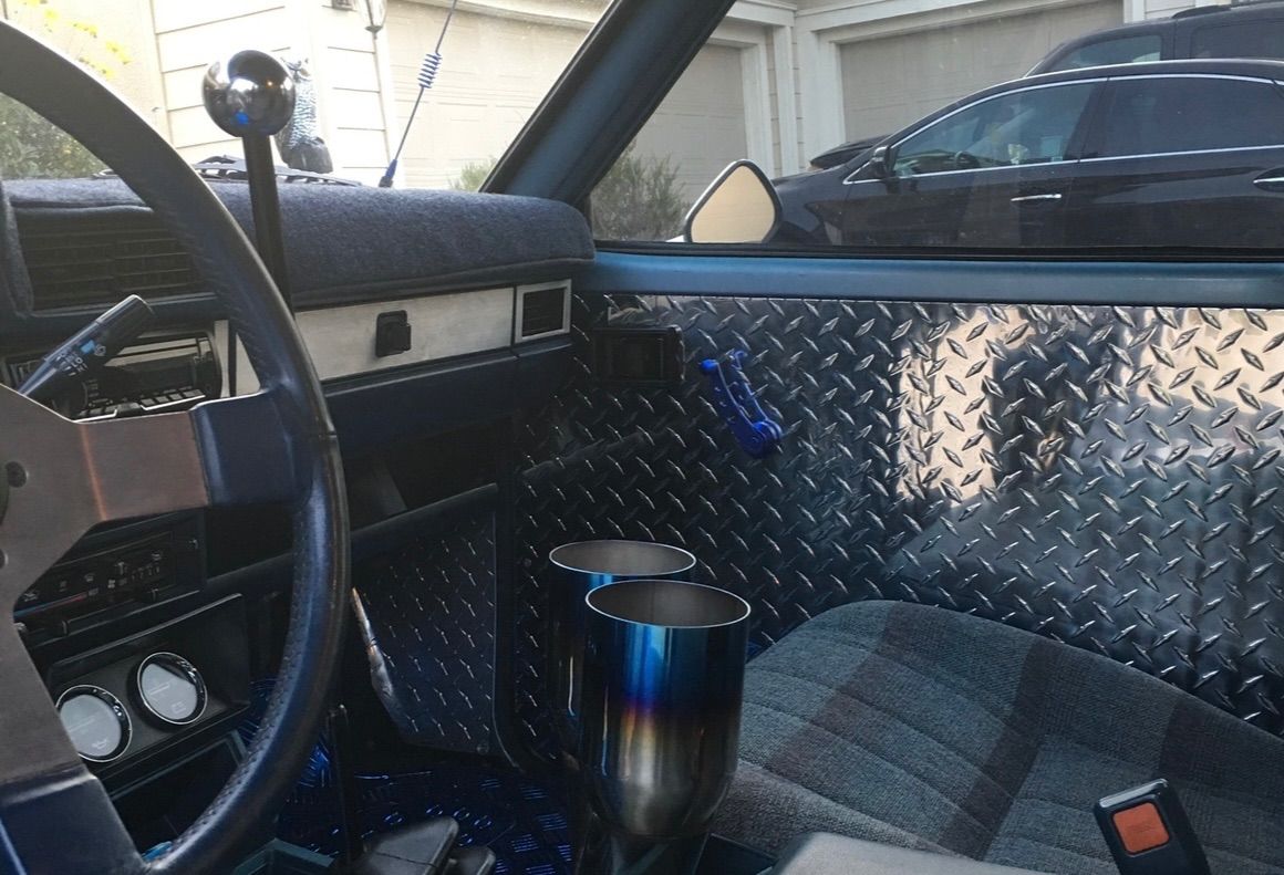

7twentyguy Posted March 3, 2025 Report Share Posted March 3, 2025 I went to the local auto parts stop and bought a pair of aluminum diamond plate mud flaps! Their already the right shape Only minor trimming 2 Quote Link to comment
