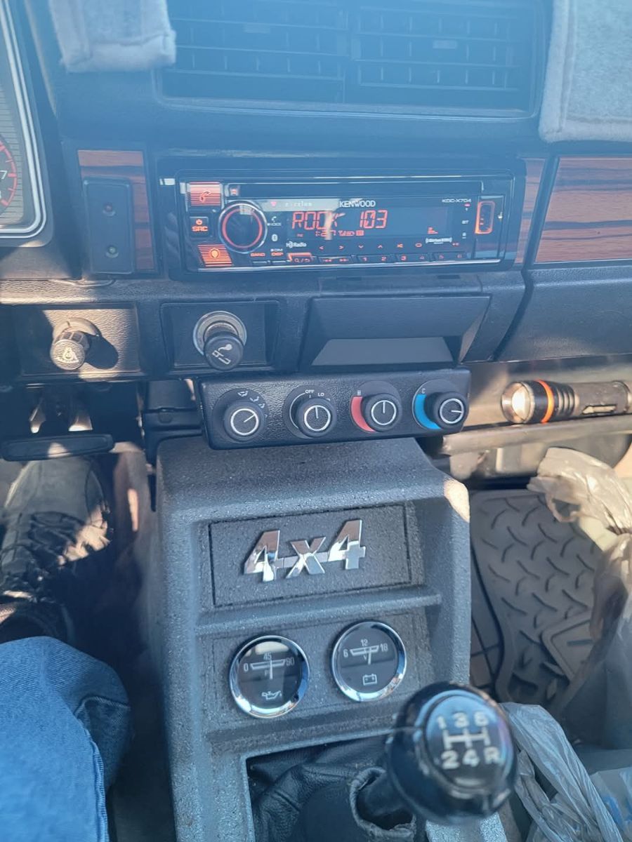

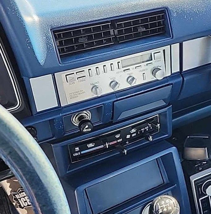

PineClone Posted February 23, 2025 Report Share Posted February 23, 2025 (edited) Has anyone done a clean looking replacement of the stock stereo in a '85 720? I tried installing a stereo in my B210 and the opening wasn't deep enough so we ended up cutting a new opening in the console below. I'm not really interested in doing that if at all possible. Also, how hard is it to remove the stock stereo? Follow-up question...is this actually the stock stereo (attached photo)? I am able to find only one hit on Google for a stock 720 stereo that looks like this one and it is on Ebay. Follow-up follow-up...What is the blank for above the two gauges (below the climate control) on the center console? Thanks. Edited February 23, 2025 by PineClone adding question Quote Link to comment
NC85ST Posted February 23, 2025 Report Share Posted February 23, 2025 Yes, the stereo is stock and yes you can install an aftermarket stereo. The opening will require a little filing to get it to fit. Just test fit as you go. 1 Quote Link to comment

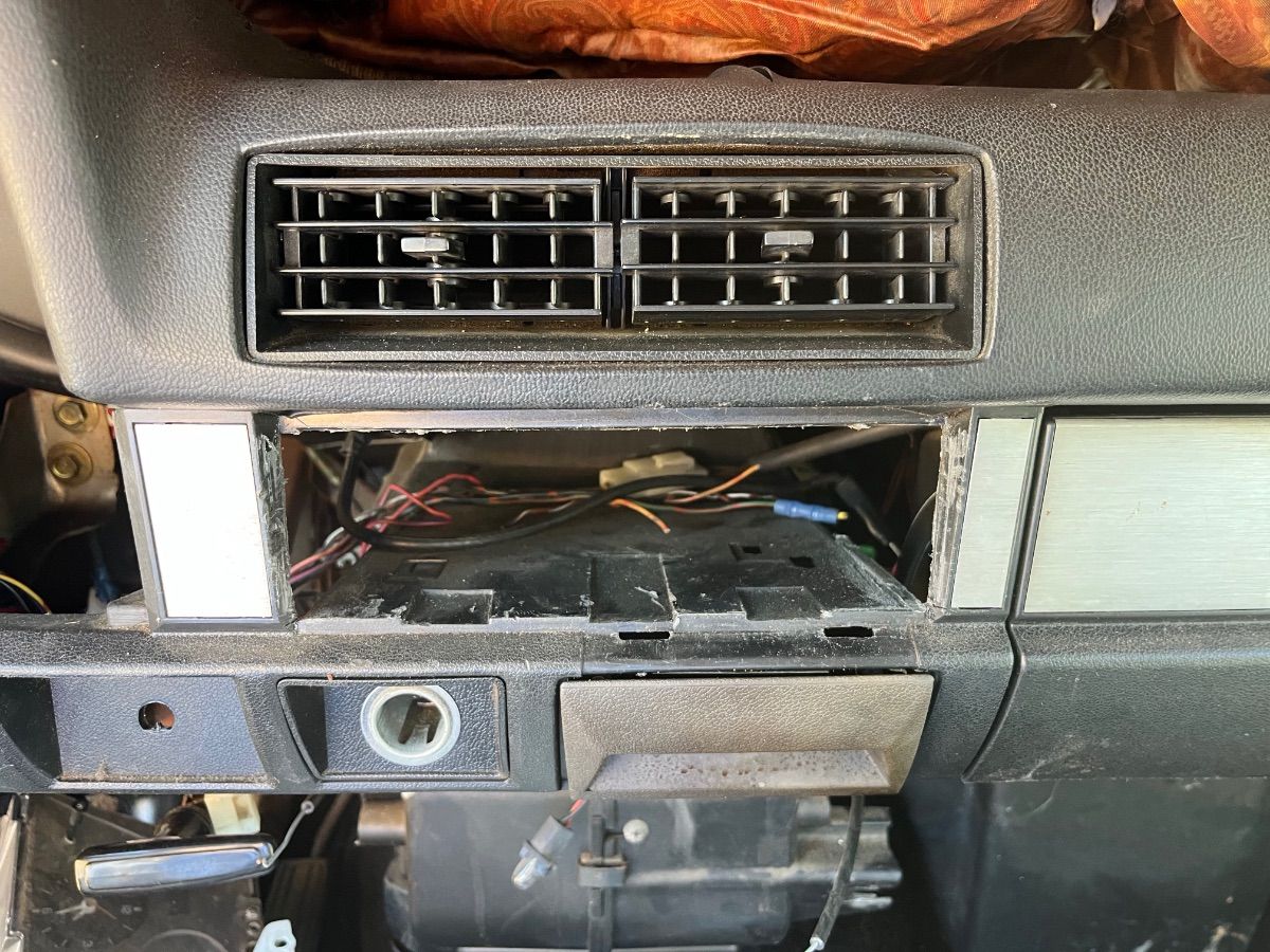

NC85ST Posted February 23, 2025 Report Share Posted February 23, 2025 Here’s a shot of my ‘85 2wd ST radio slot. 1 Quote Link to comment

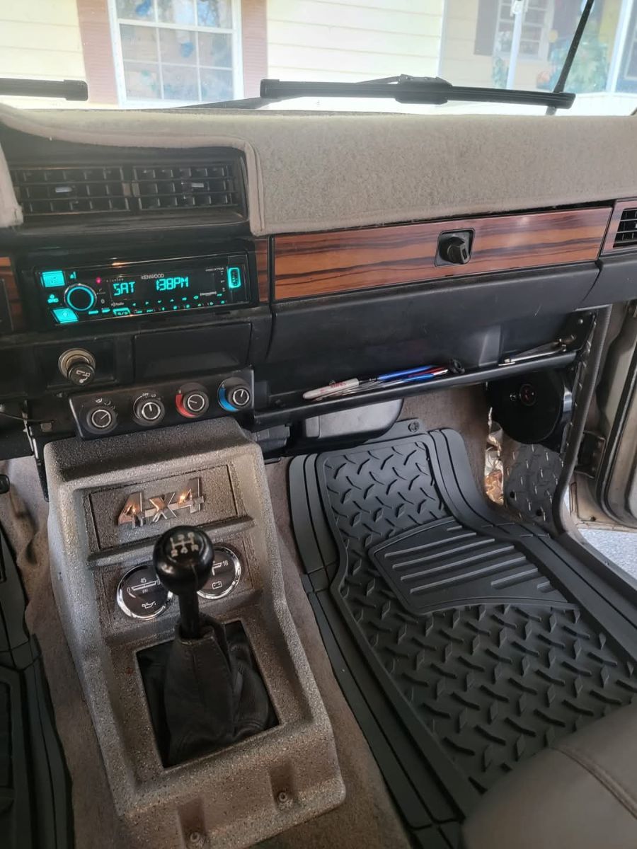

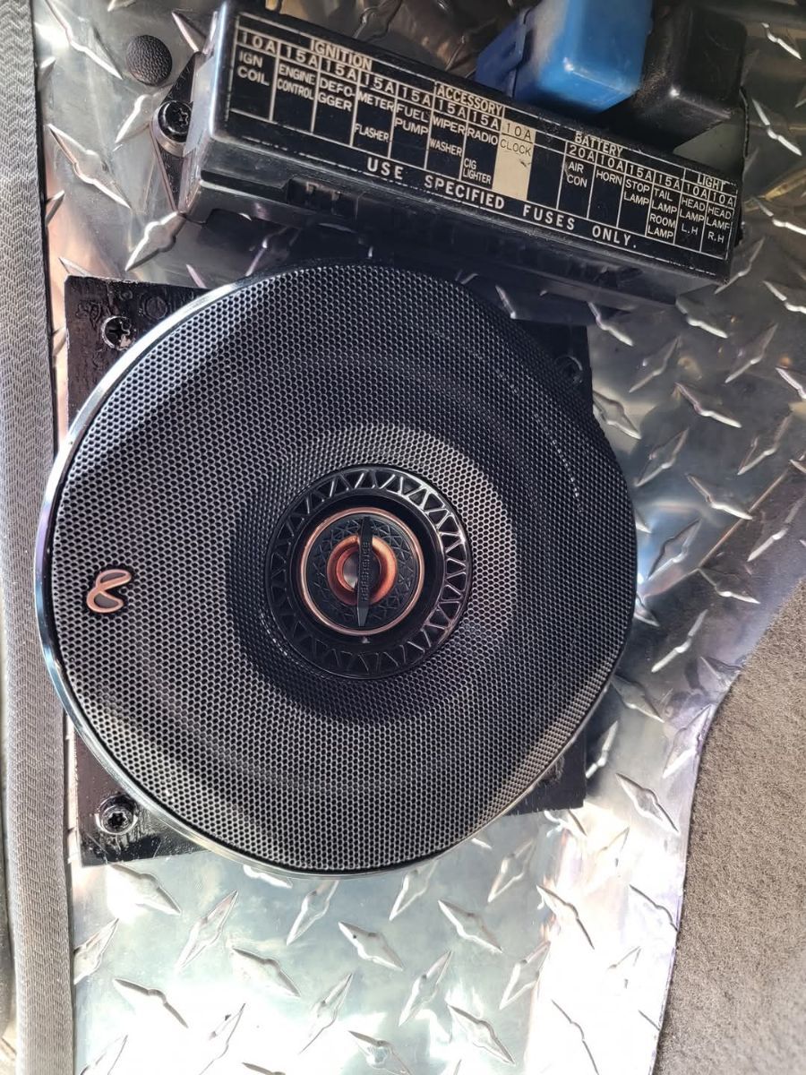

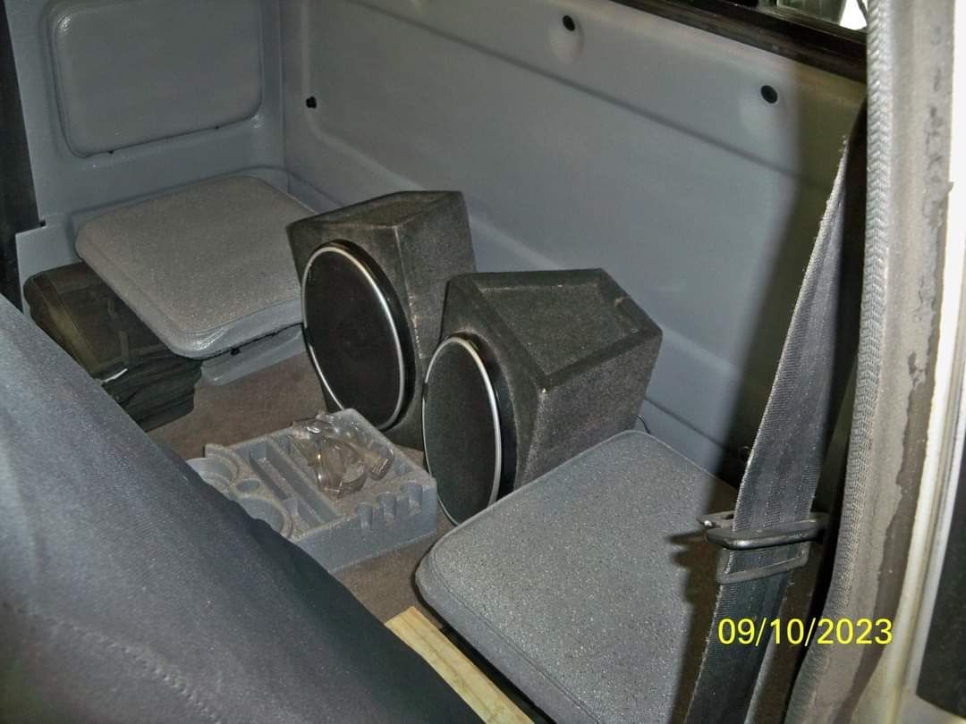

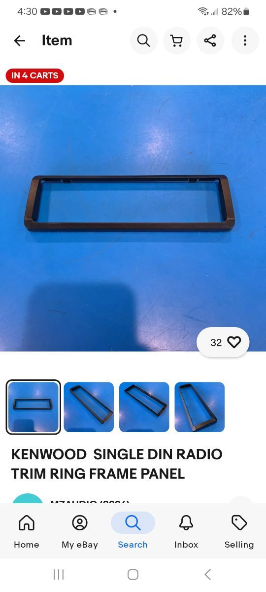

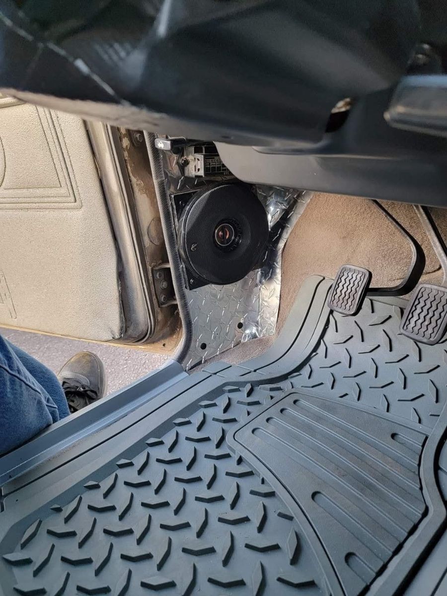

Thomas Perkins Posted February 23, 2025 Report Share Posted February 23, 2025 (edited) Here is my Kenwood KDC-X704.I also have a trim ring around it that covers the opening.I had a Stereo shop install it.I also added XM Radio to it.Stereo's don't cost much.This one was 150 bucks and 40 for the XM radio add on.They put 6.5 in speakers in the kick panels I made and 6x9 in my boxes in the back between the seats.I also had them put a new antenna cable in too. Edited February 23, 2025 by Thomas Perkins 1 Quote Link to comment
junkafide Posted February 23, 2025 Report Share Posted February 23, 2025 30 minutes ago, Thomas Perkins said: Here is my Kenwood KDC-X704.I also have a trim ring around it that covers the opening.I had a Stereo shop install it.I also added XM Radio to it.Stereo's don't cost much.This one was 150 bucks and 40 for the XM radio add on.They put 6.5 in speakers in the kick panels I made and 6x9 in my boxes in the back between the seats.I also had them put a new antenna cable in too. I have Kenwoods in 3 of my cars, and each of them came with that trim ring. Great units. 1 Quote Link to comment

720_Jeff Posted March 22, 2025 Report Share Posted March 22, 2025 (edited) As others have said, that is the stock ST stereo. There is one screw in particular that is difficult to get at. It is in the rear, has to be the underside of the stereo. It is very challenging to get to from the front. Many, will remove the dash to give much easier access to that screw. This is especially true when pulling from the junk yard. Edited March 22, 2025 by 720_Jeff 1 Quote Link to comment

Thomas Perkins Posted May 30, 2025 Report Share Posted May 30, 2025 Stereo's don't cost much now.I Have a Kenwood -KDC-X704 with blue tooth,you can change the colorbof the face to about 20 colors..I have 6.5 speakers in the Kick panels and 6x9's in the boxes.My last Kenwood lasted over 20 years,wanted blue tooth so I got this one.Was only 150 dollars.Also got the XM kit. Quote Link to comment

PineClone Posted May 31 Author Report Share Posted May 31 Following up with my stock stereo removal experience... First, most of my research indicated that in order to remove the stock stereo, one would need to remove a single screw that requires significant bodily contortions in order to get access to it. Definitely now what I encountered. The stock Clarion on the '85 ST has two screws. One directly above the ash tray, and another directly above the cigarette lighter. The one above the ash tray is easy to remove if you just use a small ratchet wrench with a Phillips bit. The other screw requires removal of the cigarette lighter and you can remove it with a long(ish) screwdriver. Stereo slides right out. Interestingly, the stereo in my pickup has a "REFURBISHED" sticker on it. Wondering if that came from the dealer that way or...???? I had no idea this would be this easy. Now i'm going to have to get online and order a stereo and speakers. Planning on replacing the two that are in the floor, and adding two in the back...location TBD. I'm not interested in free-standing speakers in a box. Probably will use the location of the jump seats, since the previous owner did away with them. I'm liking the idea of the Retro Manufacturing option as shown in this Nissan 720 conversion. Quote Link to comment
