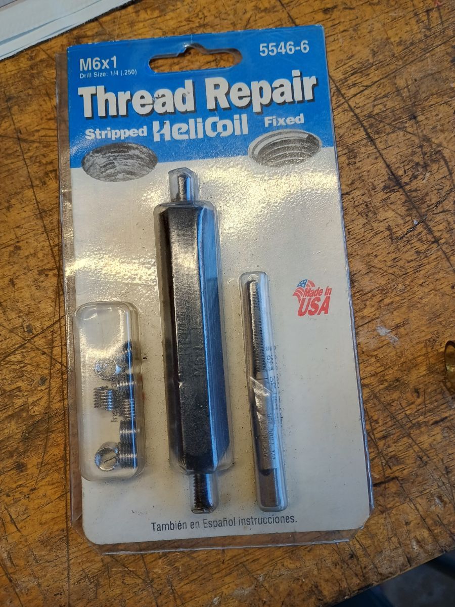

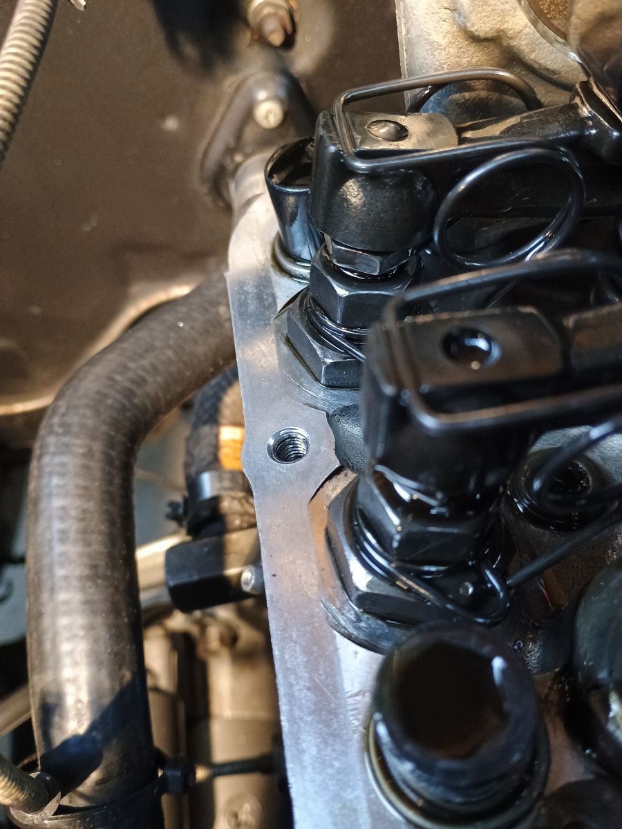

Had to install a heli-coil for the RR cam cover bolt hole to stop an oil leak.
Edited by Tedman

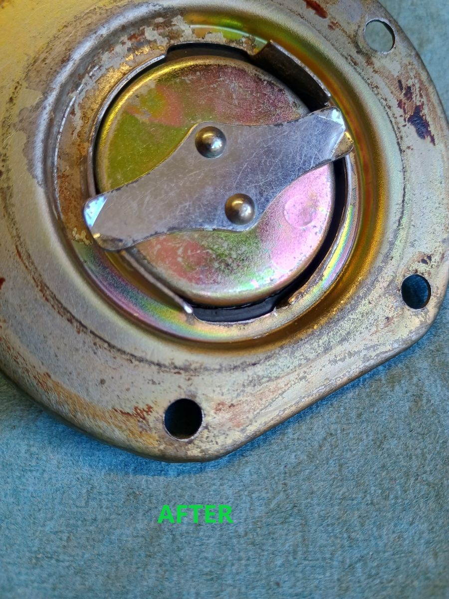

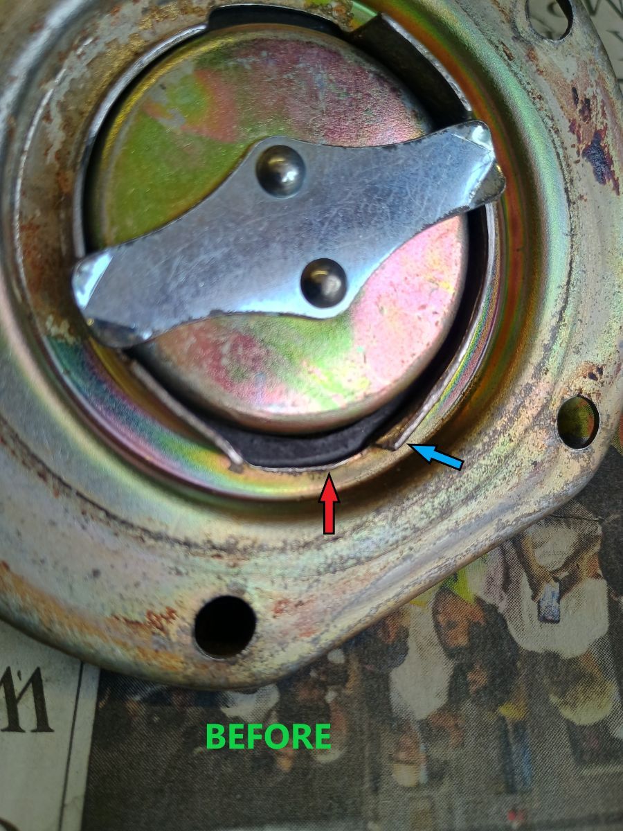

After fussing with several gas caps and home-made gaskets, I finally traced the fuel cap leak issue to deformations in the filler flange. Fortunately, I was able to re-form it back into a shape that would form a seal.
Edited by Tedman
