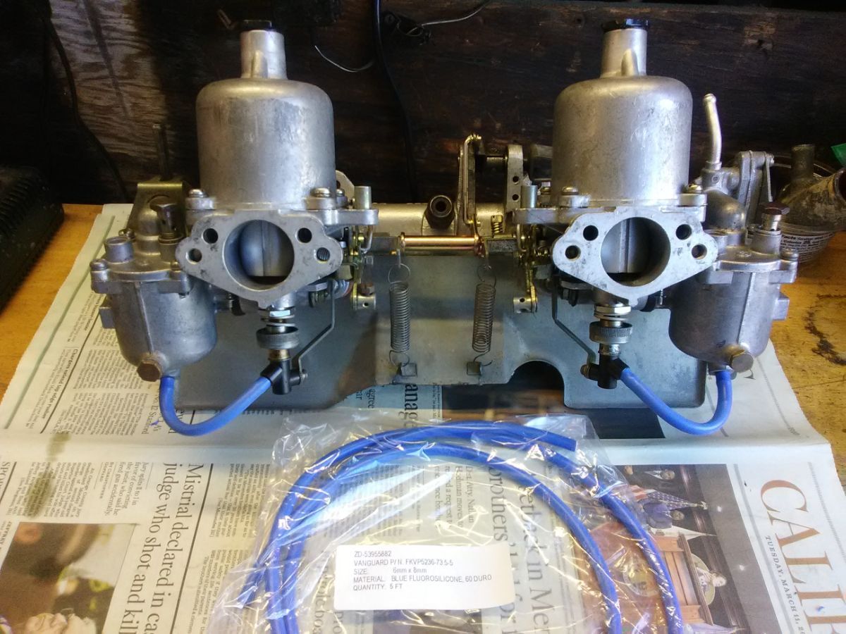

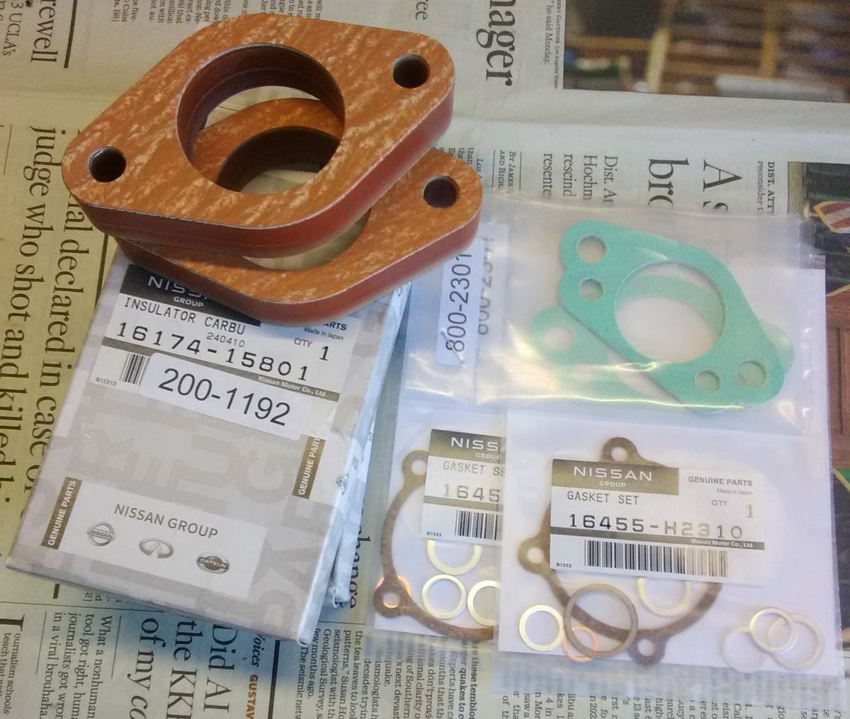

Tedman Posted March 14, 2025 Author Report Share Posted March 14, 2025 Muttley gets a nicer, freshly scrubbed cam cover, and a new, taller, air cleaner. Woof! I have been refurb'ing this set of SSS SUs for a future Muttley induction upgrade. Some of the final parts for the SU setup have arrived. 1 Quote Link to comment

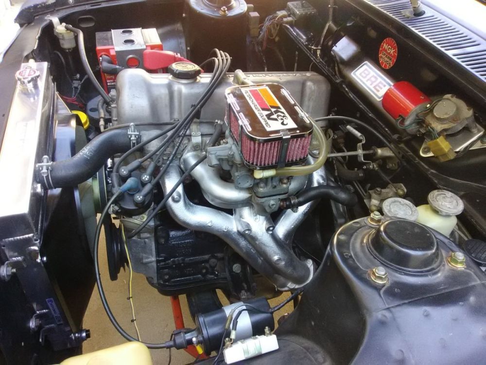

Tedman Posted March 22, 2025 Author Report Share Posted March 22, 2025 Painted the exhaust manifold. Thought I had some black BBQ paint, but it was silver, so silver it is. Quote Link to comment

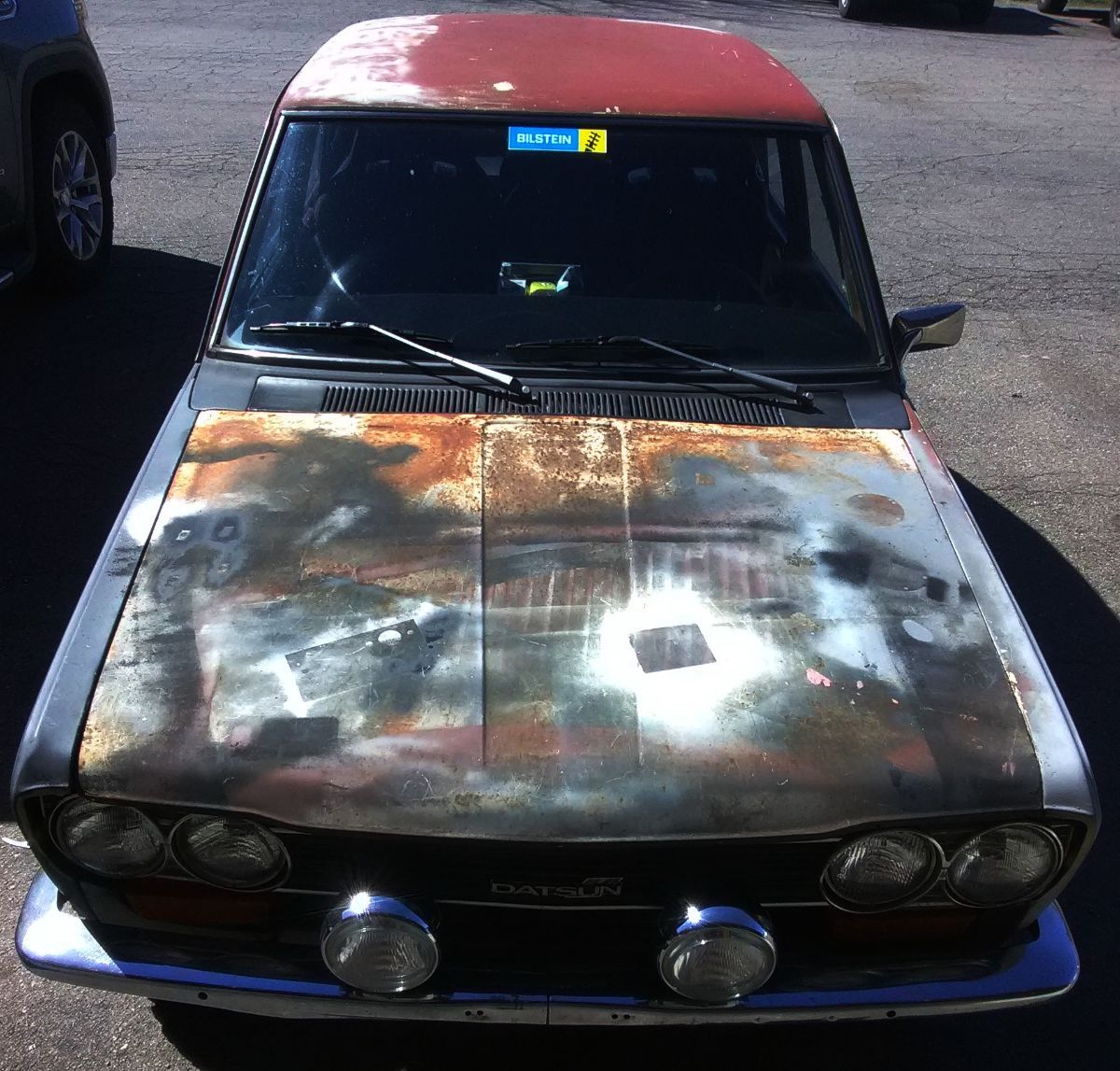

Tedman Posted March 28, 2025 Author Report Share Posted March 28, 2025 Spray bombed the LF quarter to match the RF, and hit the hood with some flat black after sanding. Muttley is now more or less two-toned. Also fit the DP Racing steering box brace. 1 Quote Link to comment

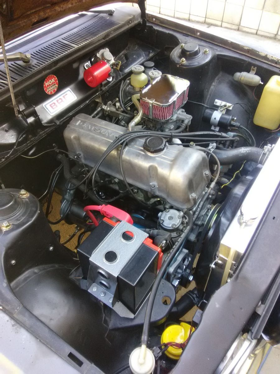

Tedman Posted July 24, 2025 Author Report Share Posted July 24, 2025 A few updates to Muttley's engine bay: -Improvised a coolant recovery bottle (a used gear oil bottle) mounted with a bicycle water bottle cage -Installed a set of used but still good translucent blue NGK plug wires after giving them a good scrubbing -Cleaned up and re-installed the blue distributor cap (brass contacts) that was on the engine when I bought the car -Swapped out the ignition points in the SSS distributor for a Pertronix Ignitor The car was still running flawlessly on points, but I decided to swap in the Ignitor for reliability's sake as I'm planning to take Muttley on an extended road trip later this summer. I will carry the points and condenser in the glove box in case the Ignitor fails, but they have been dead reliable in my experience. I'll also pack along the removed black plug wires and distributor cap as spares for my trip. When I went to reset the timing to 10 deg BTDC, I had to advance the distributor ~ 20 deg (crank), so I will include a note to that effect should I need to revert to points roadside. 1 Quote Link to comment

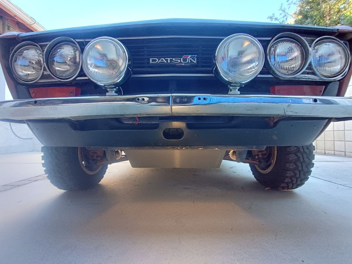

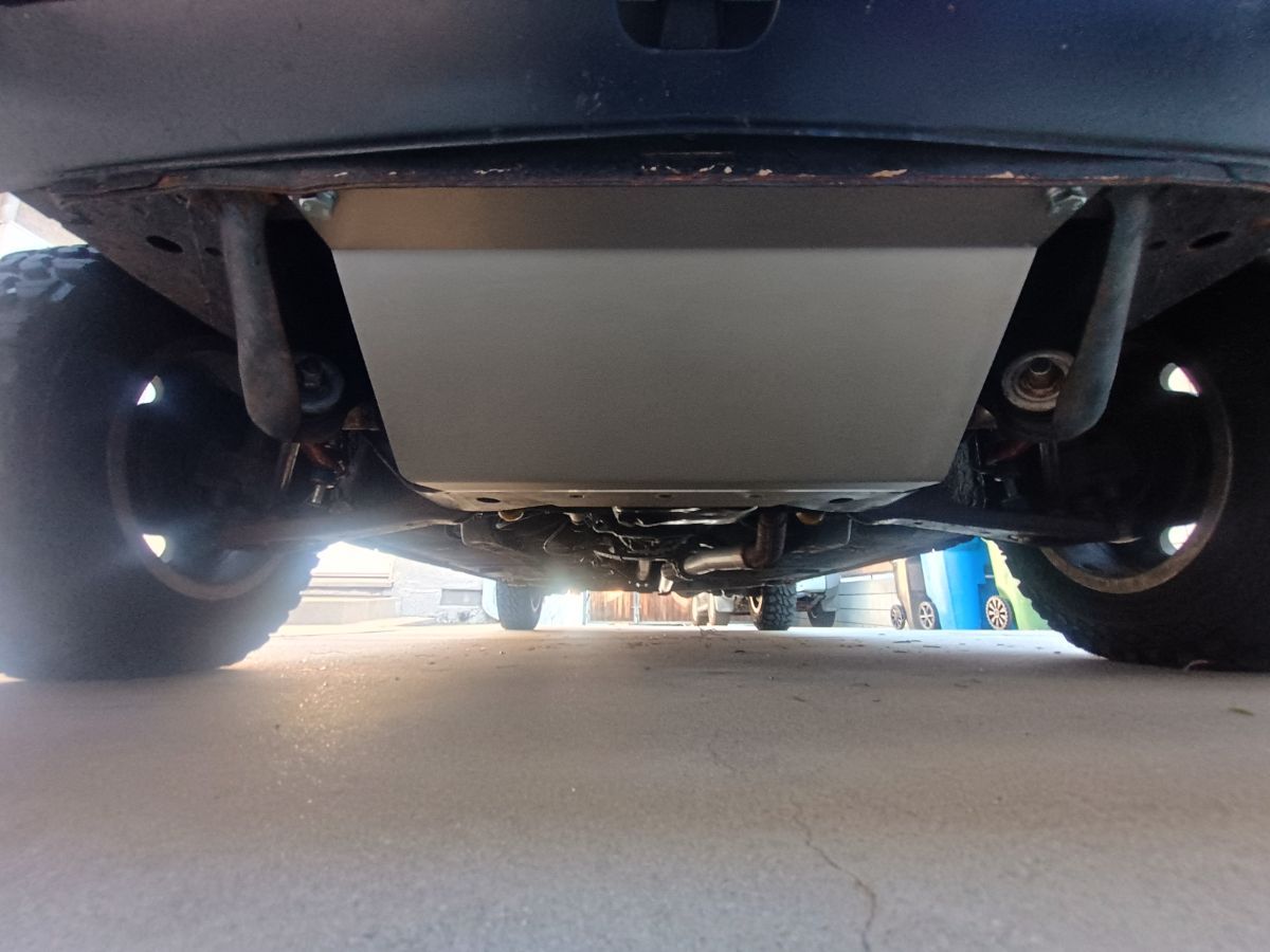

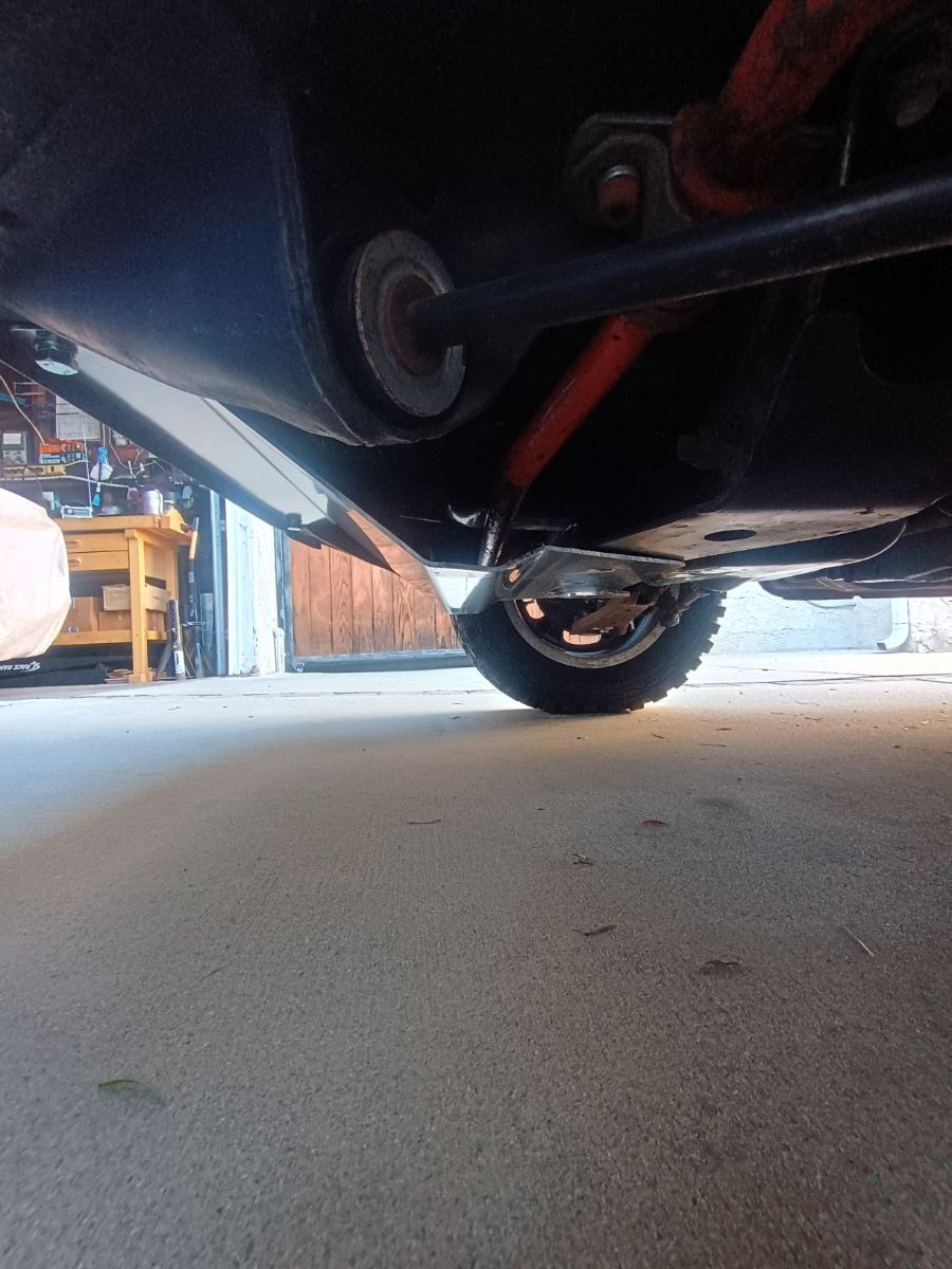

Tedman Posted May 17 Author Report Share Posted May 17 Been a while since I've checked in here. Update on a few things I've done to Muttley in the meantime. We fabricated a rock guard/splash pan from 1/8" aluminum sheet. 2 Quote Link to comment

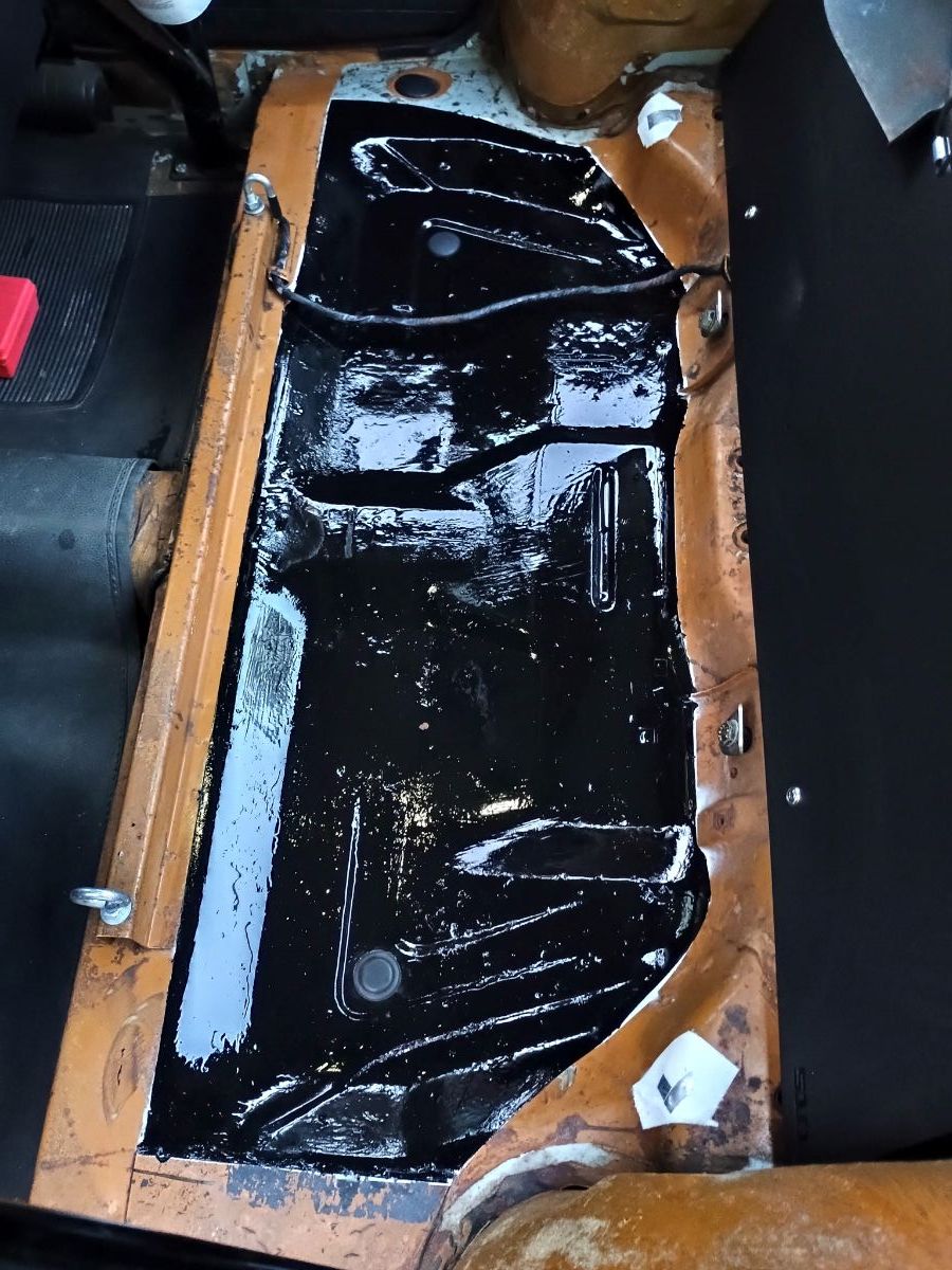

Tedman Posted May 17 Author Report Share Posted May 17 Brushed on a top coat of black paint over the white primer on the rear seat shelf, and installed fresh rubber plugs. 1 Quote Link to comment

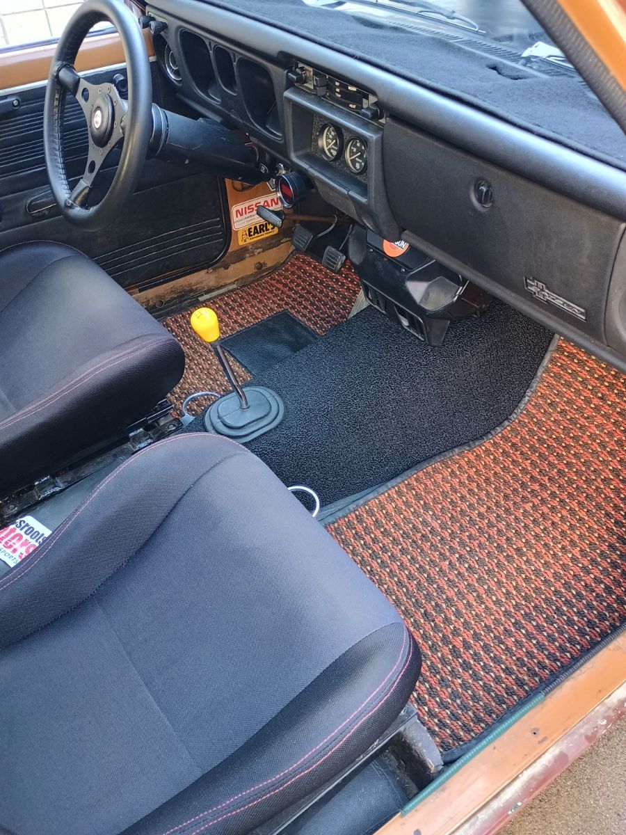

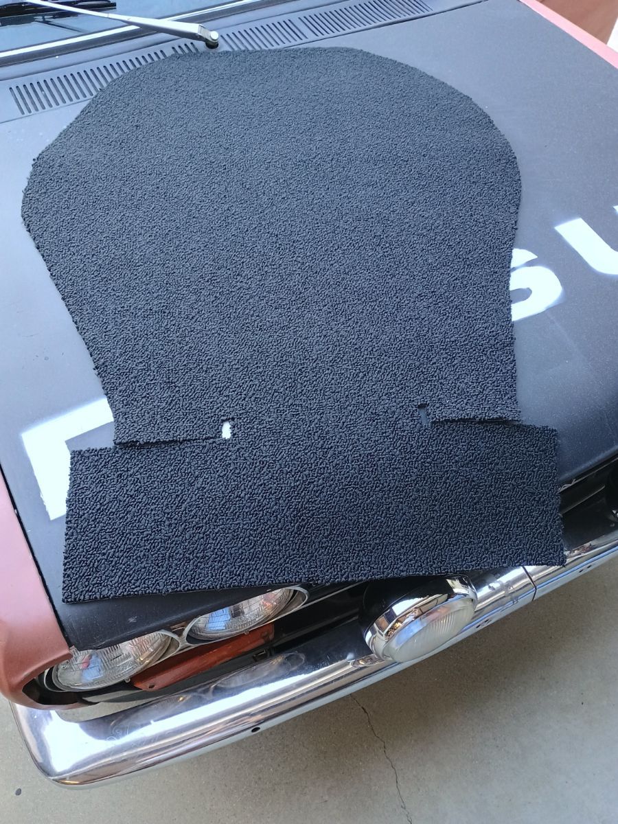

Tedman Posted May 17 Author Report Share Posted May 17 Bought a yard of black loop pile carpet and cut to fit the transmission tunnel. Tossed in the matching passenger side cocoa mat. Starting to look somewhat civilized. 1 Quote Link to comment

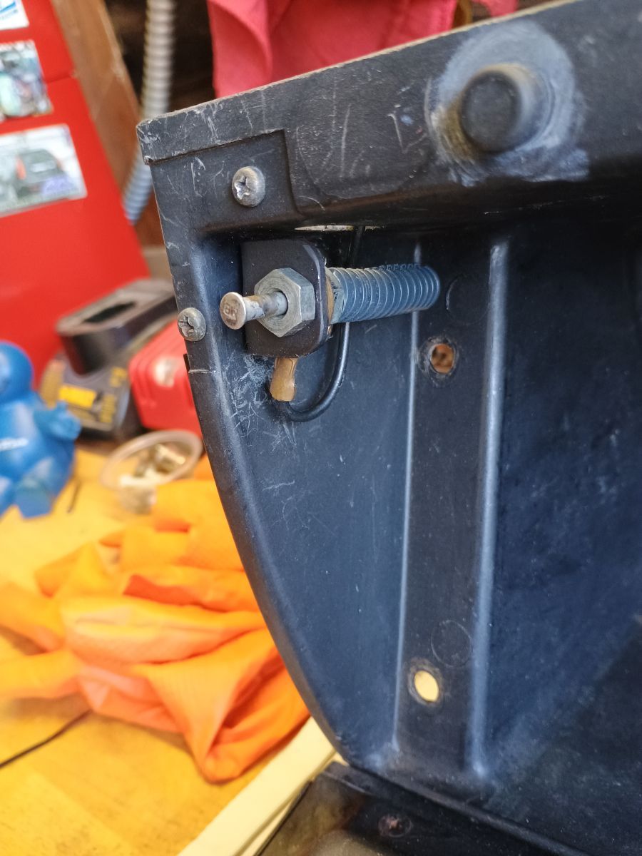

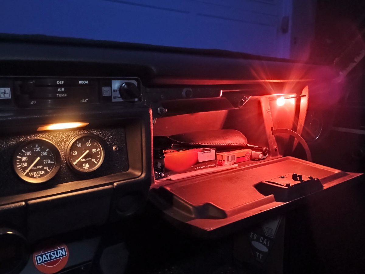

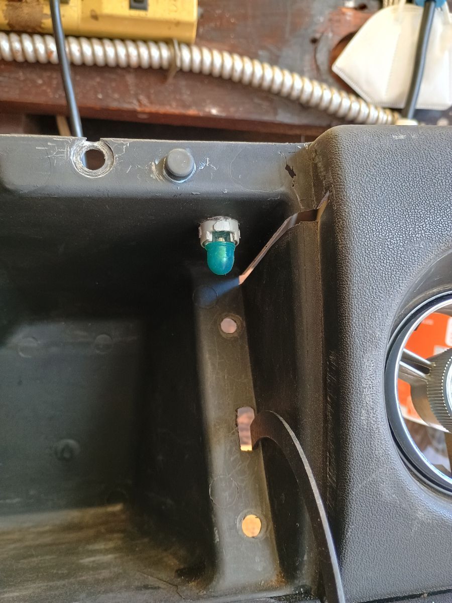

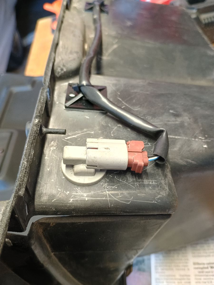

Tedman Posted May 17 Author Report Share Posted May 17 (edited) Installed a pin switch and lamp for the glovebox. I ended up choosing the red lamp boot over the green. Vintage pin switch from a late '70s alarm system has been rattling around in my toolbox forever. Upper RH corner seemed like a good place for the lamp. I have since swapped out the green boot for red. OE Nissan lamp holder and wiring pigtail is a remnant from the Autech S15 Silvia donor wiring harness that came with the SR20DE/6-speed that is installed in my other 510. Edited May 17 by Tedman Quote Link to comment
