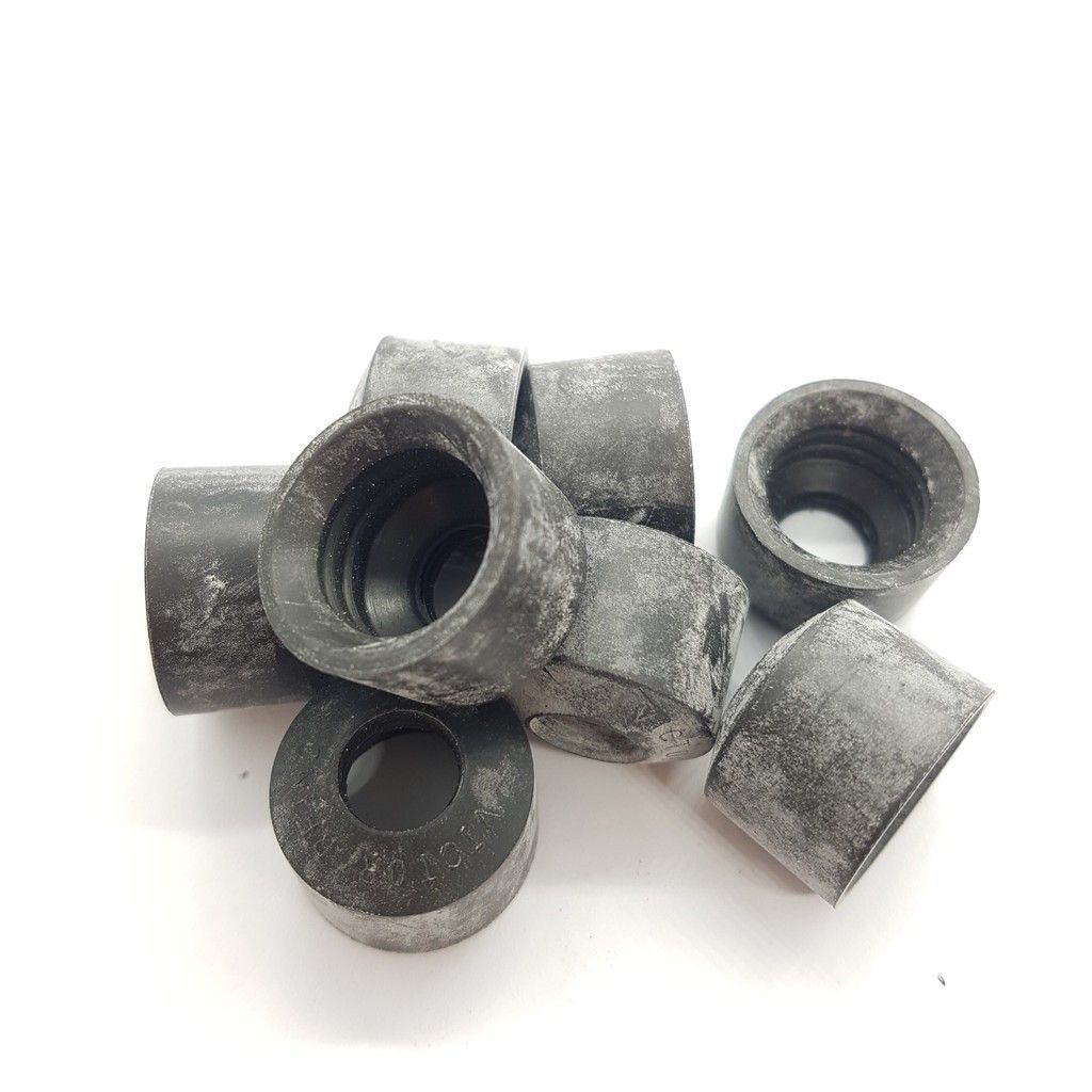

adg Posted February 5, 2025 Report Share Posted February 5, 2025 Hi, I'm getting ready to do a head gasket on my 82' z22, since it blew I was thinking doin valve seals as well while I have it apart, I'm just curious what might be the best material for the head gasket and valve seals and whether or not it'd be good to take the timing cover off In the process as well just to maybe do that gasket too, I only have about 155000 miles on this truck so I'm not worried a whole lot about the major mechanical stuff more the seals and gaskets cause the truck sat for years. I'm also not too familiar with the timing setup on these and when to know it's on TDC cause of the 2 #1 plugs I just don't want to mess the timing up in the process of all this, thanks! Quote Link to comment
NC85ST Posted February 5, 2025 Report Share Posted February 5, 2025 If the timing cover is not leaking, don’t mess with it if you don’t have to. You need to read up on replacing the head gasket if you’re not familiar with it. You may have to replace the timing cover gasket if the timing chain isn’t secured properly. As far as gaskets, Felpro works well. Quote Link to comment

jakebson Posted February 5, 2025 Author Report Share Posted February 5, 2025 Glad someone replied to this thread, because I finally got around to replacing my valve seals. Took care of it last weekend and took me right around 2 hours. I used Fel Pro valve seals. I have driven it a little over a hundred miles since then and I am still getting a little bit of blue smoke on start up. It is less and going away quicker, but still there. I thought I got all of the seals seated well, but maybe not? Quote Link to comment
datzenmike Posted February 5, 2025 Report Share Posted February 5, 2025 Push them all the way down the valve stem till they clip on the head. Oil them first? or grease so they don't start up dry. Back in the '60s my slant six had 'umbrella style' seals. OK when new but age them and they split or harden and break apart. Pieces in the oil pan. Didn't have the spring around them either. Quote Link to comment
jakebson Posted February 5, 2025 Author Report Share Posted February 5, 2025 7 minutes ago, datzenmike said: Push them all the way down the valve stem till they clip on the head. Oil them first? or grease so they don't start up dry. Back in the '60s my slant six had 'umbrella style' seals. OK when new but age them and they split or harden and break apart. Pieces in the oil pan. Didn't have the spring around them either. Yes, I oiled them up. The old ones were definitely brittle and cracked as soon as I started to pull them off. I believe that all the new ones clipped onto the head. Quote Link to comment
