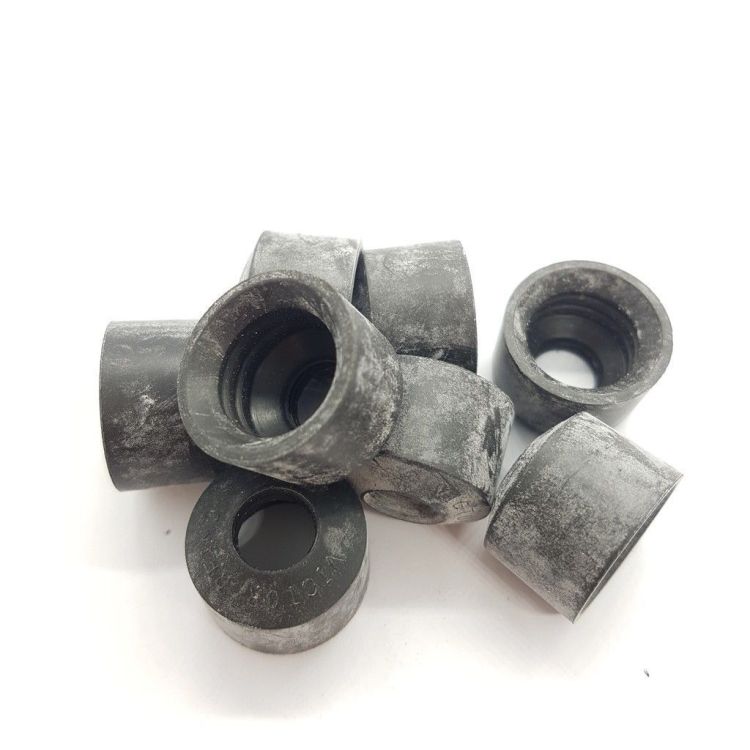

datzenmike Posted January 7, 2025 Report Posted January 7, 2025 There are small valve spring compressors. You'll need this style with the head on the engine. Would like to see pictures of the plugs anyway. If new then this will show it they are burning oil. Plugs are self cleaning given enough time. Valve lash is best set with hot engine. Manual says 0.014" for both. 1720103.avif 2 Quote
Draker Posted January 7, 2025 Report Posted January 7, 2025 You have a few options when dealing with valves on the car. Either fill the combustion chamber with compressed air and leave the hose attached throughout the process or fish a length of rope into the chamber on the compression stroke enough to compress against the valve to keep it up while working on the seal. Don’t smash it tight, just enough to keep it up and safe. Either will work. Pop the valve springs off and get the new seal on. Quote
datzenmike Posted January 7, 2025 Report Posted January 7, 2025 Doesn't have to be the compression stroke. The rocker shafts have to come off anyway so the valves will all be closed. The L series would be different. Only way to remove the rockers is at TDC when the lobes are out of the way. I find compressed air very scary way to do this. Anything could go wrong. Power to compressor goes off, air leak from a multitude of causes. Using rope you physically cannot drop the valve into the cylinder, hell you could replace your seals on the side of the road and stop for the night and finish the next day without worry. Quote
ElliotV Posted January 7, 2025 Report Posted January 7, 2025 (edited) 30 minutes ago, datzenmike said: Doesn't have to be the compression stroke. The rocker shafts have to come off anyway so the valves will all be closed. The L series would be different. Only way to remove the rockers is at TDC when the lobes are out of the way. I find compressed air very scary way to do this. Anything could go wrong. Power to compressor goes off, air leak from a multitude of causes. Using rope you physically cannot drop the valve into the cylinder, hell you could replace your seals on the side of the road and stop for the night and finish the next day without worry. Im with you on this one. Compressed air just seems too risky. What if it finishes off wore out rings or just blows past the rings and messes with other stuff and leaks compressor goes bad. I might be paranoid but its not worth the headache. Edited January 7, 2025 by ElliotV Quote
EDM620 Posted January 7, 2025 Report Posted January 7, 2025 27 minutes ago, datzenmike said: Using rope Just make sure it's a SOFT rope. I've used clothesline successfully. Start with piston at bottom of compression stroke & feed as much rope as you can cram into the cylinder, hand crank the engine to just before TDC on that piston. If it hasn't compressed enough, back it off to bottom of compression stroke & you'll be able to cram more rope into the cylinder. Don't use a poly rope. Quote
