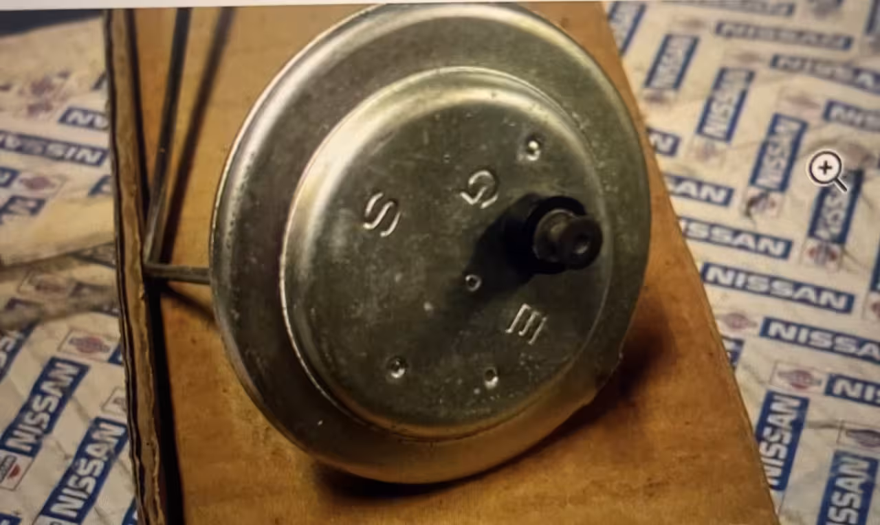

Chance Posted January 5, 2025 Report Posted January 5, 2025 so I bought a new sending unit and it only reads to a bit less than halfway and goes down from there. here's a picture tanks around 90% full. Quote

Chance Posted January 5, 2025 Author Report Posted January 5, 2025 21 minutes ago, datzenmike said: 1/ Does your temperature gauge read correctly???? If YES go to 2/ ... (If NO let me know) 2/ Ground the Yellow wire that goes from the gauge to the sender. Gauge should read FULL. 2a/ If it doesn't read FULL, then the gauge is at fault. 2b/ If it does read FULL then... 2c/ your sender in the tank is faulty or... 2d/ the Black ground wire is at fault or fallen off or hit with rock and broken. so I bought an oem one that doesn't have the ground stud on the top like the original one I grounded the yellow to the old one and gauge is working great. could the no ground on the new one be causing it to read only halfway? if it helps the gauge reads very slowly. Quote
Chance Posted January 5, 2025 Author Report Posted January 5, 2025 almost positive that it just needs a ground ohms look good on the sending unit. I'm thinking best solution is to find a circle ground like this and solder it to the top of the sending unit. only problem I don't know where to find a connection like that. does anyone know what its called or where to find? Thanks Quote

Chance Posted January 6, 2025 Author Report Posted January 6, 2025 12 minutes ago, datzenmike said: Yeah the rubber O ring may be isolating the sender from the grounded tank body. Or the tank may not actually be properly grounded. that's the power tab, it seems to only read when I put the negative lead on the top of the sending unit that's why I was thinking to add a ground "stud" on top to connect the ground wire to it I tried using a nail but soldering isn't sticking Quote

Chance Posted January 6, 2025 Author Report Posted January 6, 2025 I just need to figure out how to put a ground stud on the sending unit. any ideas would be appreciated Quote
