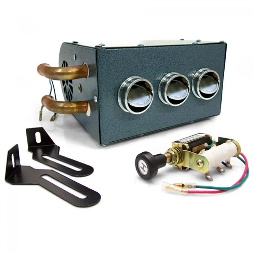

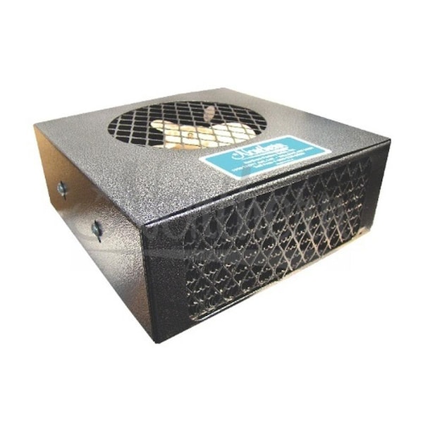

Cardinal Grammeter Posted December 24, 2024 Author Report Share Posted December 24, 2024 (edited) 4 hours ago, banzai510(hainz) said: dOnt look that bad It's worse than it looks. Can't feel any airflow velocity out of defroster or heater outlets. Heater core is so undersized have to make sure no cab leaks. _________ Studebaker Hawks had an auxiliary heater under the seat - a complete module with blower and core. Man I wish I had saved one. Would be perfect for the 620. Hum, this has promise - price isn't too awful bad: $160 https://www.ebay.com/itm/275860282745 This one would fit underseat maybe But $360 https://www.zoro.com/aftermarket-16-000-btu-compact-auxiliary-heater-for-under-seat-mounting-12-volt-ah500/i/G505759103/ Edited December 24, 2024 by Cardinal Grammeter Quote Link to comment
