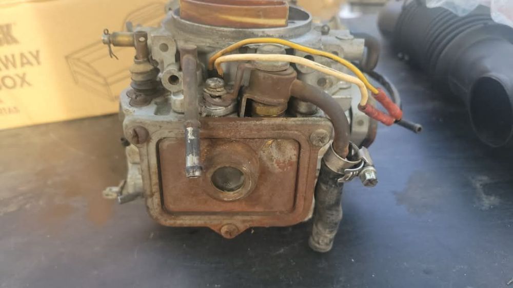

The stalling is your carb problem,clean the ground wire and see if that fixes it.There is a sellerwith a Nissan 720 fuel lump for sale,he also cleaned the ground wire,says it works,it is rusted,as is.I bought from.him,he is in Georgia, up the road from me.It is 59.99.hm.His user name on Ebay is B&B Georgia Surplus.Ships fast.Put itnin a sand blstervencloser make it look.new,we have on at work1980-1986 Nissan Datsun 720 Truck OEM Fuel Pump Assembly
