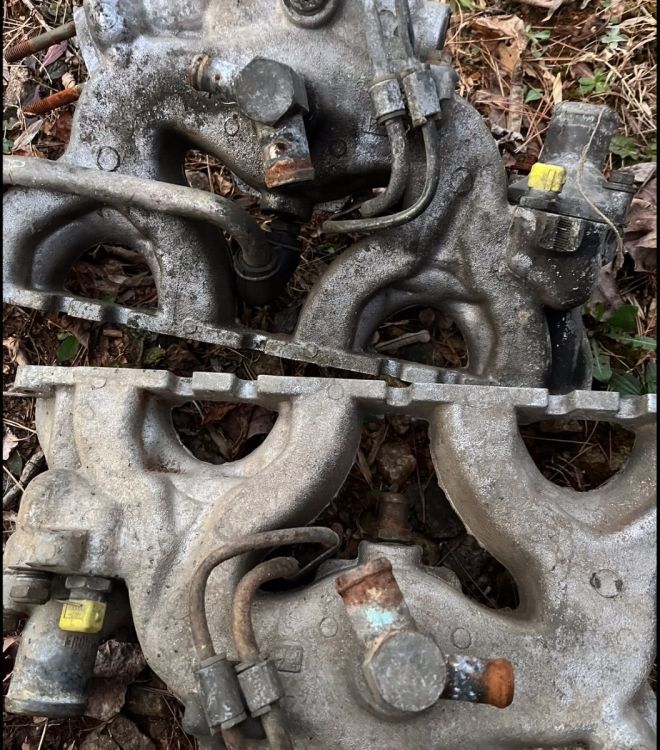

Thomas Perkins Posted November 27, 2024 Author Report Share Posted November 27, 2024 Now,the part says it is in Atlanta.So I may get it.Nothing wrong with the intake manifold.It is leaking at the hose that connects to the 3 way connector that connects to the hose that goes to two way connector..I need a 3 way connector.Why in the world would I replace a good intake?Here is the 3 way connector.This is the problem.Leaking where the hose connects .Nothing to do with the intake.Where the 3 way connects to the intake is good? Quote Link to comment

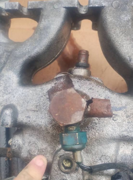

Thomas Perkins Posted November 27, 2024 Author Report Share Posted November 27, 2024 (edited) To give you a better view of what I am seeing.Above the oil pressure switch is the 3 way connector.The hose on the left is good,the hose on the right is the one that has a drip.The connector that screws into the intake is good.The drip is at the oil pressure switch,the drip also travels down that hose onto the oil filter.I am now going to wait and see if the 3 way makes it here.When I replaced the oil pressure switch cause the of the leak,is when I noticed the leak.I took the oil filter off and alternator,I will do it again,also putting a new thermostat in.Not a drop came out of the oil filter when I removed it.That was strange.No leak at the intake.Could be a crack in the part that the hose connects to.Leaks at the top of connector cause coolant is traveling down hose,if leaking at bottom it would not do that.If I get new connector then I can see what is up. Edited November 27, 2024 by Thomas Perkins Quote Link to comment

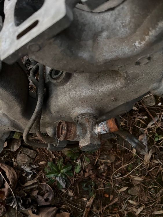

Thomas Perkins Posted November 28, 2024 Author Report Share Posted November 28, 2024 (edited) HI Ya'll.Here is my 3 way connector.By doing the measurement on the hose connector.It seems that the hose clamp I am using is to wide and is gripping the lip part of the connector and causing the hose not to seal and leak.Nissan does not sell the hose clamp for these.Check out the picture and you will see.The top of the connector sticks out to a vee where you can't get the hose over it completely.I need a clamp 1/2- 5/8 inch wide.I will try a smaller clamp.Suppose to rain tomorrow.See how far I have the clamp away from the connector.It is clamped on the end part and not sealing.I do have it farthest it will go over. Edited November 28, 2024 by Thomas Perkins Quote Link to comment
Thomas Perkins Posted November 28, 2024 Author Report Share Posted November 28, 2024 My bad,I had it wrong,it is the wider out let that the hose is leaking on. Quote Link to comment
datzenmike Posted November 28, 2024 Report Share Posted November 28, 2024 Generally, hoses and lines tend toward larger in the direction of flow as more lines are connected to it. Fuel return lines are larger diameter. 1 Quote Link to comment
Thomas Perkins Posted November 28, 2024 Author Report Share Posted November 28, 2024 The first hose I replaced long ago was so swollen.That is when I changed the clamp to a wider one not realizing that it was gripping on the end lip and not sealing.As soon as a I eat Thanksgiving Dinner,I will get started.I did post that hose on here when I did it,I just cleaned my shed the other day and tossed it. Quote Link to comment

Thomas Perkins Posted November 29, 2024 Author Report Share Posted November 29, 2024 (edited) Here is the leak at the hose.Picture is up side down. See the coolant on the oil pressure switch.It travels down the hose. Edited November 29, 2024 by Thomas Perkins Quote Link to comment
