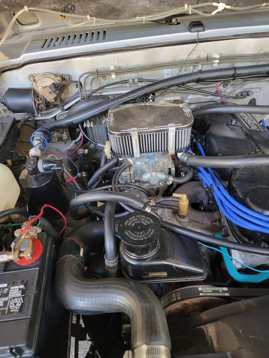

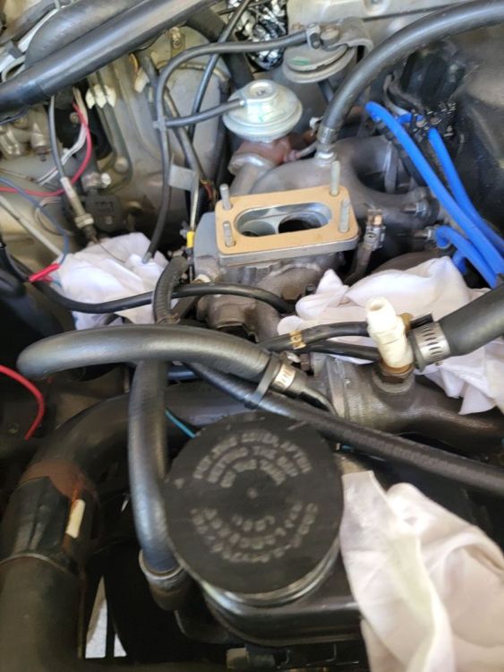

Thomas Perkins Posted October 25, 2024 Report Posted October 25, 2024 (edited) Today is a great day to put new Gaskets on the Weber.I bought it on Ebay back in 2016 for 299.K-646.Added a Empi Idle cut off solenoid from the North American Weber I bought long time ago.See the date. Edited October 25, 2024 by Thomas Perkins Quote

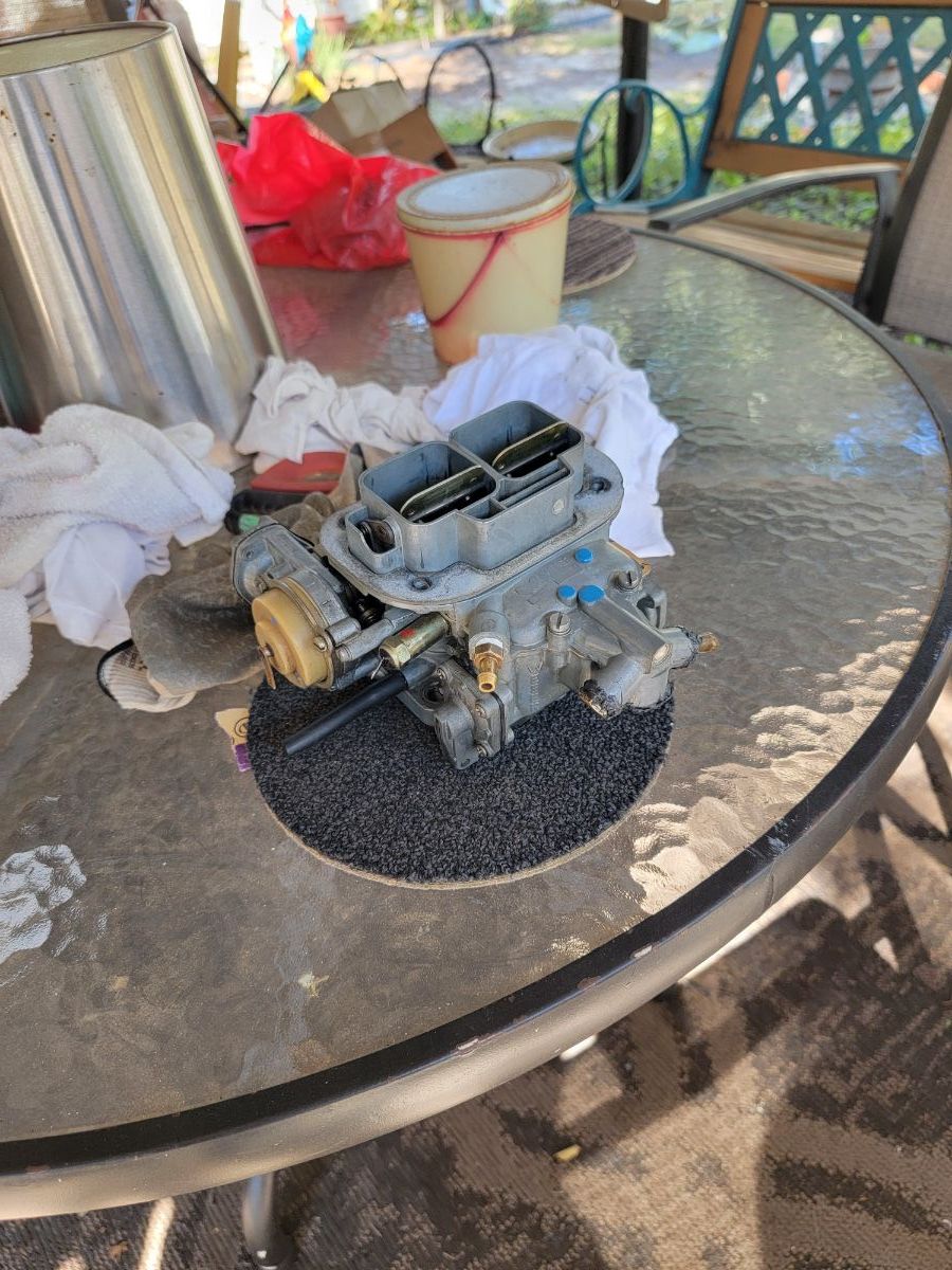

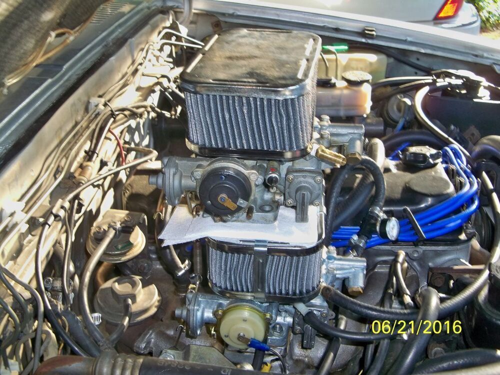

Thomas Perkins Posted October 25, 2024 Author Report Posted October 25, 2024 (edited) Here is the North American Weber with the black choke I bought many moons ago.See the idle cut off solenoid on it.It came with the Weber back then.See the date that is on the picture from my Kodak Camera.Where I work.If you look close at them,they are not identical,bottom one is a Redline,the real deal.Other one had a sticker on it but it ran good.I was a member of 720 World back then. Edited October 25, 2024 by Thomas Perkins Quote
Thomas Perkins Posted October 25, 2024 Author Report Posted October 25, 2024 All done.It is 90 degrees today here in Georgia.Not a cloud in site. 1 Quote

Thomas Perkins Posted October 25, 2024 Author Report Posted October 25, 2024 As you see on my Weber, the front 3 parts that screw in have black silicone around it.2 have aluminum washers and bid center has nothing.They will leak and go under the carb,you may not see the leak,but run your finger under it and you will have fuel on your finger.I have a bunch of extra washers that is suppose to stop the leak,the big part with the little fuel filter in it leaks,the most.I neven bought another plug and it still leaks.The silicone works.The little fuel filter is too long,when you take the plug off the filter is crushed..Needs to be 1.5 mm shorter. 1 Quote

Thomas Perkins Posted October 27, 2024 Author Report Posted October 27, 2024 (edited) If you don't make your own gasket that goes under the base plate.You have to buy the gasket kit.The one at the bottom right is what goes under the base plate.It's not sold separate.I had to buy this kit before to get it.99005.336.The bottom left one I don't use.If you need a new E clip that hold your choke linkage together,Harbor freights variety pack doe not fit.Here is the part number.10140.501.They are 79 cent.They are between 1/16 and 1/8 inch.The size in Harbor's Freight kit I have.May be metric since the Weber's are made in Spain. Edited October 27, 2024 by Thomas Perkins Quote
