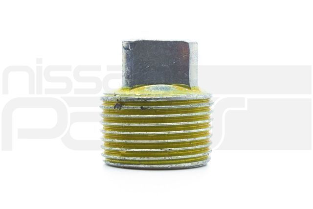

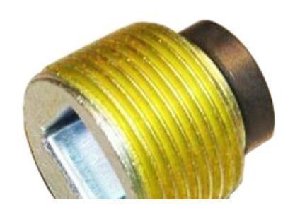

Thomas Perkins Posted October 18 Author Report Share Posted October 18 (edited) Here are my Nissan transmission fill and drain plug. Edited October 18 by Thomas Perkins Quote Link to comment
