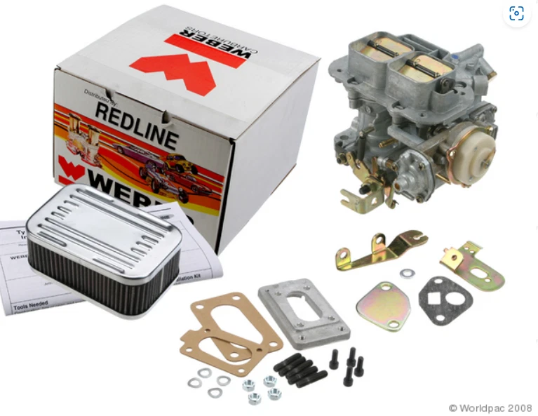

Nicholas7620 Posted October 7, 2024 Report Share Posted October 7, 2024 Long story short. My 76 B210 wants to pass smog. I'm thinking of scrapping the original Hitachi Carb for a Weber 32/36. Which one should I buy, from ebay. Weber Carb Kit fits Nissan 210 310 B110 B210 1970-1982 w/ A12 A14 A15 k624 . Thank you in advance for your opinion Quote Link to comment
datzenmike Posted October 7, 2024 Report Share Posted October 7, 2024 Won't pass smog testing. It will fail the visual before it even gets to the testing. You can't replace anything but with exact same year part. You can't remove any of the smog or emissions components either, and putting that Weber on as pictured will remove the ATC or the Automatic Temperature Control in the original air filter. Rebuild the original Hitachi and get it past smog testing. Afterwards swap the Weber on but keep the Hitachi for the next test. That's about all you can do to get around it. 1 Quote Link to comment
