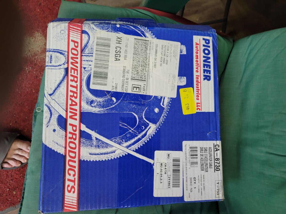

Thomas Perkins Posted October 7, 2024 Report Share Posted October 7, 2024 (edited) PIoneer Ca-8730.Auto Zone has them for 48.99,cheaper than Rock Auto Parts cause you have to pay shipping.I have one on my 85 and a spare.Don't lube them.You will have to order it.Do you have the clip that holds it to the firewall? Edited October 7, 2024 by Thomas Perkins Quote Link to comment
Thomas Perkins Posted October 7, 2024 Report Share Posted October 7, 2024 Here are some pictures I just took of my PIoneer throttle cable on my truck and my spare.Both came from Auto Zone. Quote Link to comment
