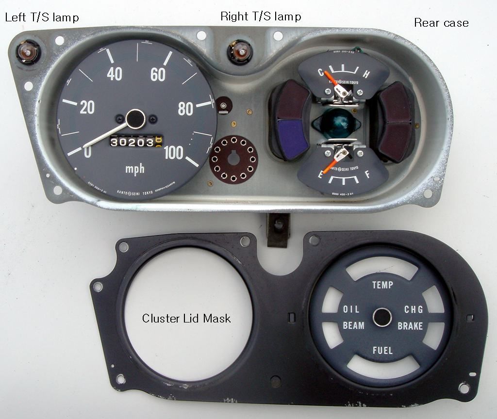

If you have the round speedometer, the one above which jojo recommends is 85mm. Datsun 1200 round speedometer is 98 mm so it may fit in the facia bezel if you fabricate a mounting plate (a thin plate with 85mm hole, with small holes to match the cluster lid)

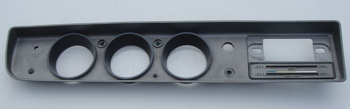

For the rectangle gauge dash, or for more ideas, see Datsun 1200 Custom Dash

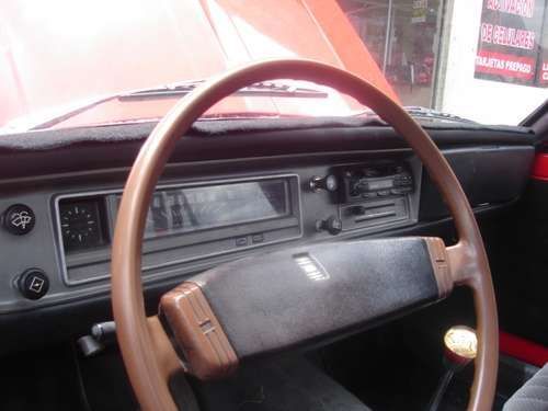

Is this a Datsun 1200 Truck? Those were made until 1985. I was considering buy a 1984 out of Costa Rica, but instead I got RHD version
* Early 1978 1200 had the bar gauge
* Late 1978 had the round gauge
1971-1978.03
