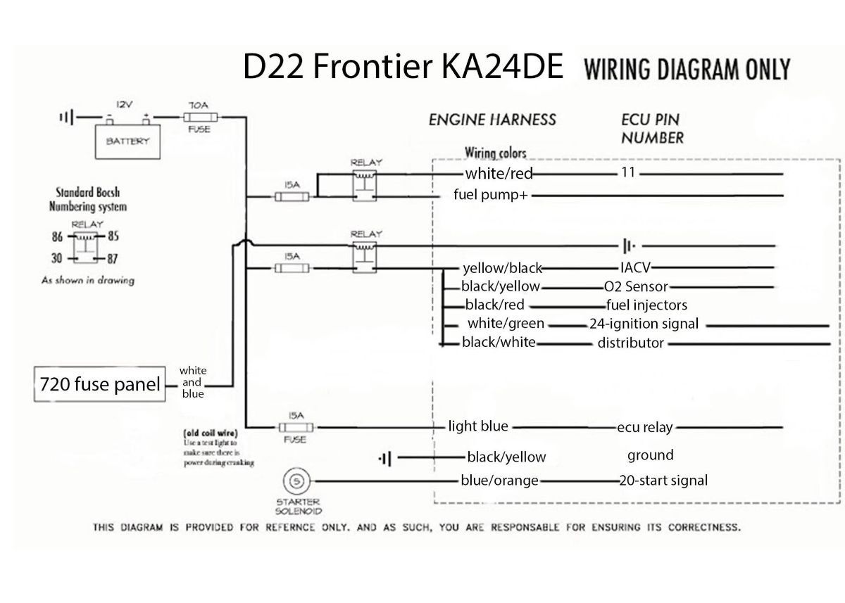

ggzilla Posted September 3, 2025 Report Share Posted September 3, 2025 To clarify, the HP is about the same, but it has more torque KA24DE Nissan D40 Frontier Pickup 143 HP @ 4300 RPM 160 lb-ft torque @ 4200 RPM KA24E SOHC Nissan D22 Pickup 140 hp @ 5600 RPM 152 ft-lb @ 4400 RPM I don't know if the D40 has improved wiring harness or not. The 240SX harness is reportedly easier to snake the ECU connector out of the firewall But otherwise, all three can be used. The harnesses will connect to all the sensors, injectors, ECU, etc. Once you get all the wiring harness, identify the eight wires needed for the Datsun swap and connect them to the fuel pump, ECU, fan, and to these Datsun wires: Battery (via fuse), Ground, IGN and START * Some spend a lot of time cutting out the un-needed wires for a cleaner installation * Others leave all the un-needed wires in the harness, and it works, saving a lot of time * Jeff created new wiring from scratch, and created a relay board to replace the wiring harness relays Is there a detailed write up on doing this? The old posts I find have broken links to diagrams, and I can't remember what the eight wires are 1 Quote Link to comment

]2eDeYe Posted September 9, 2025 Report Share Posted September 9, 2025 Thanks Daniel Monroy for figuring this out. 1 Quote Link to comment
