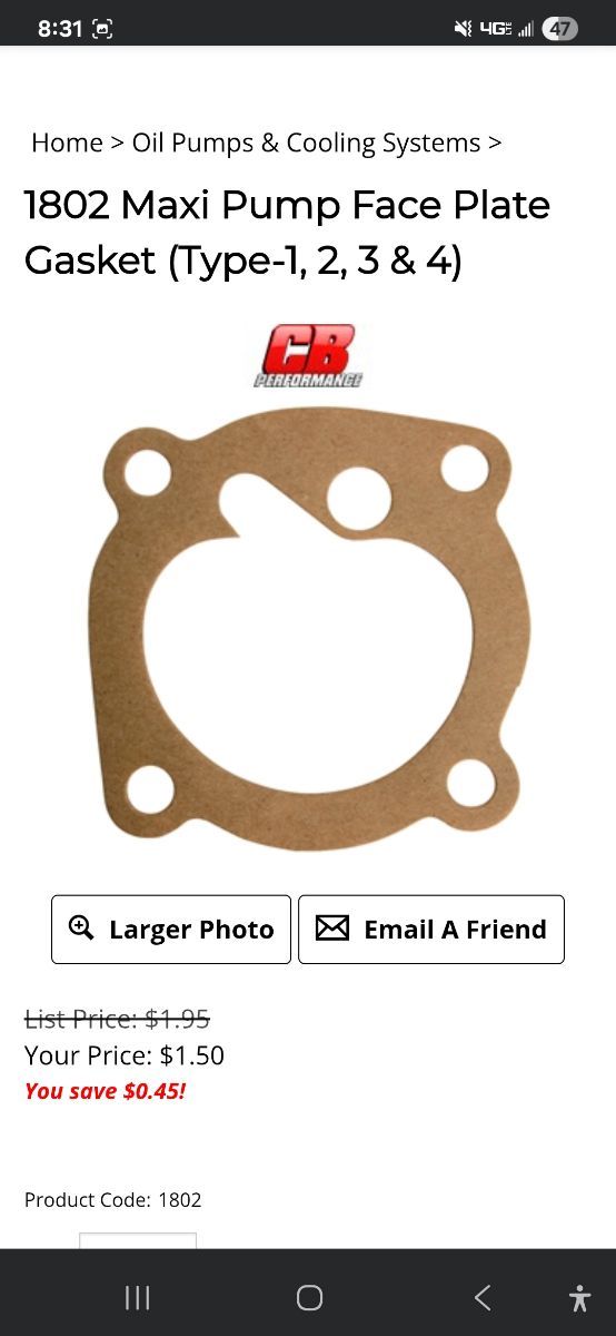

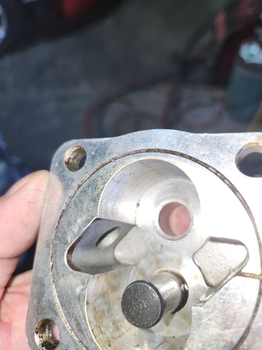

One thought I had was is the gasket what's screwing me....

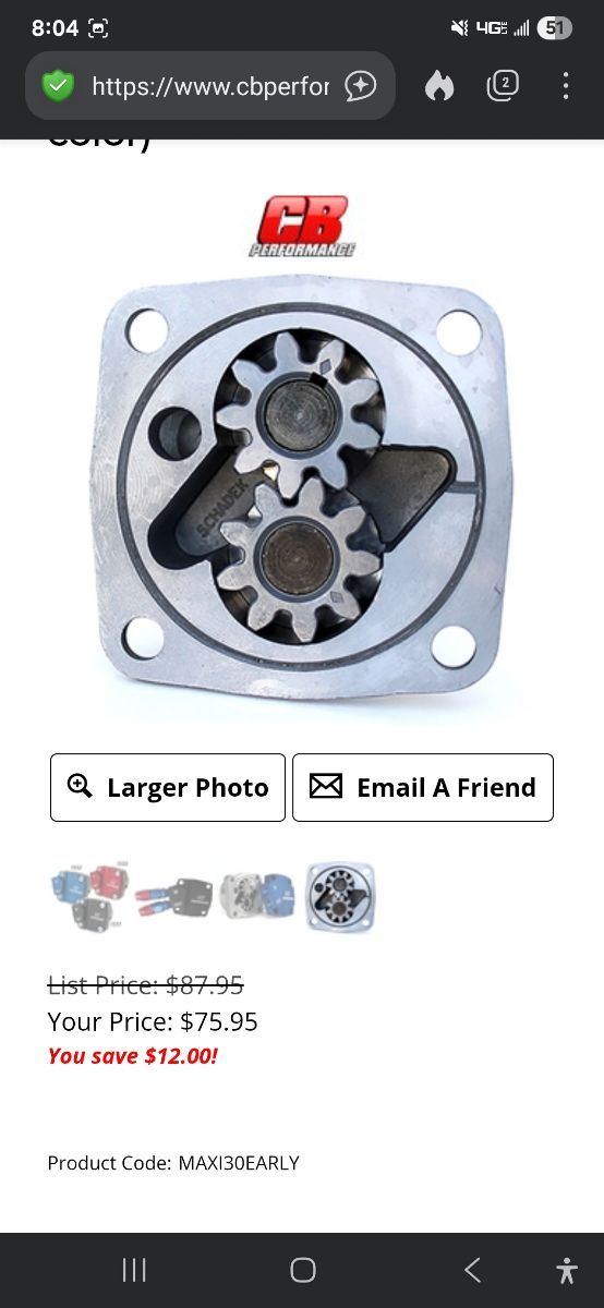

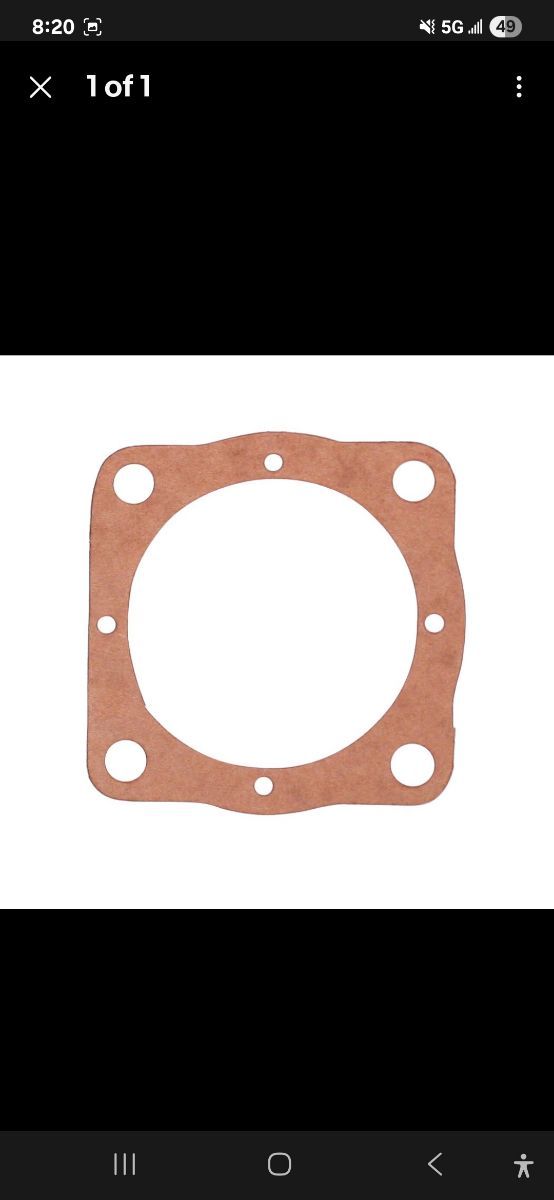

This was supposed to be a full flow pump with in and out coming from the cover... I capped it with a cover plate but used a gasket like this....
Then I got to thinking the pump came with a gasket like this.
Which seals that 1 hole....
The outlet is the left side lower cavity and return in is the upper hole....
Without thats sealed am I just recirculating in the pump or should that not matter?
Either way I'll probably swap pumps... seems the most logical and I have it...

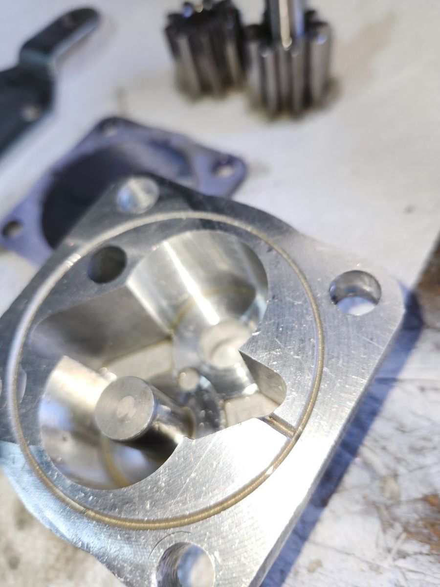

Well I think I'm a fucking idiot.....
Actually I hope I am because if I am right the fix is possible...
The pump I have installed is a full flow pump.... which means oil leaves the pump from the large chamber and returns to that hole.... then out the side....
A stock pump oil exits the left side of the large cavity.... I'm guessing when I get home there will be a through hole from the side of the pump....
Since the full flow pump is already fitted I might just plug the top hole and drill the side hole through....
Fingers crossed
So it was the pump.....
See the top hole but no hole inside....
The other pump....
Turned out to be easier to oversize 2 mounting holes to fit the 3/8 studs vs drilling the cross hole....
Now I have good oil pressure, thank God I didn't ruin the wife's engine ....

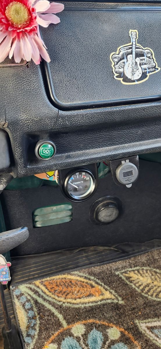

Ended up installing a basic temperature gauge for her oil... just so she has an idea of her actual operating temp..
She was complaining it wasn't running good on very cold mornings... which is true, but she couldn't judge how long to warm it up till it would run smooth... so the gauge helps her know...

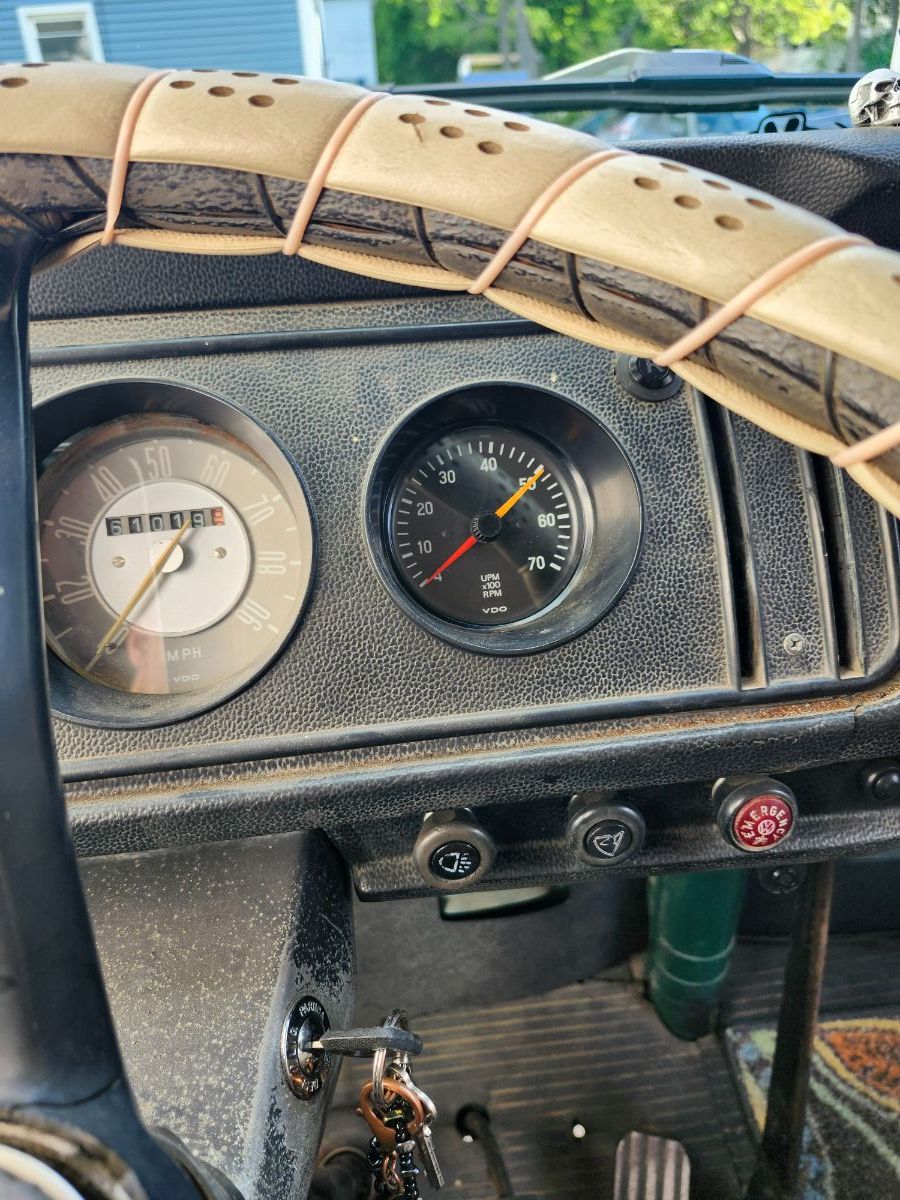

Also came across a VDO tachometer that fit the blank in her dash. I had some cheap 2" one stuck to the steering column which I never liked...
This is much better and same brand as the speedometer...
