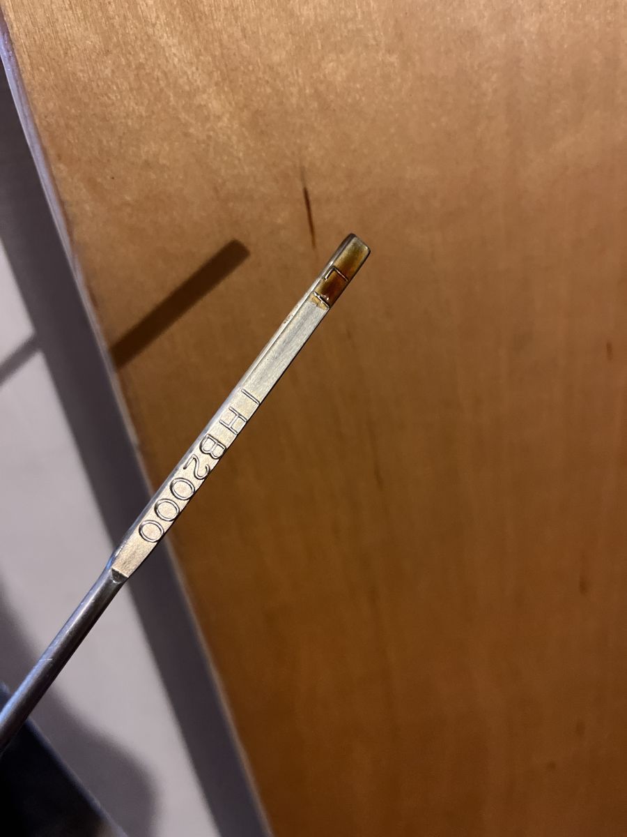

datzenmike Posted January 5, 2025 Report Share Posted January 5, 2025 The radiator cap has a pressure relief built into it for 13 PSI. Normally there is a slight pressure in the cooling system but the engine NEVER gets this hot. Look at your temperature gauge. If in the normal run range then you're fine. You may have had two small weak spots. Once you fix one the other takes over. Maybe reading the dipstick wrong? The oil is reading at the low level point. The line just to the right of the H is the full mark. Between is about one quart. As I said check the oil with the truck on level surface. A cold engine will always read higher level than one that has just been run because the oil hasn't had time to drain back into the pan. As long as at the full level point when starting for the day you are fine. Quote Link to comment
Matt H Posted January 6, 2025 Author Report Share Posted January 6, 2025 Hey @datzenmike So I managed to get the truck going today and took it out for a good hour or so. I think all the oil thing was is after I had cycled the engine the level was reading much lower. I topped it up and now its at the Hi line even after its been running. The temp gauge is stead and stays in the centre. Unfortunately i'm still having quite a bit of trouble with the truck... Rough Start It has a horrible time starting. I'd say t took around 12-15 attempt to crank the engine before it eventually started up and kept running. After its hot it start up right away but if you leave it for say 10 mins it will start to have trouble again. Regardless to how I set the choke (Pedal down, Choke out, pedal down once more) or me feathering the gas pedal it just does not want to start. Strong smell of gas There is a strong oder of gas coming from the car. A lot of the smell is coming right back into the cab. It's always been a bit smelly as there are a couple of wholes that aren't plugged in the firewall but now its so bad I was literally getting light headed trying to drive the truck even with all the windows open. The smell is quite extreme White vapor coming from the carb I managed to trace the smell back to the top of the carb. I noticed when I was testing the choke that there is a white vapor coming from the under the choke plate. I opened the choke with the engine off just to test it and I can see the white vapor seeping out. Choke is closed When the choke knob is pushed in on my truck the choke plate is closed. When I pull the choke the choke plate is open say 25%. Is this correct? I was under the impression the choke should be all the way open as standard? Quote Link to comment
