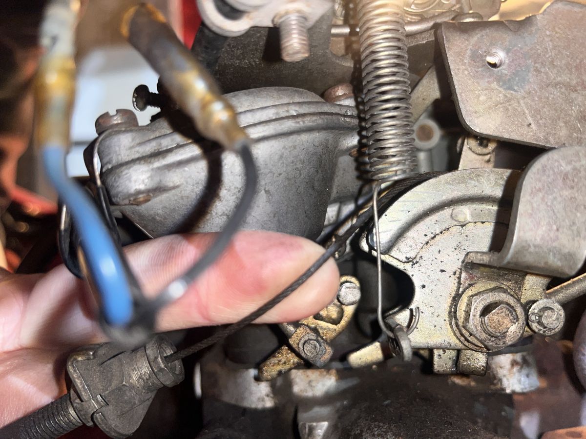

Matt H Posted December 31, 2024 Author Report Share Posted December 31, 2024 (edited) Hey guys thanks for the fast response. @datzenmike I'd say your intuition is pretty on point. The choke cable is really slack! There is no tension in the line. If I pull the choke knob it gets even more slack. I can manually pull on the wire with my hand I can see the choke plate moving but this will not work normally as there is so much slack in the cable. I'm looking at the adjuster and it already appears to be set at its maximum. Am I right in thinking the choke cable is stretched and needs replacing? @NC85ST The fuel filter is bone dry as is inside the sight glass. (The car has not been run now for a couple of months) It looks like the front metal bezel is a little bent in the bottom right hand corner. It looks like someone had previously prised it off with a screwdriver. It's also worth pointing out that the screws that were holding the sight glass in place were only hand tight. I literally could remove the bottom screw with my hands (The glass is also ever so slightly chipped on the outer edge) @datzenmike I'm having a hard time trying to remove the glass as it seems to be lodged in there pretty tight! As far as I can see the rubber seal is not twisted although it does look as the the top half of the glass is seated ever so slightly closer in than the bottom half. Whats the best way to remove the glass - with a screwdriver? Edited December 31, 2024 by Matt H 1 Quote Link to comment

datzenmike Posted December 31, 2024 Report Share Posted December 31, 2024 The cable pictured is the throttle cable. Screw the adjuster away to the left in the picture and that should improve the pedal feel. Post a picture more to the right and up. The manual choke should be there. Quote Link to comment
banzai510(hainz) Posted January 1, 2025 Report Share Posted January 1, 2025 2 hours ago, datzenmike said: The cable pictured is the throttle cable. thats what I was thinking nothing to do with choke cable. fuel filter empty? fuel pump or cracked fuel line not sucking. Even if sight glass was leaky once filled it should run fine. replace it fix sightglass gasket. see then what happens 1 Quote Link to comment
Matt H Posted January 2, 2025 Author Report Share Posted January 2, 2025 OK so I fixed the leaking carb issue. I managed to bend the bezel back into shape - It took a few attempts to get a good seal. For whatever reason the top two screws go in a lot easier the the bottom meaning if you over tighten them it will skew the angle of the glass which fails to seal. I now have fuel in the the sight glass and fuel filter. I do still notice a tiny bit of fuel residue around the bottom screw and also on those two bolts with the orange o-rings but i'd say its 99.9% sealed. @datzenmike I tightened up the throttle cable and also located the choke cable and can confirm the choke is engaging. The choke plate only opens about 25-30% when fully opened. I presume this is normal? I've changed the spark plugs and charged the battery - Now the car will crank but is failing to start. I also noticed some of the bolts on the valve cover has come loose and too my surprise the oil level seems to be considerably lower than it was last time i checked (Please note this is while the engine was cold) For what its worth i'm also attempting to start the car on quite a steep hill (sideways leaning) and I noticed the dipstick was failing to read the oil which is a little concerning. Is this this normal for a cold engine to read so low? Quote Link to comment

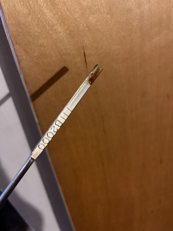

Matt H Posted January 3, 2025 Author Report Share Posted January 3, 2025 @datzenmike I ended up doing a complete oil change as the oil that was in there was filthy. I changed the filter and added some TB Zinc Plus. I'm pleased to say she's back up and running!! I had to readjust the throttle cable as it was idling a bit high but it honestly drives like a new car now. I think that might of solved another issue I had where it would hesitate every now and again pulling away in 1st (now there is no slack in the pedal). I think it also concludes that the leaky gasket was the reason i had to continuously pump the gas pedal to start it as the bowl was puking fuel. Now thats fix it basically starts by itself 😄 Thanks everyone 🙌 Last on my list is to fix the leaky radiator hose. Now its back up and running I can get a clearer idea whats its coming from. I'm going to try switching out these hose clamps for the T-Bolt style ones. I want to make sure its not because the clamp is pinching the hose or done up too tight. If that fails then I guess its going to need re-soldering. 1 Quote Link to comment
