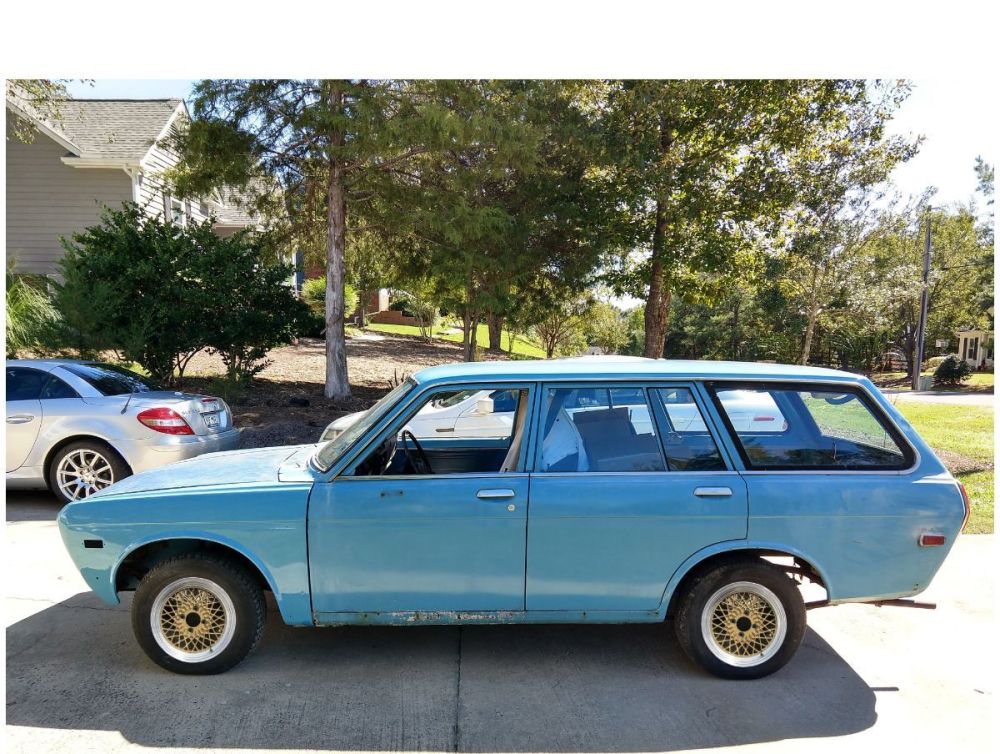

Legoman27 Posted April 13 Author Report Share Posted April 13 picking up where I left off 3 Quote Link to comment
Rustbin Posted April 13 Report Share Posted April 13 Nice work. I've been noticing the right side is always more damaged than the left. You can check the rad support with a long straight edge to see if it's flat, I've found mine was about a 1/4 inch in on the right side. Quote Link to comment
Legoman27 Posted April 13 Author Report Share Posted April 13 (edited) The wheel well patch was mostly because of rust there's a little waviness I might try and shrink out of the rad support, but it seems mostly straight as best I can tell there was a little damage at the very bottom right, in the box section, but it almost looks like someone tried to jack up the car there as opposed to accident damage there are a few spots on the inside of the right rear quarter with some filler squeezed through I figure it's from a screw and slide hammer Edited April 13 by Legoman27 1 Quote Link to comment
