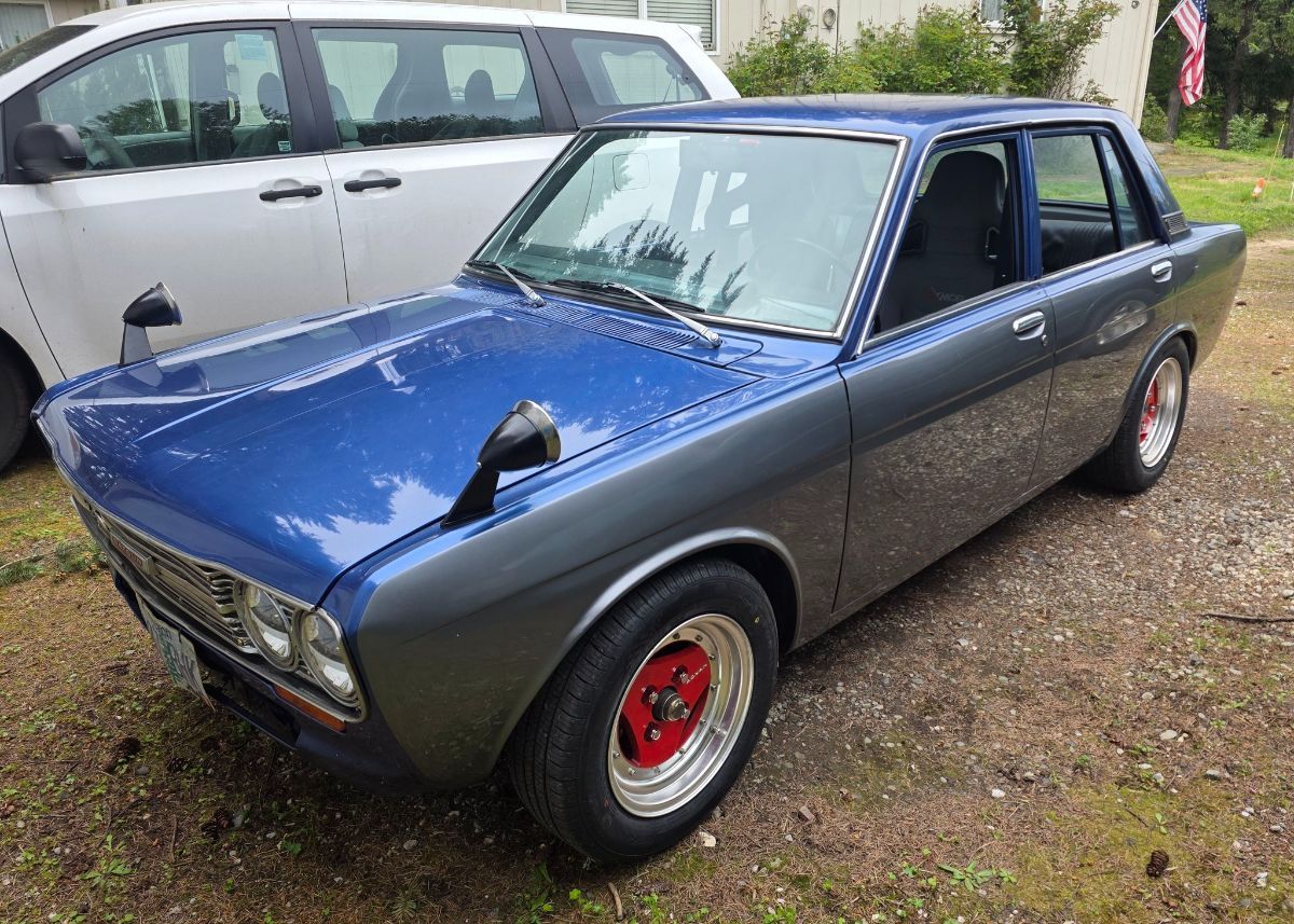

Dguy210 Posted April 19 Author Report Share Posted April 19 (edited) Been a nice day out so tearing around the back roads in the 510 doing shake down runs. Basically just minor stuff at this point, been running pretty well and the Z22 is surprisingly peppy. Feel pretty confident I could probably just get in the car and drive somewhere at this point. Still waiting on my tags and plates to show up though. Edited April 19 by Dguy210 4 Quote Link to comment

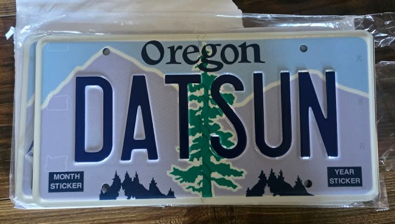

Dguy210 Posted May 8 Author Report Share Posted May 8 (edited) On 4/7/2026 at 1:51 PM, Draker said: luv 4est ? Plates came in 😁 Edited May 8 by Dguy210 6 Quote Link to comment
Draker Posted May 9 Report Share Posted May 9 17 hours ago, Dguy210 said: Plates came in 😁 serious!! lol wow 1 Quote Link to comment
Dguy210 Posted May 9 Author Report Share Posted May 9 34 minutes ago, Draker said: serious!! lol wow Yep, not sure how they weren't taken currently so I jumped on it. 2 Quote Link to comment

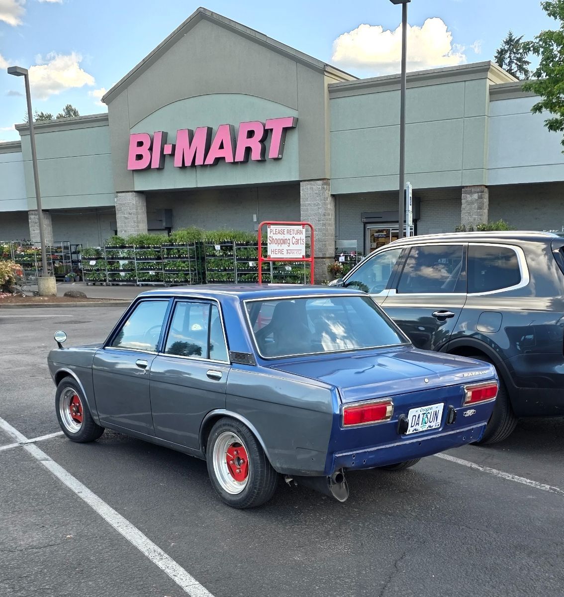

Dguy210 Posted May 19 Author Report Share Posted May 19 Long shakedown run today as the weather was nice. Car is basically ready for the summer shows. I'll keep doing some minor stuff here and there, but is basically finished for now minus a few pieces of trim. 3 Quote Link to comment
Rustbin Posted May 19 Report Share Posted May 19 The modern car looks kind of bloated and fat next to your 510. 1 Quote Link to comment
Dguy210 Posted May 19 Author Report Share Posted May 19 2 minutes ago, Rustbin said: The modern car looks kind of bloated and fat next to your 510. Lol, true, and I consider the 510 the bigger of the Datsun's I have too compared to the B110 and B210. 1 Quote Link to comment
Rustbin Posted May 19 Report Share Posted May 19 When my Toyota wagon was on the road people were always looking down on me, but I could park easier than any of them. 1 Quote Link to comment
