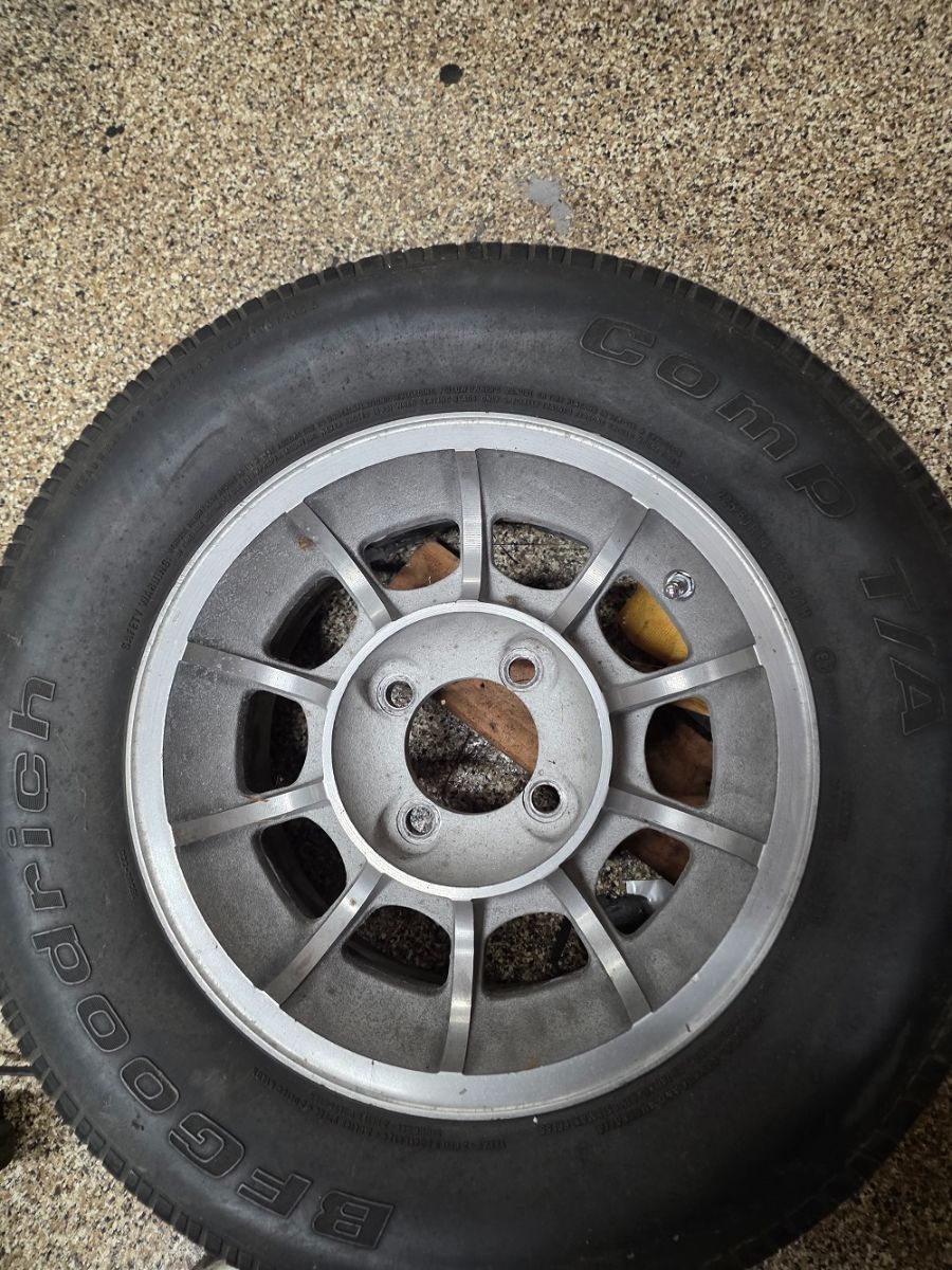

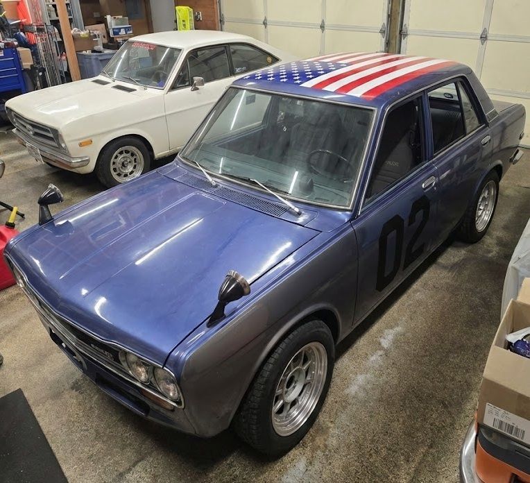

Dguy210 Posted February 22 Author Report Share Posted February 22 (edited) Hmm... I think I still have all 4 of these, tires are too big to likely test fit them though and I'd need to dig up a set of the correct shank lug nuts to run them. American Racing Vector "turbine" style wheels. Of course if I run those with a blue car.. it needs a number on the side of the door an American flag on the roof and I will call it the General Sherman (AI did some interesting things with that pic here). Edited February 22 by Dguy210 Quote Link to comment

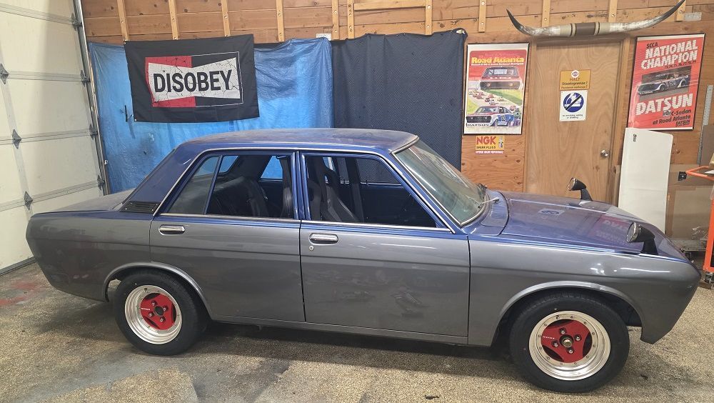

Dguy210 Posted February 22 Author Report Share Posted February 22 (edited) Parking brake wasn't working and I thought it was just the cable being too loose...well some tightening later and a bit of playing around with it turns out the cables are rusted solid inside the housing that goes over the rear subframe to the back hubs. Pulled them and having them soaking in a mix of ATF and PB blaster currently but I'm feeling like they will probably just need to be replaced. First time I've seen that though, they were a right bitch to pull out too as the clips and everything associated with them was stuck. Edit: was able to find some NOS 610 rear parking brake cables which *look* close enough to work. Still have the other cables soaking, probably will toss them into the ultrasonic cleaner if I can remember where I moved it too. But not holding out a lot of hope for them ever freeing up. Edited February 22 by Dguy210 2 Quote Link to comment
Rustbin Posted February 23 Report Share Posted February 23 I have had the brake cables rusted solid on many of my Datsuns over the years so now I usually don't use the park brake regardless of what I'm driving. 1 Quote Link to comment

tr8er Posted February 27 Report Share Posted February 27 On 2/21/2026 at 3:09 PM, Dguy210 said: Hmm... I think I still have all 4 of these, tires are too big to likely test fit them though and I'd need to dig up a set of the correct shank lug nuts to run them. American Racing Vector "turbine" style wheels. Of course if I run those with a blue car.. it needs a number on the side of the door an American flag on the roof and I will call it the General Sherman (AI did some interesting things with that pic here). lol. I do like the wheels though. Quote Link to comment
banzai510(hainz) Posted February 27 Report Share Posted February 27 I got these trying to get rid of. 500 bucks local pick up needs new rear tire minimum Covington to Wa. 15x7 +25mm for stock 510 strut. NOT 280ZX strut(rim will hit strut) 2 Quote Link to comment
Dguy210 Posted February 28 Author Report Share Posted February 28 5 hours ago, banzai510(hainz) said: I got these trying to get rid of. 500 bucks local pick up needs new rear tire minimum Covington to Wa. 15x7 +25mm for stock 510 strut. NOT 280ZX strut(rim will hit strut) That's a good price, however I have 280zx struts on pretty much everything I own :) Quote Link to comment
banzai510(hainz) Posted February 28 Report Share Posted February 28 Prices really went up on wheels but $500 is still too much for the average Datsun guy. Jeff Hino(Icehouse on here) told me once you can put nice wheels on a beat to fuck 510 and it will be GANGSTA you can have a $5000-10K 510 and put some dated wheels on there and it killed the value of the whole car Quote Link to comment
Dguy210 Posted February 28 Author Report Share Posted February 28 19 minutes ago, banzai510(hainz) said: Prices really went up on wheels but $500 is still too much for the average Datsun guy. Jeff Hino(Icehouse on here) told me once you can put nice wheels on a beat to fuck 510 and it will be GANGSTA you can have a $5000-10K 510 and put some dated wheels on there and it killed the value of the whole car Lol, it's $400-$500 just for some non-shit tier tires these days, installation alone is $100 over the price of the tire. I'm kinda just leaning towards playing musical chairs with the wheels I have as I can only drive 1 car at a time anyways. 2 Quote Link to comment

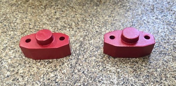

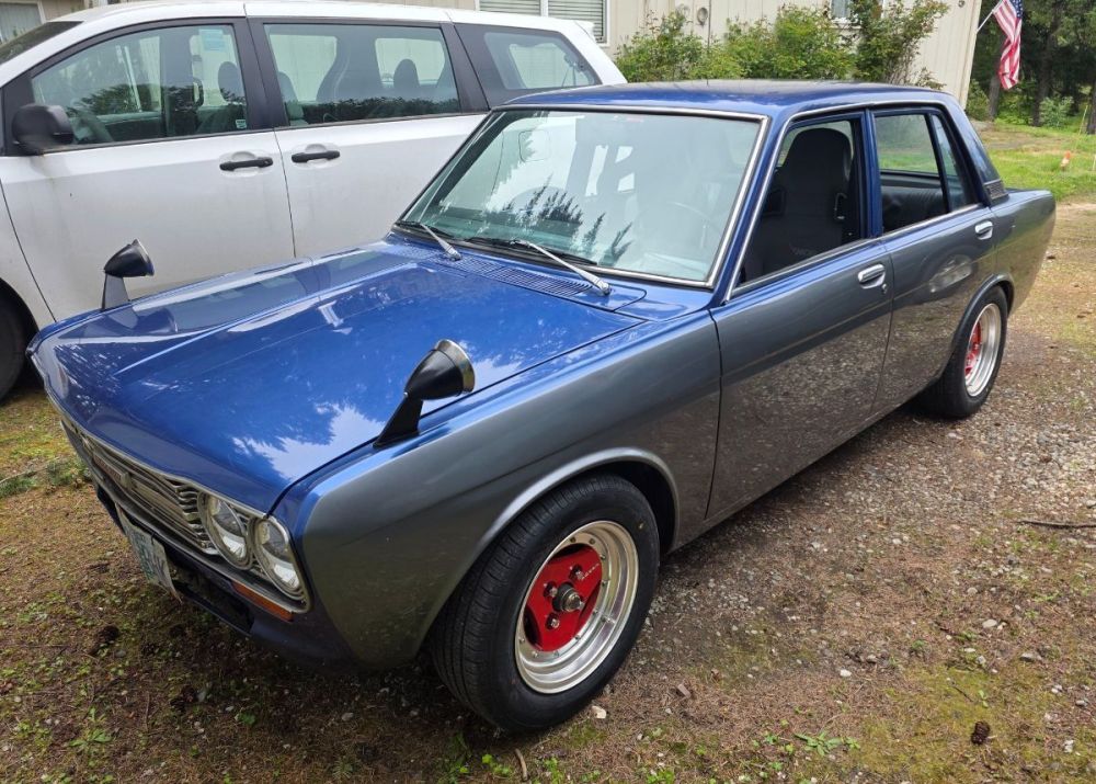

Dguy210 Posted March 16 Author Report Share Posted March 16 (edited) Ended up using 610 parking brake cables which seem to be identical or at least interchangeable to the 510 so now the parking brake works. Still needs the bumpsteer spacers installed. Tires are 185/65R14. Probably still needs some minor suspension adjustment. I've got a center cap designed up and test printed, just need to print up 4 of them. Been testing them printed in TPU and PCTG not sure which I like better at the moment though. Been pushing on this lately as I'm aiming to have this drivable to Powerland in July but will need some road hours on it first. Next up on the big costs will be insurance and registration. Edited March 16 by Dguy210 3 Quote Link to comment

Draker Posted March 19 Report Share Posted March 19 On 3/15/2026 at 8:04 PM, Dguy210 said: Ended up using 610 parking brake cables which seem to be identical or at least interchangeable to the 510 so now the parking brake works. Still needs the bumpsteer spacers installed. Tires are 185/65R14. Probably still needs some minor suspension adjustment. I've got a center cap designed up and test printed, just need to print up 4 of them. Been testing them printed in TPU and PCTG not sure which I like better at the moment though. Been pushing on this lately as I'm aiming to have this drivable to Powerland in July but will need some road hours on it first. Next up on the big costs will be insurance and registration. Can't wait to see it in person! 1 Quote Link to comment

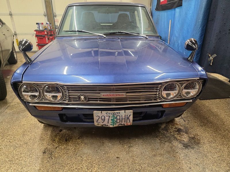

Dguy210 Posted April 4 Author Report Share Posted April 4 On 3/19/2026 at 10:20 AM, Draker said: Can't wait to see it in person! 510 is now registered and insured! Now, we just need to see if they approve the custom license plate I asked for....😁 2 1 Quote Link to comment

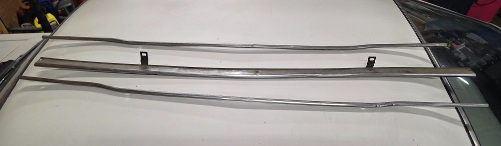

Dguy210 Posted April 7 Author Report Share Posted April 7 (edited) Got some time in the shop so cleaned up and mounted the trim bits. For the eyebrow trim I weirdly have two driver sides in very good shape and no passenger side. Edit: installed the one side I had. Edited April 7 by Dguy210 Quote Link to comment
Draker Posted April 7 Report Share Posted April 7 On 4/3/2026 at 5:24 PM, Dguy210 said: 510 is now registered and insured! Now, we just need to see if they approve the custom license plate I asked for....😁 luv 4est ? 2 Quote Link to comment
