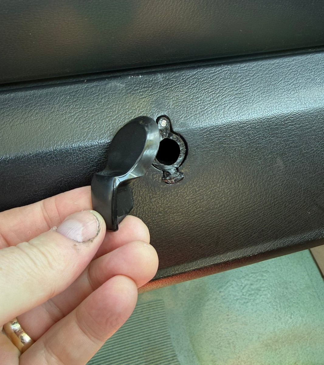

wayno Posted March 16 Report Share Posted March 16 On 3/10/2026 at 10:35 AM, andyZ00m said: Did some diging and my steering is totally fine. Not gunna fix it if it aint broke. One thing I cant find... this fricken glove box knob. Anyone got one of these? I have a few of these, but they are used, PM me. Quote Link to comment

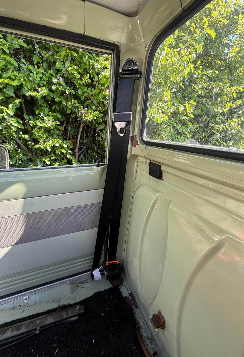

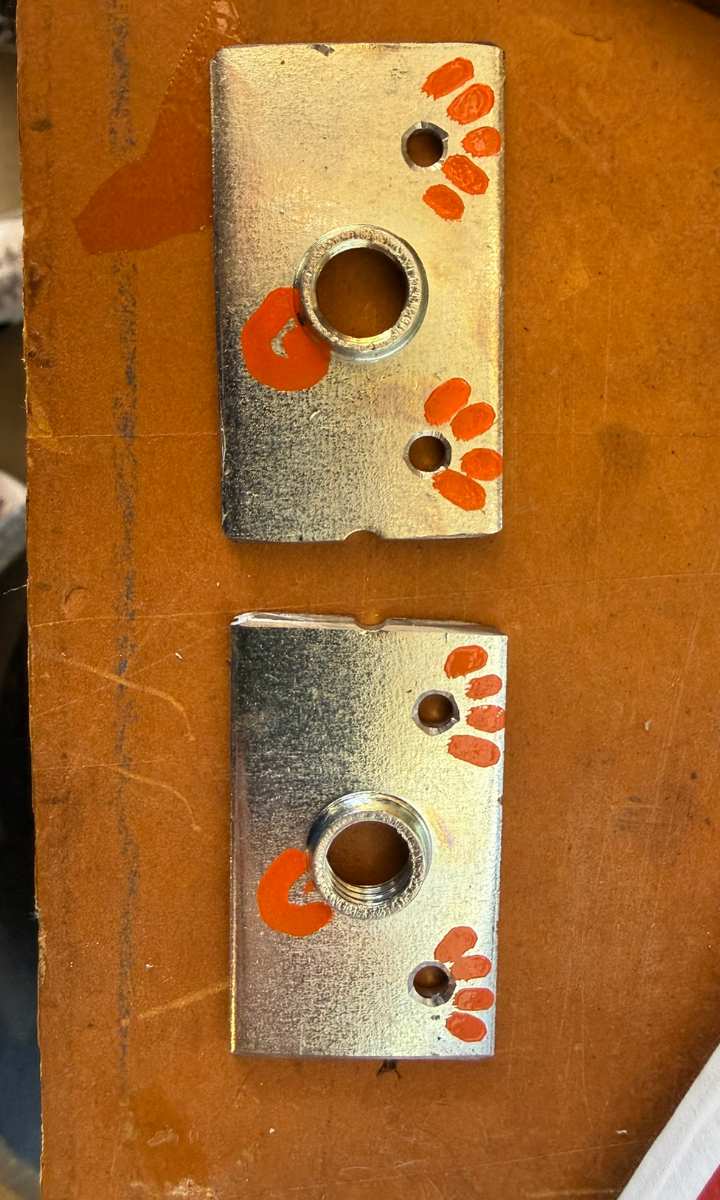

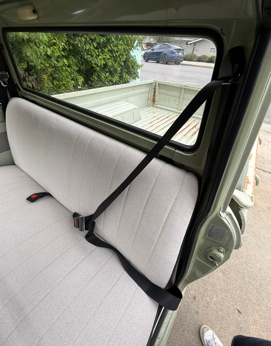

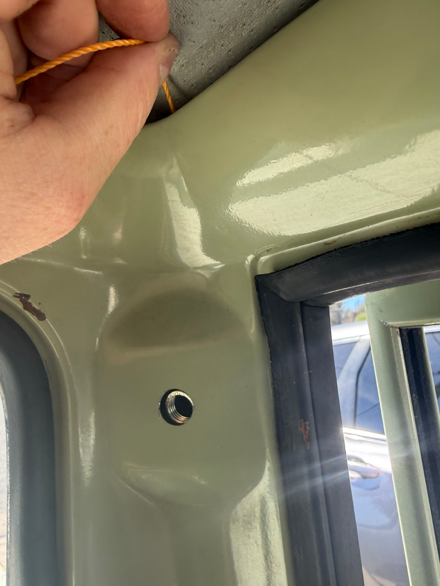

andyZ00m Posted March 29 Author Report Share Posted March 29 Got new three point belts in and ready for the new seat upholstery which I go pickup tomorrow. Got new wheels and tires as I didnt like the bigger/wider 16" wheels. Went with 15x5 boyd steelies and Michelin 165R-15 XZX (spendy but really fricken nice). Those go on tomorrow as well once I can take them to the tire shop. The Boyd Coddington 15" fit over the large 13" discs in front without rubbing the calipers and bring the profile and overall diameter back to stock. Should look awesome. Also, thanks to Wayno, I got the glove box knob back in action. Appreciate it man!! Had to cut down the seatbelt brackets a bit to fit in the flat spot of the b pillar. Used the two holes to align with the string and then hot glued the inside of the bracket and pulled it into the pressure fit hole I drilled in the B pil;lar with an allen key to keep it in place enough to get the bolt in. Then used a second smaller hole with a screw driver jammer in there to keep the plate from spinning while I tightened the bolt. Worked well and didnt need to weld or rivet! Quote Link to comment
andyZ00m Posted March 29 Author Report Share Posted March 29 Finished job! Now I can take the kids in the truck! 4 1 Quote Link to comment

andyZ00m Posted March 31 Author Report Share Posted March 31 Got the new seat in. Material turned out to be a but lighter than I wanted but its all good. Quote Link to comment
andyZ00m Posted March 31 Author Report Share Posted March 31 (edited) Belt fits me perfectly and is super comfy in the seat. Super happy with the result! Edited March 31 by andyZ00m 1 Quote Link to comment
