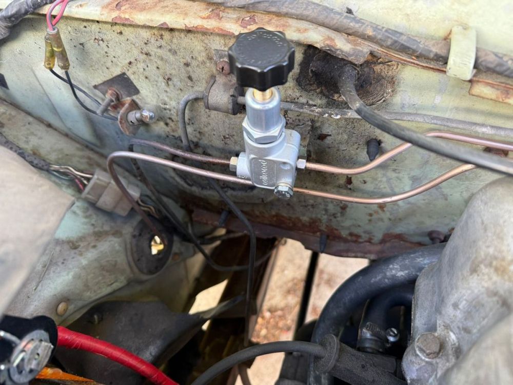

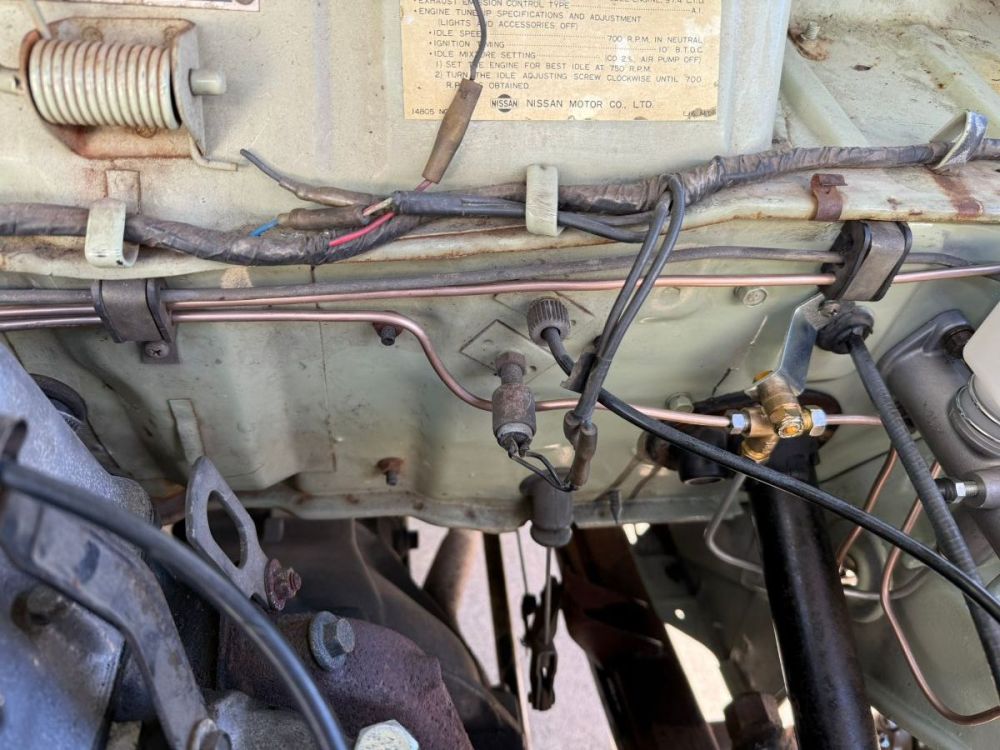

andyZ00m Posted March 23, 2025 Author Report Share Posted March 23, 2025 Hey Mike, I do have front discs now! That was the whole impetus for this upgrade actually. I’ve looked into the booster thing and the trick is gunna be finding the pedestal/booster combo that will work without modifying the firewall and existing mounting hardware. I would like to do it. I’ve found the booster with the correct mounting plate for my MS but I would probably need to fabricate the pedestal. Quote Link to comment

datzenmike Posted March 23, 2025 Report Share Posted March 23, 2025 You have the vertical mount MC the most common so just about any Datsun with a booster will work other than z cars and 810/Maxima. My 15/16" early 280zx MC fit right to my 710 booster. Quote Link to comment
andyZ00m Posted March 23, 2025 Author Report Share Posted March 23, 2025 2 hours ago, datzenmike said: You have the vertical mount MC the most common so just about any Datsun with a booster will work other than z cars and 810/Maxima. My 15/16" early 280zx MC fit right to my 710 booster. But I’d still need the pedestal. That’s the tricky part! Quote Link to comment

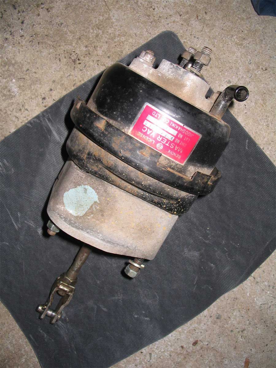

ggzilla Posted March 23, 2025 Report Share Posted March 23, 2025 when you shop with Ratsun-preferred suppliers the pedestal comes with the booster, like this Datsun B210 booster 1 1 Quote Link to comment

ggzilla Posted March 23, 2025 Report Share Posted March 23, 2025 Nah, i meant a junkyard like pick-n-pull. Their parts often come more complete than the fancy-schmancy new part companies 18 minutes ago, andyZ00m said: Are you, perhaps, one of the Ratsun preferred suppliers…? Quote Link to comment
andyZ00m Posted March 23, 2025 Author Report Share Posted March 23, 2025 14 minutes ago, ggzilla said: Nah, i meant a junkyard like pick-n-pull. Their parts often come more complete than the fancy-schmancy new part companies The pick and pull in my area never has ANY Datsun stuff, but might be worth making another trek. Haven’t seen the one you linked a photo of but that actually looks like it would fit next to the clutch MS in the 521. Quote Link to comment

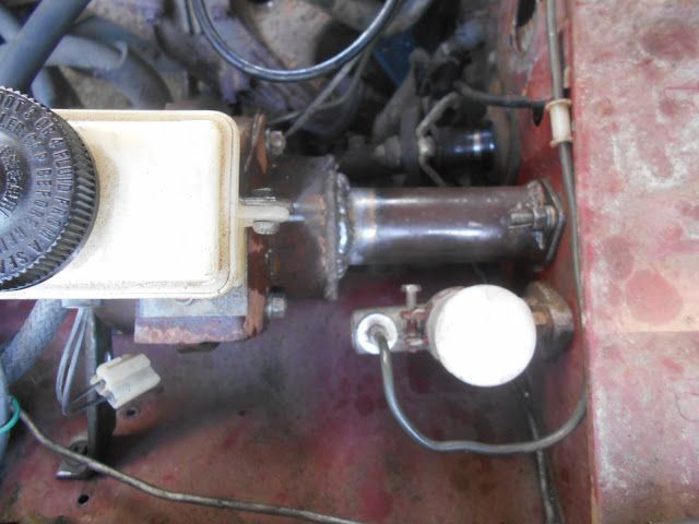

wayno Posted March 24, 2025 Report Share Posted March 24, 2025 You do what you have to do guy, make what you need, but first you have to buy what you are going to use, the booster and brake master you are going to use, I believe I would use the 1973/74 Datsun 620 booster, but you need the master brake mount plate also, you also need the shaft from the booster to the brake pedal that is the right length or longer so you can cut it too length, I recall I used a Ford Courrier brake master and remote reservoir. You are starting with a 521, I started with a 520 and had to install a 521 brake pedal assembly first, check out this thread, I had to get the brake master away from the engine/intake first. https://www.nwdatsuns.com/phpbb/viewtopic.php?p=61088#p61088 I made this pedestal to fit this booster(unsure what booster is), it was complicated, pedestals are easy to make if you can weld. If you go down 5+ photos you can see the braces I made to stabilize the end of the brake master so it does not flex when stepping hard on the brake. If you cannot weld, make the parts yourself and have/pay someone weld it for you, if you lived near me, I would weld it for you, if you go down to post 169 you can see the dual SU install, I even made my own gaskets, post 174 has it finished with filters installed. It has been a long time since I did this, I had a heart attack the next day(May 9, 2016). 1 Quote Link to comment

ggzilla Posted March 24, 2025 Report Share Posted March 24, 2025 So making a pedestal is not too difficult Wayne, you only used that long pedestal to clear the dual-sidedraft carburetor setup? The booster you had before on your 520 looks like a stock 4.5" Datsun Master-Vac but with shorter pedestal than the B210 version (or maybe it used no pedestal at all) 4 hours ago, wayno said: Here is what it used to look like. 4 hours ago, wayno said: made this pedestal to fit this booster(unsure what booster is), it was complicated, pedestals are easy to make if you can weld. 1 Quote Link to comment

wayno Posted March 25, 2025 Report Share Posted March 25, 2025 (edited) 21 hours ago, ggzilla said: So making a pedestal is not too difficult Wayne, you only used that long pedestal to clear the dual-sidedraft carburetor setup? The booster you had before on your 520 looks like a stock 4.5" Datsun Master-Vac but with shorter pedestal than the B210 version (or maybe it used no pedestal at all) I had to do a lot to clearance the brake master for the dual SUs , keep in mind that this is an early 1966 Datsun 520, there was a lot of room between the brake master and the clutch master in that first 520 firewall photo you quoted, I had to remove the 520 brake/clutch pedal assembly and install a 521 brake/clutch pedal assembly, the 521 brake booster/master is installed in the 520 clutch assembly hole, I made a new hole next to the old clutch mount position to work with the 521 pedal assembly. The pedestal I made was to clear the clutch master using the 521 pedal assembly. I do not remember what that booster was from anymore, I think it was a 620 pedestal/booster, but I parted out a 1981 Datsun 310 at one time and it might have been from that, then I made a pedestal to fit that booster, it has been too long for me to remember everything. Edited March 25, 2025 by wayno 2 Quote Link to comment
