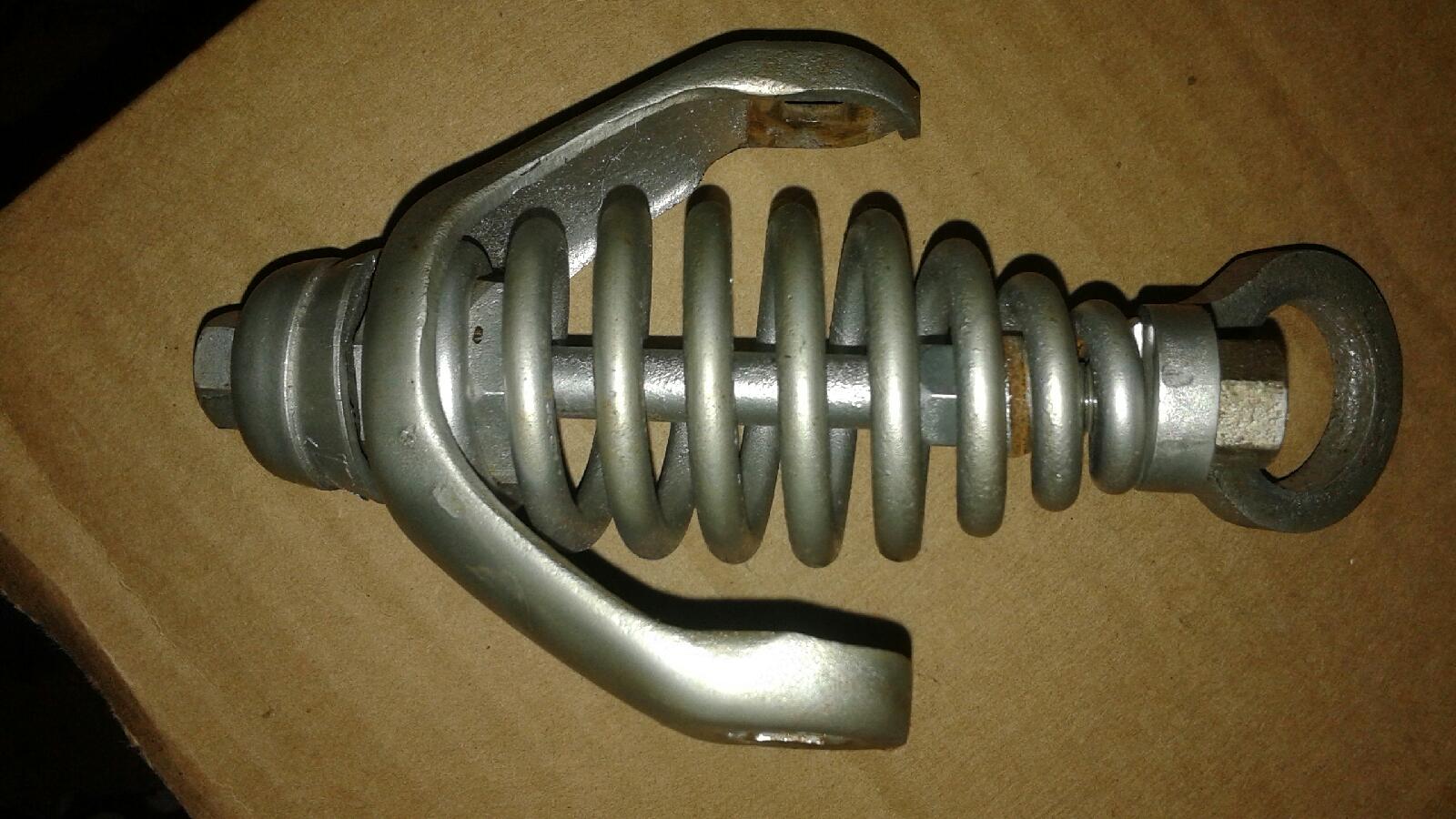

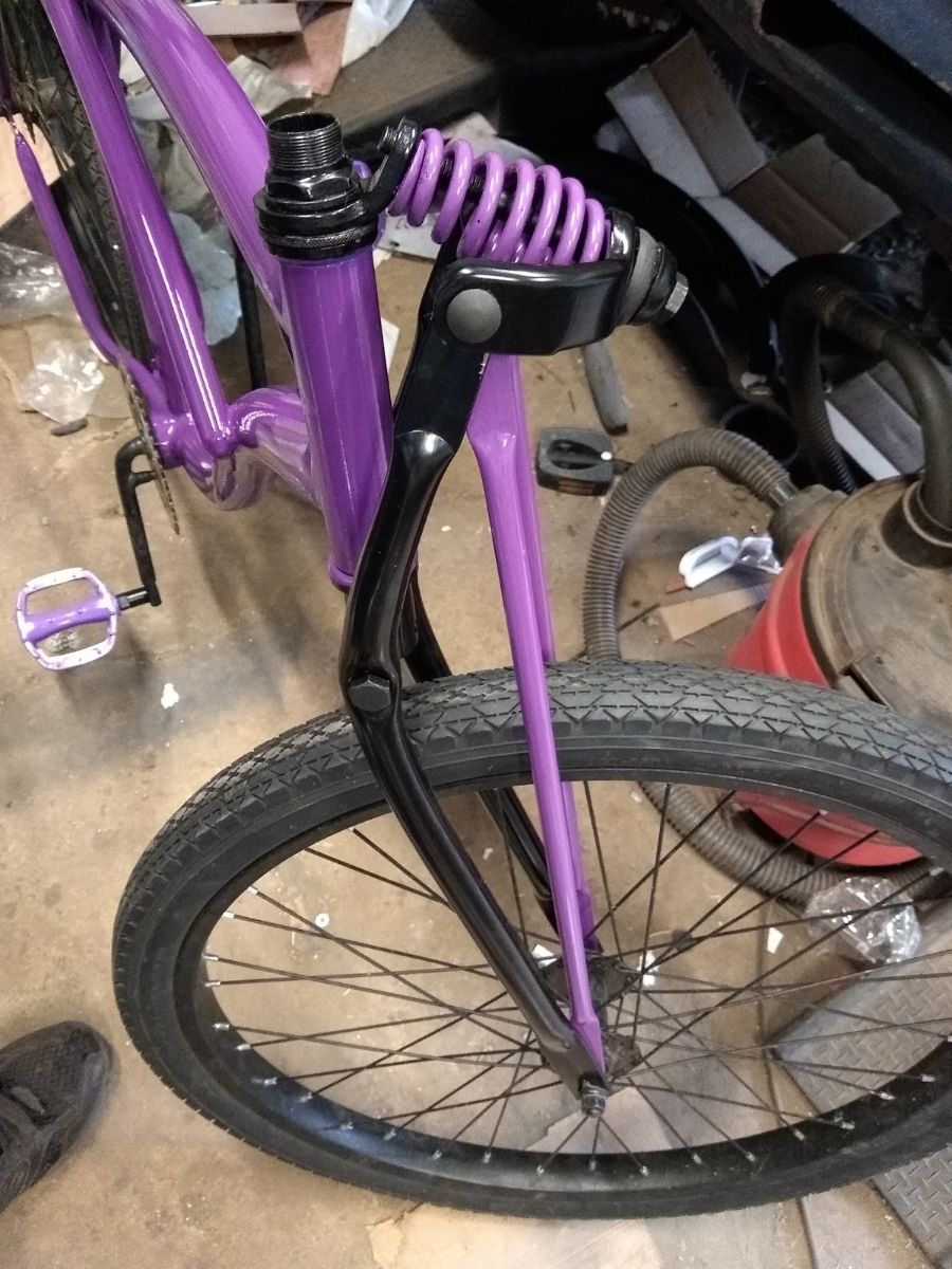

Chopper Jim Posted November 14, 2022 Report Share Posted November 14, 2022 Remember to reverse the spring on the fork. Adds just a little more rake to the fork. Chopper Jim Quote Link to comment
datsunfreak Posted November 14, 2022 Report Share Posted November 14, 2022 23 minutes ago, Chopper Jim said: Remember to reverse the spring on the fork. Adds just a little more rake to the fork. Need more info on this please. 😁 1 Quote Link to comment
dimlight65 Posted November 14, 2022 Author Report Share Posted November 14, 2022 (edited) 1 hour ago, Chopper Jim said: Remember to reverse the spring on the fork. Adds just a little more rake to the fork. Chopper Jim I've been grokking my photo of the fork... Do you mean move the spring to the rear of the head tube? That would increase the rake considerably! Edited November 14, 2022 by dimlight65 Epiphany! 1 Quote Link to comment
Chopper Jim Posted November 15, 2022 Report Share Posted November 15, 2022 Yes. We used to do that when I was a kid in the dark ages. Chopper Jim 2 Quote Link to comment

datsunfreak Posted November 15, 2022 Report Share Posted November 15, 2022 3 hours ago, Chopper Jim said: Yes. We used to do that when I was a kid in the dark ages. Chopper Jim So are you saying you just took the spring out and installed it backwards? 1 Quote Link to comment

Chopper Jim Posted November 16, 2022 Report Share Posted November 16, 2022 20 hours ago, datsunfreak said: So are you saying you just took the spring out and installed it backwards? Yes sir. Just doesn't have the spring effect, but it was sure cool. Chopper Jim 1 Quote Link to comment
Duncan Posted November 16, 2022 Report Share Posted November 16, 2022 55 minutes ago, Chopper Jim said: Yes sir. Just doesn't have the spring effect, but it was sure cool. Chopper Jim Sound just like putting 3" lowering blocks on a Datsun wagon. Rides like a logging truck, but looks good doing it! 🙂 3 Quote Link to comment

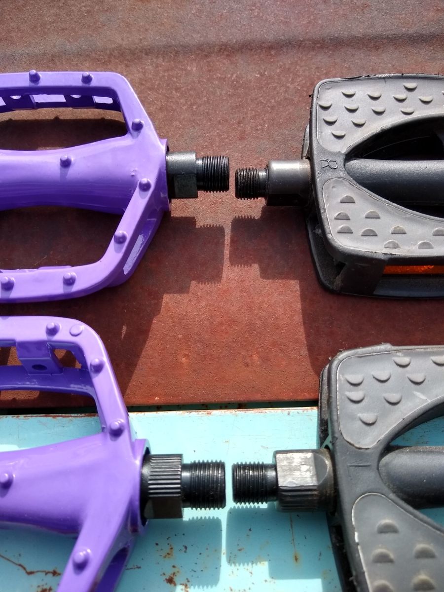

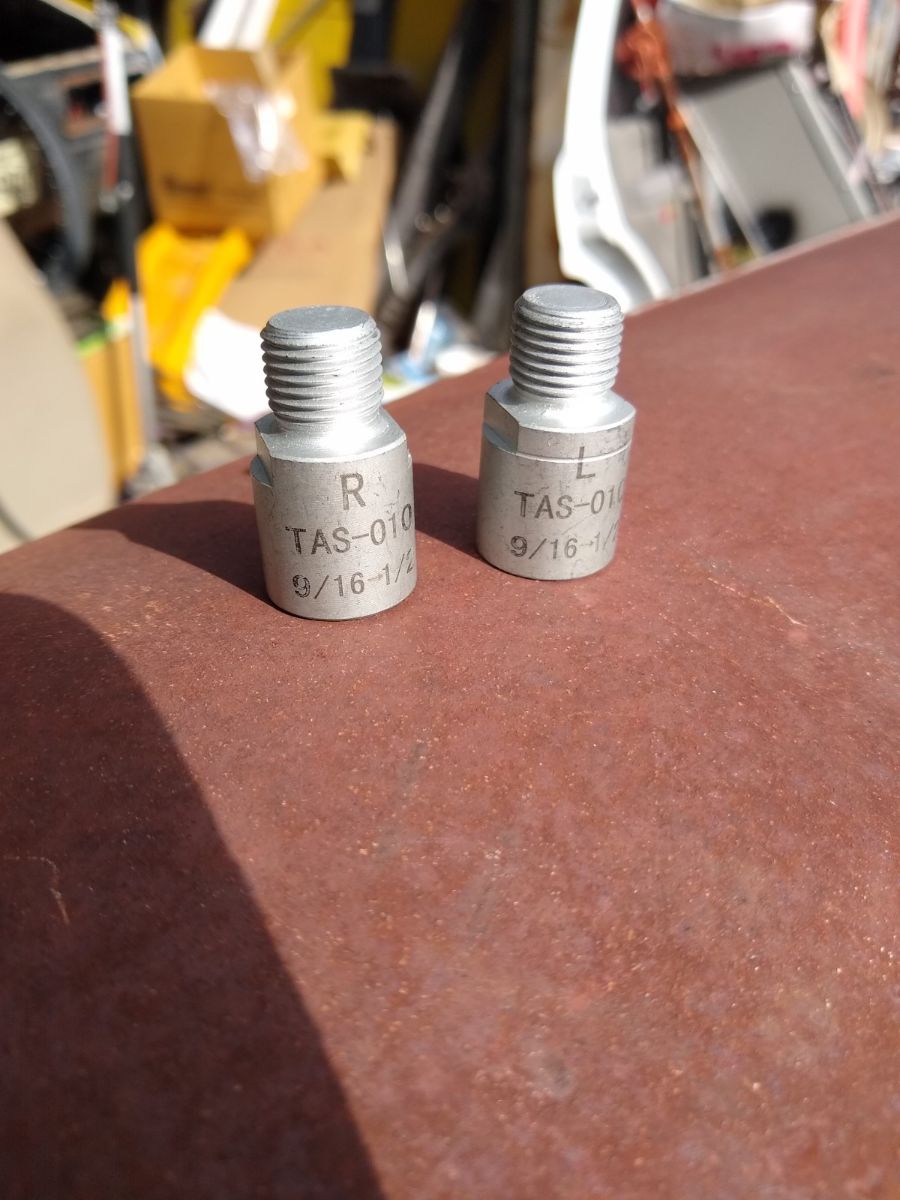

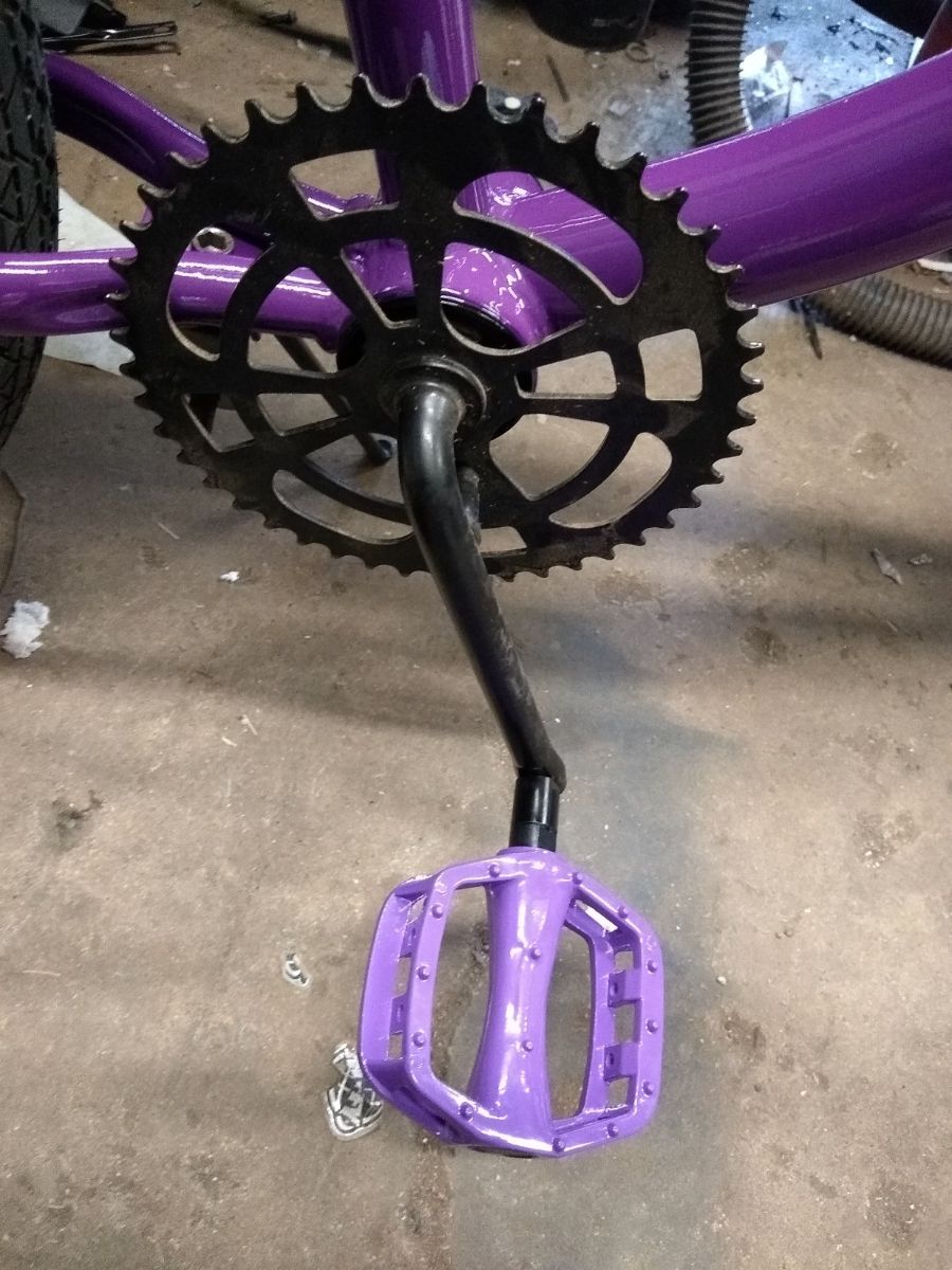

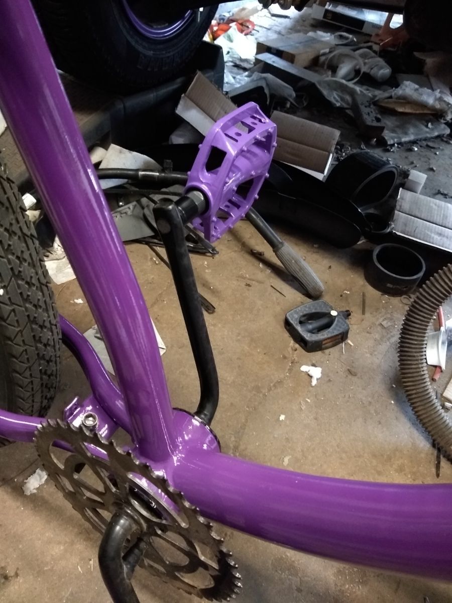

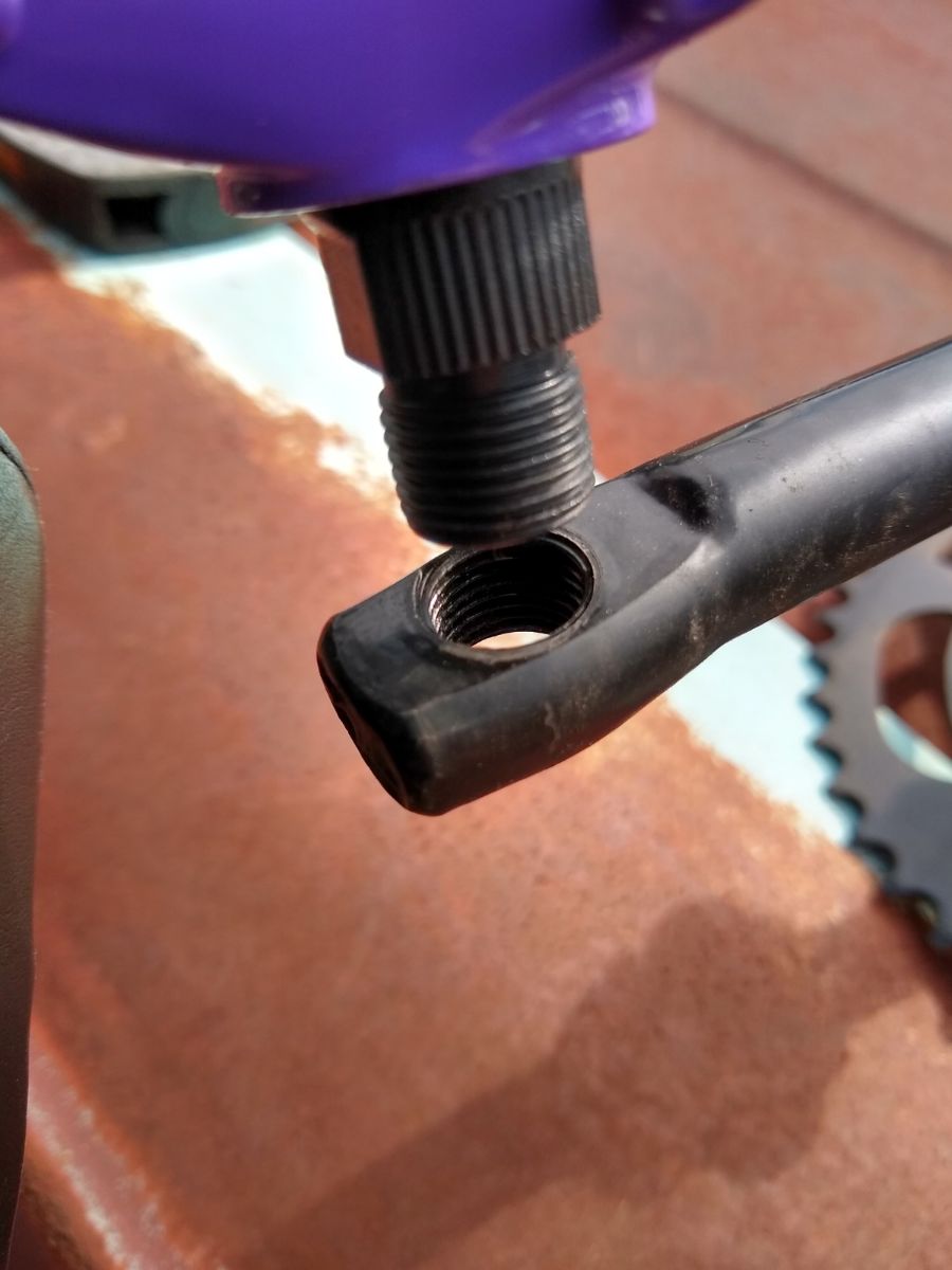

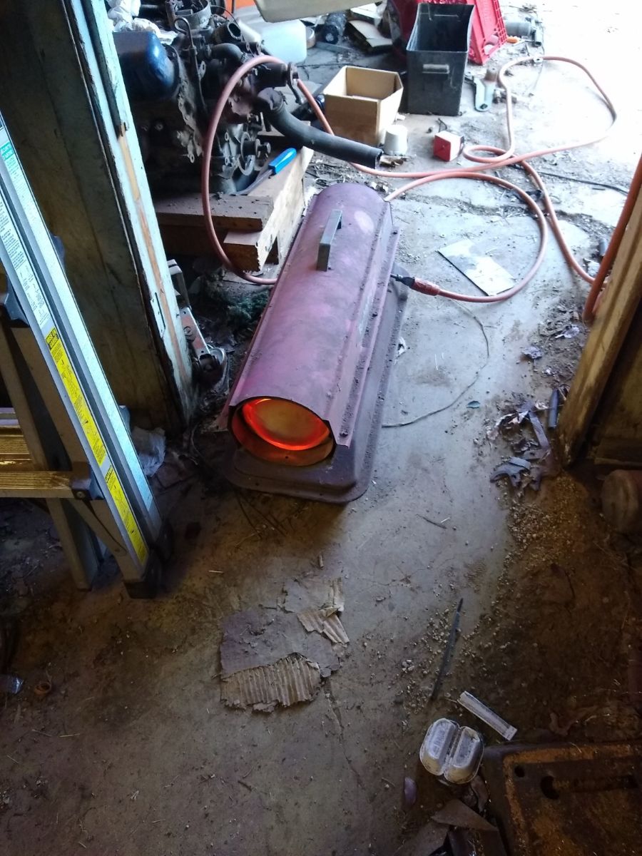

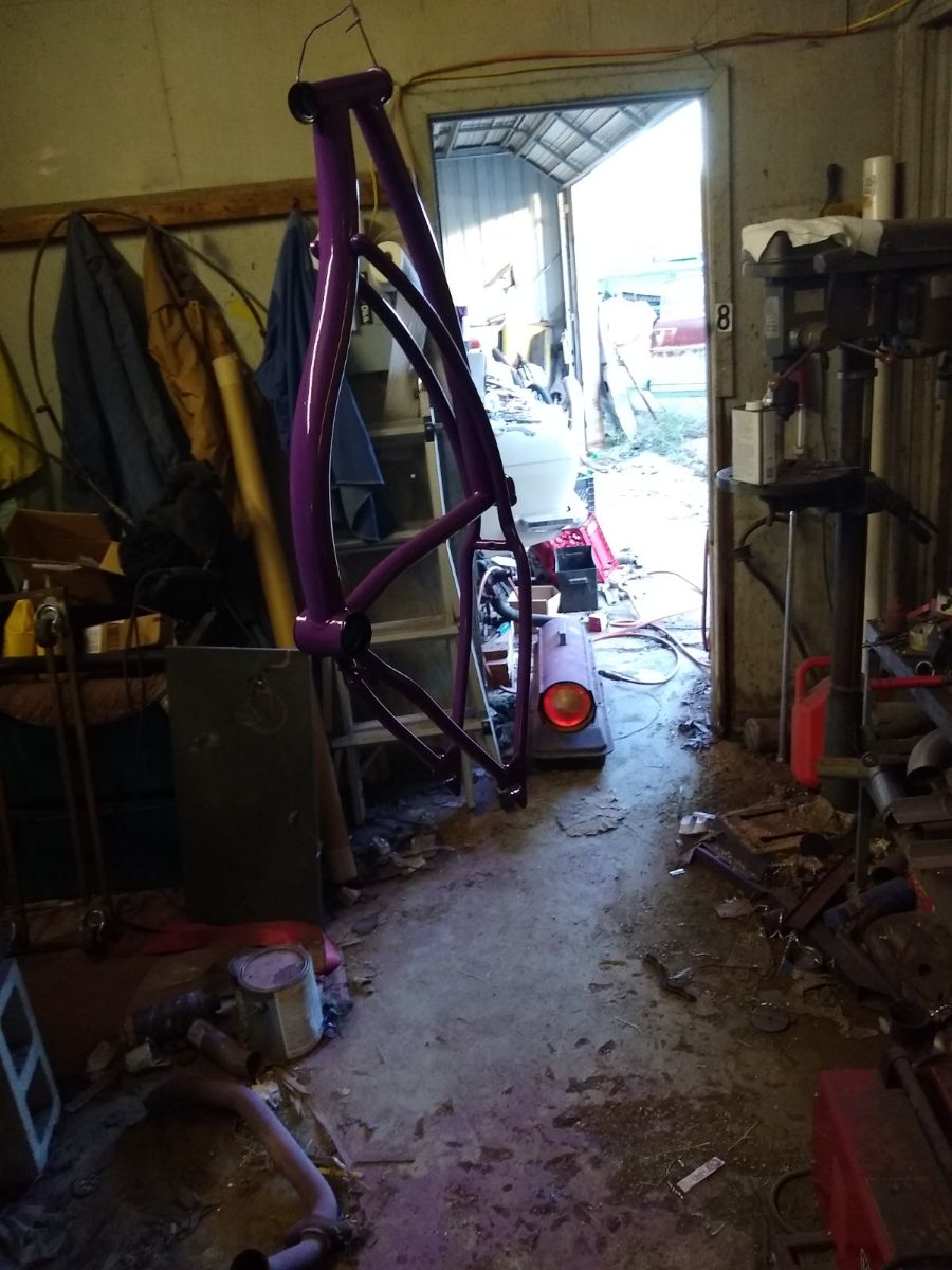

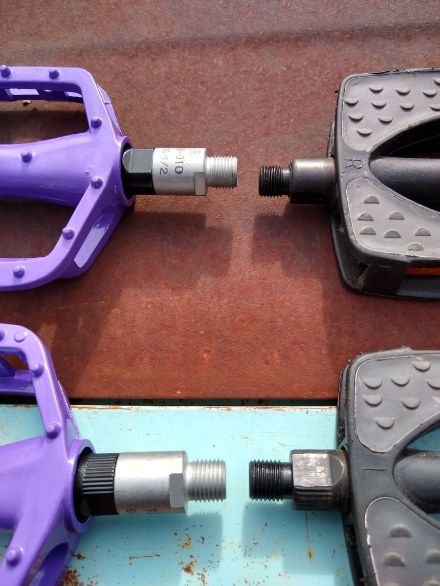

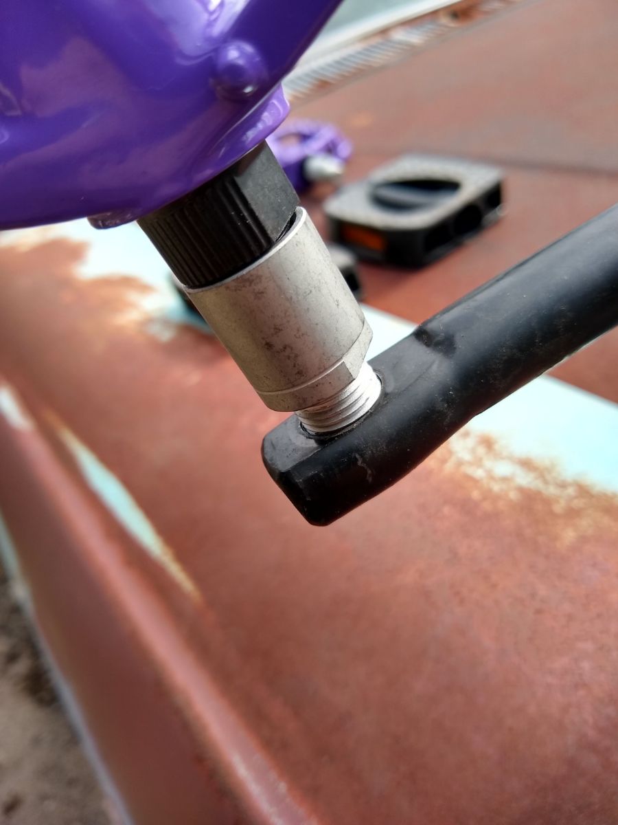

dimlight65 Posted November 17, 2022 Author Report Share Posted November 17, 2022 Discovered a problem the other day. The purple pedals are 9/16" male whereas the crank set is 1/2" female. Because the Cranbrook's pedals are 1/2" male... Well, that's just not going to do! So I bought a set of 1/2" to 9/16" pedal adapter thingies... And screwed them on... And now my bitchin' purple pedals fir my cranks! We then fired up the space heater to warm the frame... To apply several coats of clear on top of the purple... Saturday we assemble! Of course the purple chain won't arrive until Monday, so... next week we ride! 1 Quote Link to comment
Ooph! Posted November 17, 2022 Report Share Posted November 17, 2022 1 hour ago, dimlight65 said: Discovered a problem the other day. The purple pedals are 9/16" male whereas the crank set is 1/2" female. Because the Cranbrook's pedals are 1/2" male... Well, that's just not going to do! So I bought a set of 1/2" to 9/16" pedal adapter thingies... And screwed them on... And now my bitchin' purple pedals fir my cranks! If that were my bike I'd never ever stand on those pedals because someday... oh snap! 1 Quote Link to comment
datsunfreak Posted November 17, 2022 Report Share Posted November 17, 2022 9 hours ago, Ooph! said: If that were my bike I'd never ever stand on those pedals because someday... oh snap! They are plastic, but they have a 1/2" steel rod running through them. 😉 1 Quote Link to comment
dimlight65 Posted November 17, 2022 Author Report Share Posted November 17, 2022 (edited) 7 hours ago, datsunfreak said: They are plastic, but they have a 1/2" steel rod running through them. 😉 The pedals are aluminum actually. But I think he might have been referring to the adapters (which I'm 99.426573% certain are steel) and it is a concern I had as well. Edited November 17, 2022 by dimlight65 1 Quote Link to comment

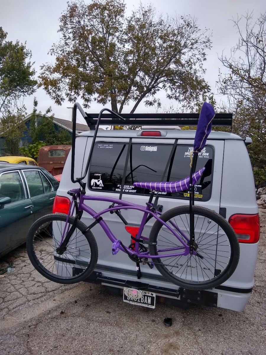

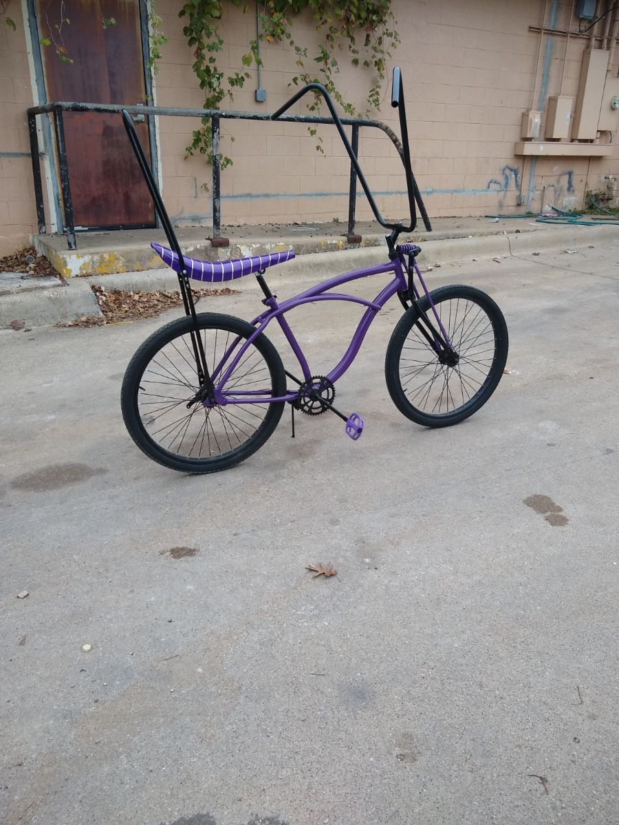

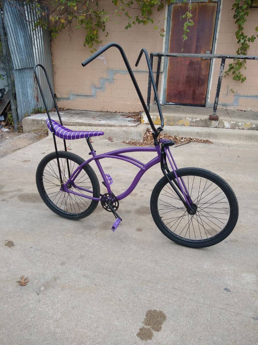

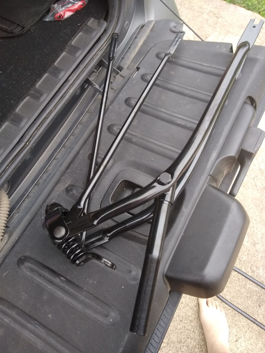

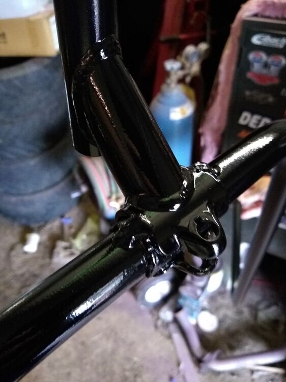

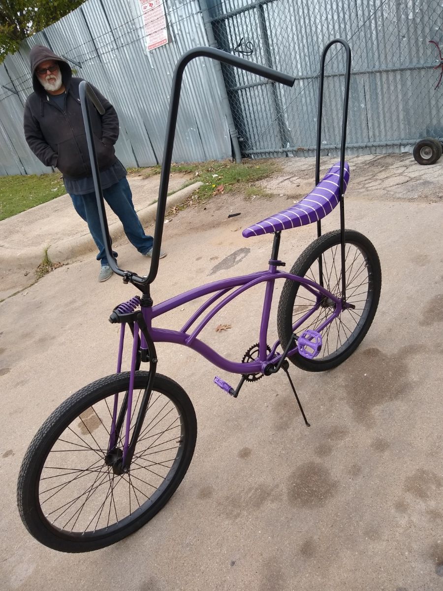

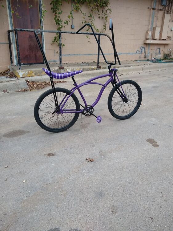

dimlight65 Posted November 19, 2022 Author Report Share Posted November 19, 2022 (edited) We made assembling today! First I assembled the springer fork and we wrestled it into the frame. Then, after we determined the correct angle for the handlebars, I tacked them to the stem and John hit them with some paint. While I was welding, John also installed the crankset and pedals. We installed the handlebars and rolled it out for a photo op John photobomb! Then we installed and tested the bike rack on the Dajiban! The chain should be here Monday. So we'll install that and the grips Wednesday (waiting for the handlebar's paint to get good and dry). Then... WE RIDE! Edited November 19, 2022 by dimlight65 paint, not pain 2 Quote Link to comment

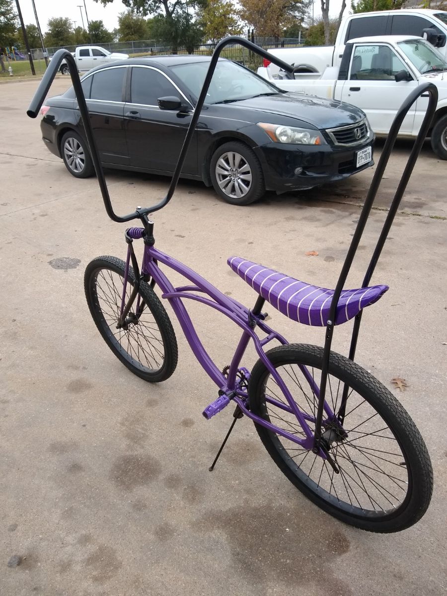

paradime Posted November 20, 2022 Report Share Posted November 20, 2022 18 hours ago, dimlight65 said: I'm not sure if I will subject y'all to the shorts though! What, no shorts? Jip! The bike is money for sure, but I'm thinking it might need a headrest and lumbar pad on the sissy bar. Kind of a recliner recumbent seating position. That and the shorts, dude you'll have to fight the girls off. 2 Quote Link to comment
datzenmike Posted November 20, 2022 Report Share Posted November 20, 2022 31 minutes ago, paradime said: The bike is money for sure, but I'm thinking it might need a headrest and lumbar pad on the sissy bar. Kind of a recliner recumbent seating position. For looks, but the sissy bar will fold at the bolts through the banana seat. Have my doubts if the bottom half will support 3+ X the weight of 10 year old. Even Captain America's seat holds the tube frame in place rather than the tube frame holding the seat. Quote Link to comment
datsunfreak Posted November 20, 2022 Report Share Posted November 20, 2022 (edited) 19 hours ago, datzenmike said: Have my doubts if the bottom half will support 3+ X the weight of 10 year old. 1. Tim does not weigh three times what a 10-year-old boy does. 2. The stock seat post is still doing a lot of the heavy lifting. 3. We won't be taking it off any sweet jumps, just cruising. 4. If it bends, we'll build it back stronger. 😁 Edited November 21, 2022 by datsunfreak 1 1 Quote Link to comment
