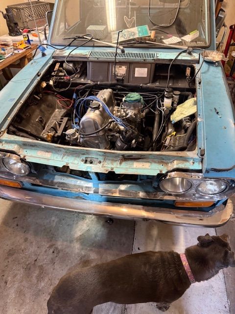

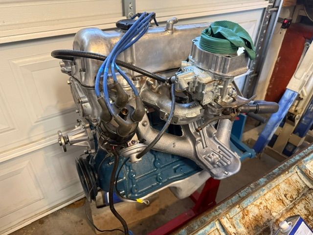

Slow Loris Posted March 25 Author Report Share Posted March 25 A little paint and a few pistons for good measure Spins nice and easy. Cam checks out ok. Rockers off to Delta for a refresh so, on pause til they come back. Pause? I mean painting the engine bay, fiddling with some seat hardware, and thinking about extending the exhaust so it doesn’t dump directly into the right rear brake drum. 2 Quote Link to comment

NC85ST Posted May 27 Report Share Posted May 27 Looks good. What is the machined aluminum piece on top of the carburetor? Quote Link to comment
rude_day Posted May 27 Report Share Posted May 27 4 hours ago, NC85ST said: Looks good. What is the machined aluminum piece on top of the carburetor? It's an adapter to be able to run the OEM intake assuming it doesn't move it too close to the hood. 1 Quote Link to comment
banzai510(hainz) Posted May 27 Report Share Posted May 27 (edited) Nigga Plz!!!!!!!!!!!! that looks good. I would have painted the oil pan black as they all get oil on there and goes black anyways . but look good to me. HOPEFULLY the oil pump has OIL in there already. otherwise your done. what I did with my 521 I took the fuel pump off and pump the arm till the carb was full of gas and accell pump squirted gas. Otherwise it can take a while, I pour oil over the rockerarms/cam arms and down the timing chain put valve cover back on . Bam th Mother fucker starteded right up if you got the dist dial close it. Edited May 27 by banzai510(hainz) 1 Quote Link to comment
Slow Loris Posted May 28 Author Report Share Posted May 28 11 hours ago, NC85ST said: Looks good. What is the machined aluminum piece Yep, adapter for the stock air cleaner. I had to shave some of the collar off the stock air cleaner clamp to get it to sit lower, but it clears ok. Quote Link to comment
Slow Loris Posted May 28 Author Report Share Posted May 28 @banzai510(hainz) thank you for the tips, yes sir pump full o oil. Couldn’t of done it without your video man. Still got a bit to go before it’s ready to fire…gotta hook up all the doodads and whutnaughts and all that fun stuff but man it feels good to get that motor off the stand! 1 Quote Link to comment
