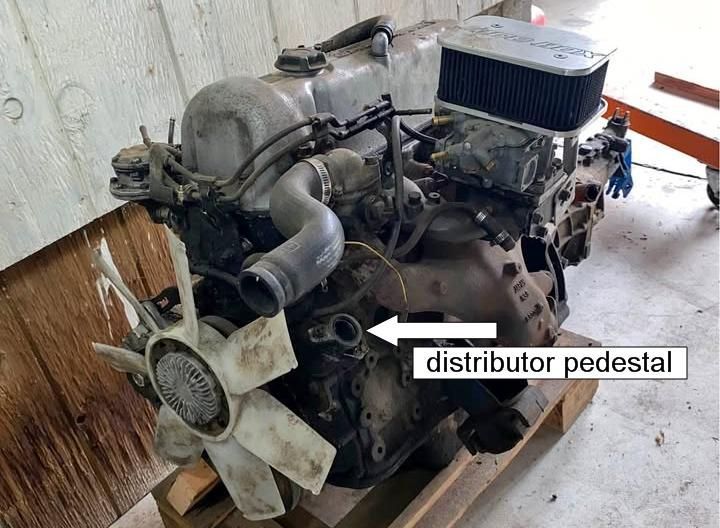

Jskinny Posted June 26, 2025 Author Report Share Posted June 26, 2025 11 minutes ago, datzenmike said: Needs a distributor and the PCV fixed. Could I swap over my existing distributor and adjust if needed or is there more to it than that? Just thinking about how direct of a swap over another L20b would be for someone with next to no experience. Whether for this one or in the future. Quote Link to comment

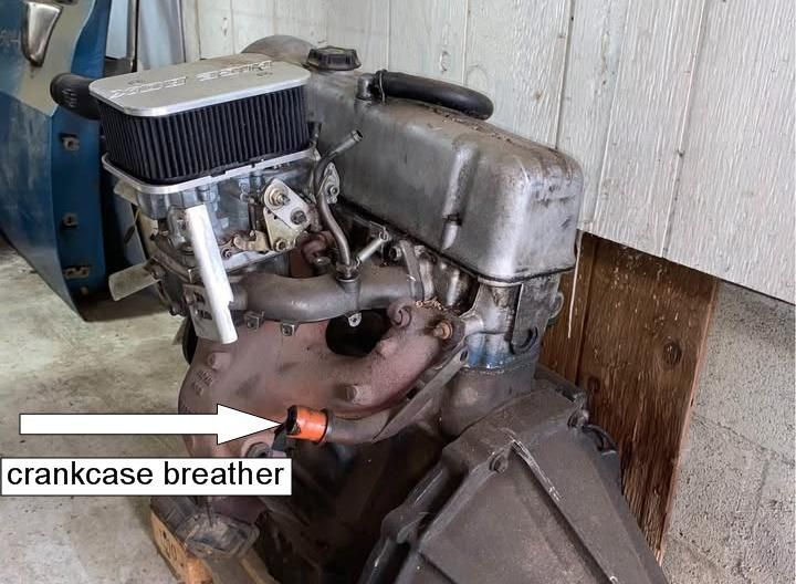

ggzilla Posted July 2, 2025 Report Share Posted July 2, 2025 Yes, it's easy and straightforward to swap a working distributor from one L-series 4-cylinder engine to any another On 6/26/2025 at 12:11 PM, Jskinny said: Could I swap over my existing distributor and adjust if needed or is there more to it than that? Just thinking about how direct of a swap over another L20b would be for someone with next to no experience. Whether for this one or in the future. Put your working distributor and its pedestal here: PCV hose missing. Use the PCV valve and hose from your existing L20B Quote Link to comment
Jskinny Posted July 2, 2025 Author Report Share Posted July 2, 2025 6 hours ago, ggzilla said: Yes, it's easy and straightforward to swap a working distributor from one L-series 4-cylinder engine to any another Put your working distributor and its pedestal here: PCV hose missing. Use the PCV valve and hose from your existing L20B So no adjustment of the points etc? Seems fairly plug and play, just connecting everything back up. Quote Link to comment
ggzilla Posted July 2, 2025 Report Share Posted July 2, 2025 If your old engine has a running distributor, then after swapping, no adjustment of the points is needed. Only setting initial timing 1 hour ago, Jskinny said: So no adjustment of the points etc? Seems fairly plug and play, just connecting everything back up. However, since points distributors -- per the owners manual -- need adjustment of the points every 3month/3000 miles, it will have to be done sooner or later Quote Link to comment
