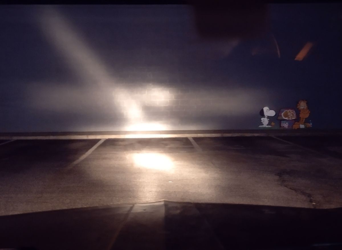

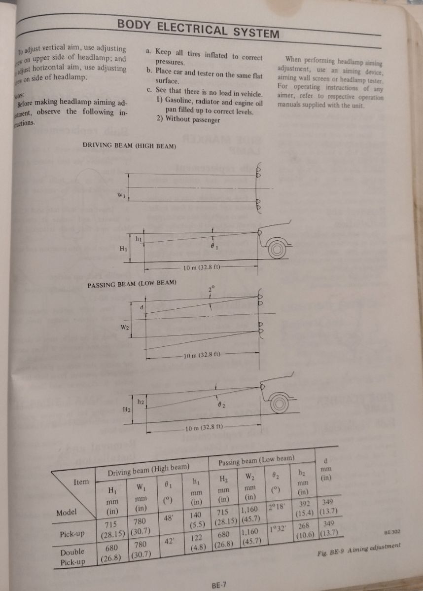

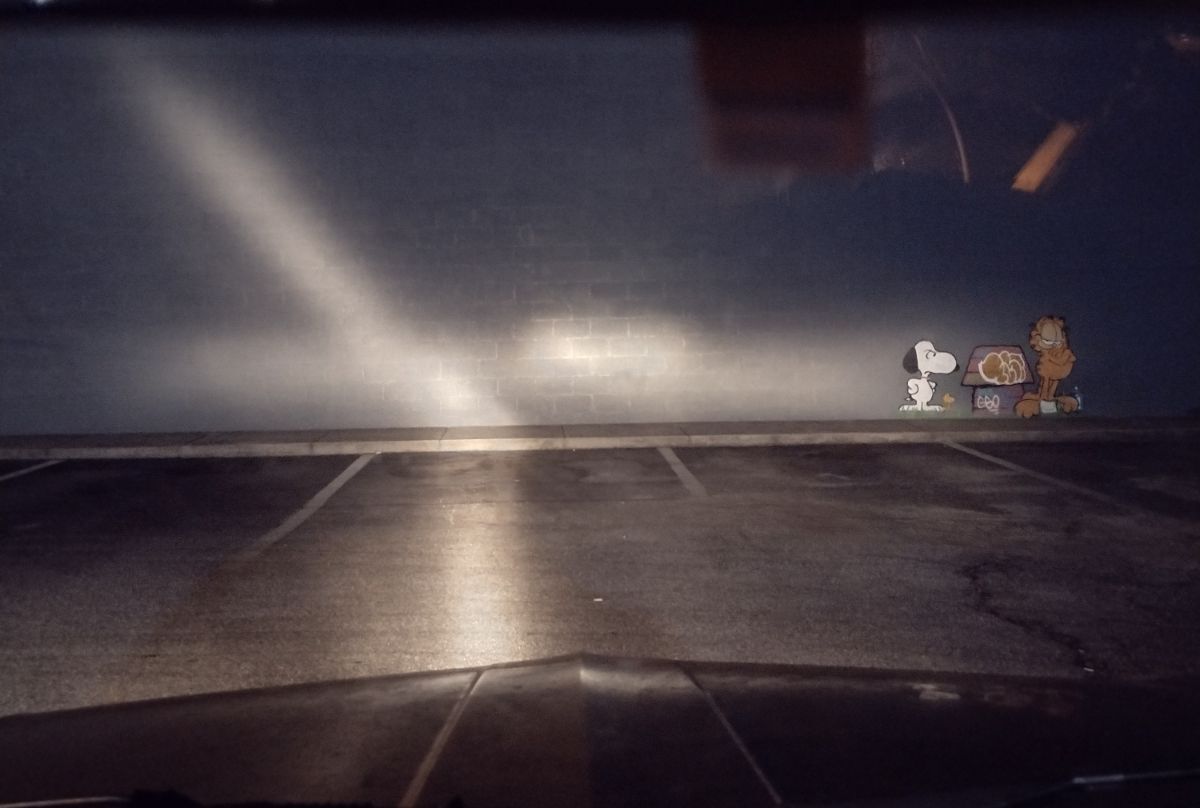

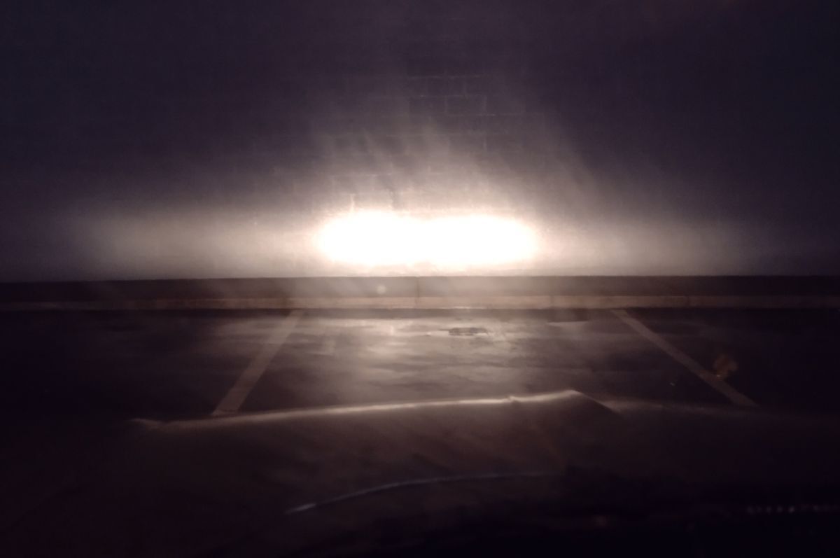

athoose Posted October 24, 2021 Report Share Posted October 24, 2021 I need to aim my headlights and can't find any threads on ratsun. Service manual offers a diagram but little explanation. 1. Should the passing low beam be aimed to the left or right? 2. Do the height and width measurements correspond to the most intense point of the beam or the edge of the beam? Thanks! Low, bulb is twisted, i think High Quote Link to comment
datzenmike Posted October 24, 2021 Report Share Posted October 24, 2021 Yup, one of the bulbs is turned in the housing. Quote Link to comment
athoose Posted October 26, 2021 Author Report Share Posted October 26, 2021 Bulb retaining ring welds had broke. Used two zip ties around the ring to hold in place while jb weld dried. Quote Link to comment
