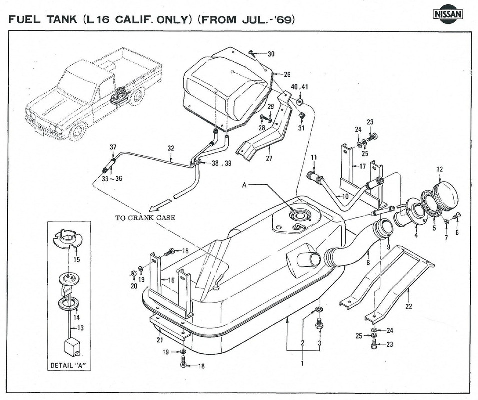

mnementh666 Posted September 5, 2021 Author Report Share Posted September 5, 2021 Well I pulled the sender from the tank... Eventually. What a pain. Anyway I think a new sender is in order, it was rusted/oxidized all to hell. The tank didn't look terrible, and was surprisingly empty. I guess I emptied the tank when I parked it. So that's cool. New plugs/cap/rotor, oil changed and coolant changed. Turned it over by hand a couple times, then spun it sans plugs for a while to get the oil and fuel flowing. Hooked it all up, and she started up! Sweet! Now I just gotta decide where to go from here. I think I will end up yanking the engine/trans and setting it aside. And start in on cleaning up the Mongolian cluster of wiring, and cleaning the engine bay. 2 Quote Link to comment
bilzbobaggins Posted September 6, 2021 Report Share Posted September 6, 2021 6 hours ago, mnementh666 said: Well I pulled the sender from the tank... Eventually. What a pain. Anyway I think a new sender is in order, it was rusted/oxidized all to hell. The tank didn't look terrible, and was surprisingly empty. I guess I emptied the tank when I parked it. So that's cool. New plugs/cap/rotor, oil changed and coolant changed. Turned it over by hand a couple times, then spun it sans plugs for a while to get the oil and fuel flowing. Hooked it all up, and she started up! Sweet! Now I just gotta decide where to go from here. I think I will end up yanking the engine/trans and setting it aside. And start in on cleaning up the Mongolian cluster of wiring, and cleaning the engine bay. If you buy a sending unit, let me know which one you get please. There are a lot on ebay and amazon that claim they will fit but folks say they wont. Some say they do. I have never found a definitive answer to this. Would be swell to have a fuel gauge again. 2 Quote Link to comment
Crashtd420 Posted September 6, 2021 Report Share Posted September 6, 2021 5 hours ago, bilzbobaggins said: If you buy a sending unit, let me know which one you get please. There are a lot on ebay and amazon that claim they will fit but folks say they wont. Some say they do. I have never found a definitive answer to this. Would be swell to have a fuel gauge again. Second this comment.... I have not found a proper one either.. I got lucky and my old sender still worked.... Mostly it's the float arm that's wrong, the sender worked and you can bend the arm but that's a pain too.... I could only get empty or full to read correctly not both.... Quote Link to comment
Crashtd420 Posted September 6, 2021 Report Share Posted September 6, 2021 I actually think this one would work correctly, the arm looks proper to me but again I'm not 100% sure and I wasn't willing to spend the money on a guess.... the one difference I see which I dont thing would matter is the sender seems to have a vent attached.... https://www.ebay.com/itm/NOS-JAPAN-FUEL-GAUGE-TANK-SENDING-UNIT-For-DATSUN-521-PICKUP-TRUCK-/184455100243?mkcid=16&mkevt=1&_trksid=p2349624.m46890.l6249&mkrid=711-127632-2357-0 1 Quote Link to comment
Crashtd420 Posted September 6, 2021 Report Share Posted September 6, 2021 Dont buy ones that look like this ... they definitely dont fit properly... Quote Link to comment
mnementh666 Posted September 6, 2021 Author Report Share Posted September 6, 2021 3 hours ago, Crashtd420 said: I actually think this one would work correctly, the arm looks proper to me but again I'm not 100% sure and I wasn't willing to spend the money on a guess.... the one difference I see which I dont thing would matter is the sender seems to have a vent attached.... https://www.ebay.com/itm/NOS-JAPAN-FUEL-GAUGE-TANK-SENDING-UNIT-For-DATSUN-521-PICKUP-TRUCK-/184455100243?mkcid=16&mkevt=1&_trksid=p2349624.m46890.l6249&mkrid=711-127632-2357-0 So this looks pretty much exactly like the one I have currently. I'm not spending that much though, I think I'd rather try to fabricobble an aftermarket setup somehow. 3 hours ago, Crashtd420 said: Dont buy ones that look like this ... they definitely dont fit properly... I swear I just saw a service manual picture that showed this as an EVAP system sender, but now I'm not finding that picture. weird. Well, the instrument panel lights, turn signals, wipers, heater fan all have no power. Aftermarket gauges and headlights are working. Yay for electrical gremlins. Definitely time for a wiring redo. *sigh* Quote Link to comment
Crashtd420 Posted September 6, 2021 Report Share Posted September 6, 2021 It's always good to check the parts visually and compare vs trusting a website saying they fit.... Quote Link to comment
mnementh666 Posted September 6, 2021 Author Report Share Posted September 6, 2021 In case anyone is curious, or just for my own records... Sender: Float arm is approx 7.25" long. I didn't measure the float drop, but about 7 ⅞" from mount flange to bottom of tank. The sender hole in tank is about 1.615"/41mm dia. Lockring outer dia 2.78"/71mm Sender flange OD 2.56"/65mm It looks like adapting to SAE 5 bolt pattern might be feasible, and utilize whatever gauge to match sender ohms. 3 Quote Link to comment
Charlie69 Posted September 7, 2021 Report Share Posted September 7, 2021 The 521 is a 90 ohm gauge and sender that works on about 9 volts DC. On the back of the cluster is a small rectangular box that vibrates and drops the voltage to the temp and the fuel gauge to about 9 volts DC. The little silver boxes do go out so before you spen a bunch of time and money test the voltage going in and coming out. 1 1 Quote Link to comment
