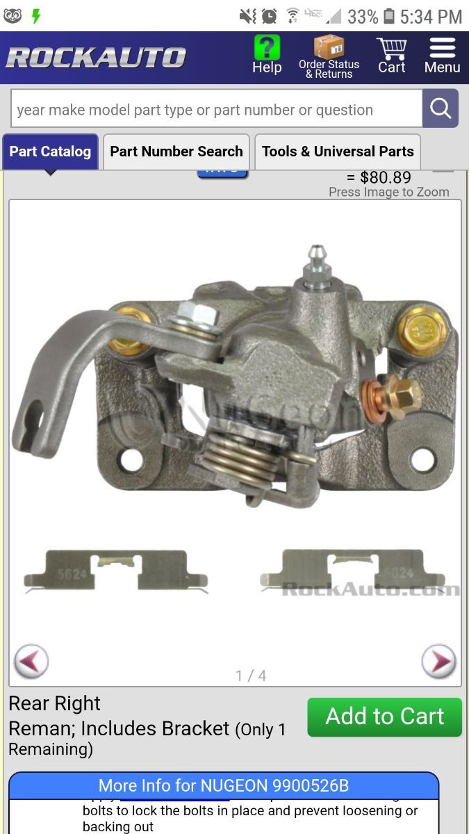

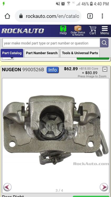

Crashtd420 Posted August 5, 2021 Report Share Posted August 5, 2021 This is just an opinion and guess ... I was bored and looked them up.... To me it looks like the caliper is the same but the bracket is different... I dont remember which is which but if you look at the bracket the bolt location is slightly different.... I dont think it would fit a premade bracket setup to use 86-87...... 1 Quote Link to comment

Crashtd420 Posted August 5, 2021 Report Share Posted August 5, 2021 From what Mike said I believe hes right that they will bolt up to the brackets.... I think the rotor will become the issue.... look at this view of the bolt pattern, not left to right but up and down..... The 87 calipers are the top ones in both my posts, the 88 seems closer to the center.... 1 Quote Link to comment
