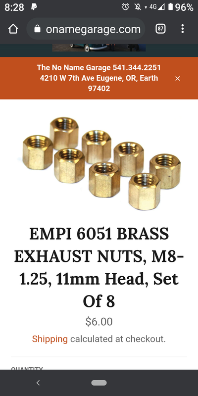

While looking for something else yesterday I came across one and remembered where it was. (always that way, finding what you aren't looking for) Looks like brass. Bronze is redder/brown. Stainless will turn a straw yellow when heated to 600F +

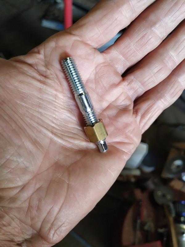

Dorman also sells a steel stud and brass nut manifold set at auto parts stores like Oreillys.  I think it is listed as "VW" but the important factor is that it has the correct thread which I think is M8.  At least, that is what I used on my Z24 engine.  I realize that this could be different for an L series.
  • Like 1

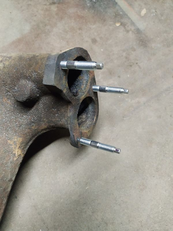

Thank I got some 10mm but they where to big so my next was to get 8mm. Thank you all for the help I will post the results later.
